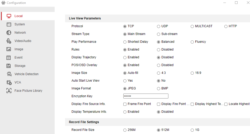

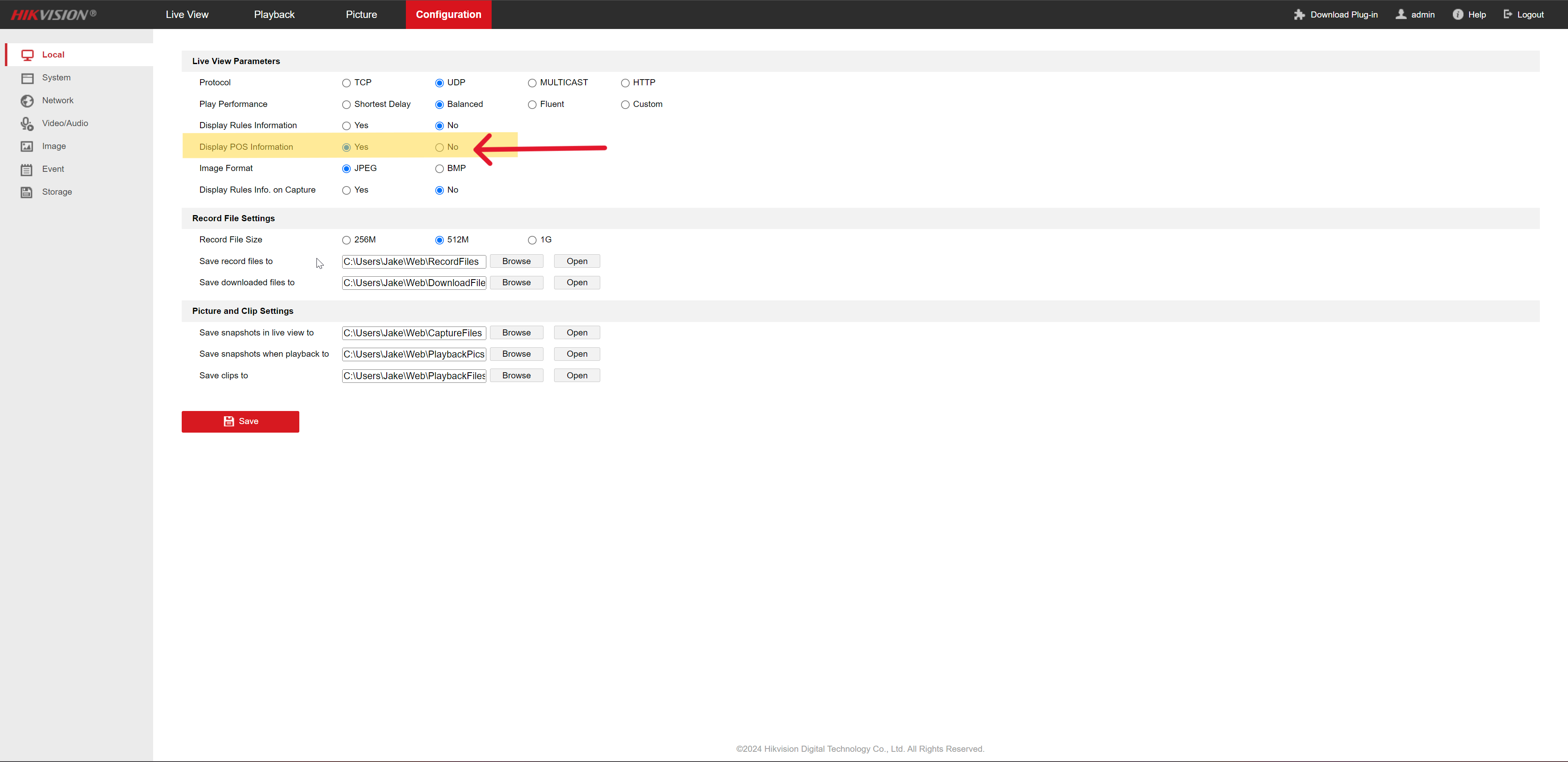

For this issue, could I get you to check whether you have the below setting set to 'disabled' or 'no', if not does the code disappear after disabling this, please?
You can find this setting by selecting the Local Tab when in Configuration in a web browser.
This is how it is set in the previous version V5.7.14 build 231028. Maybe it should have been unchecked after the upgrade?

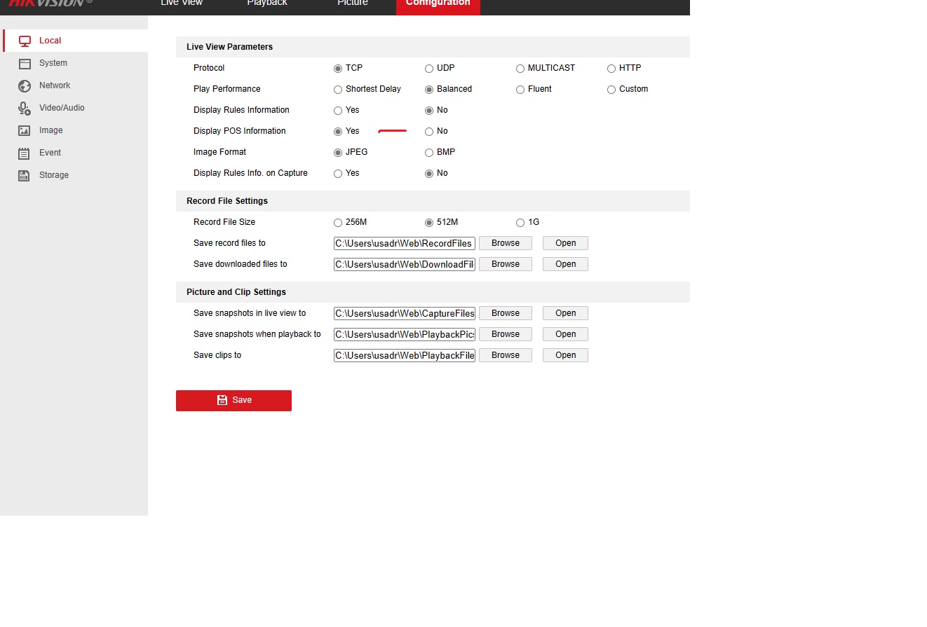

I suppose same thing must be done for the NVR?
Sorry. No fix with that POS option on both, Camera and NVR. Strange code continues following target on Smart detection.....

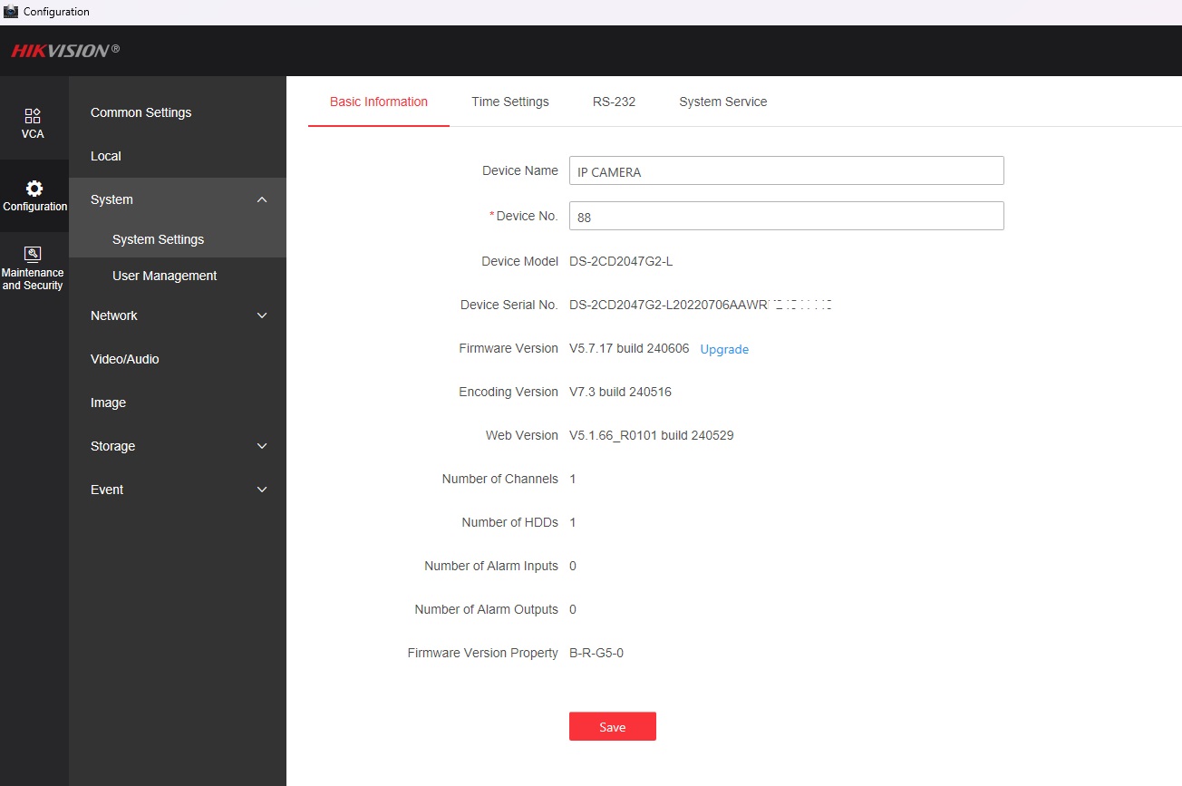

Yesterday, I installed version V5.7.17 build 240606, and to prevent those codes from appearing when there was movement in its area, I unchecked "Enable Dynamic Analysis for face detection". It seems to be working well. I also tested the area where I set to receive notifications only for human presence, and it works: I receive notifications when a person enters the preset area. I also like the new interface in the new firmware.

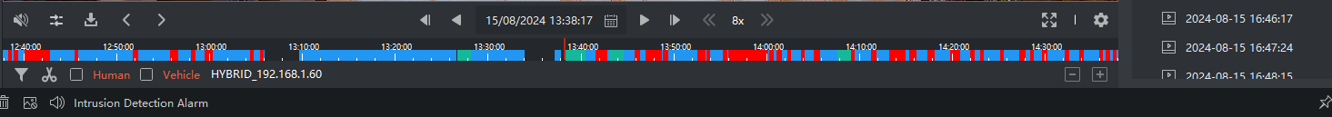

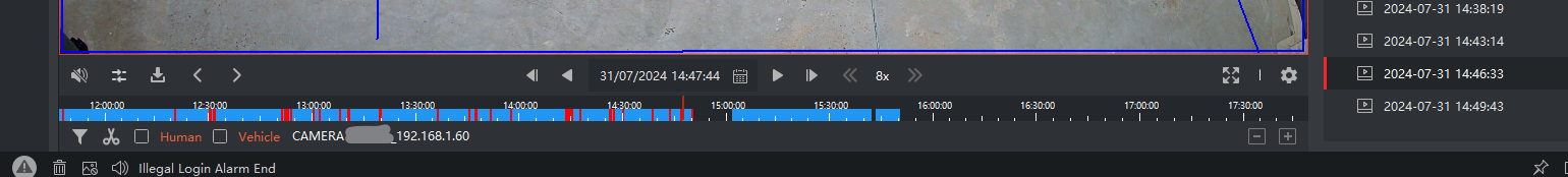

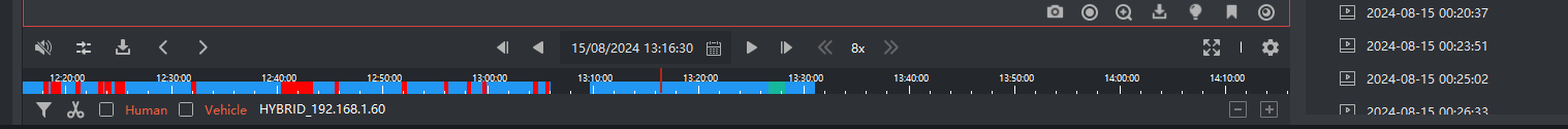

This is my Motion Detection VCA search after installing v5.7.17
Until 14:50 on timeline is v5.7.15 and from 15:00 and afterwards this is v5.7.17. No VCA search events at all.

It doesn't seem to work on my M series NVR:
More > Dual VCA > Enable Motion (in either Normal or Event Playback). Drawing a box and searching gives no results

For both of them there are once again no results in By Rules Motion Search on my DS-7608NXI-K2(drawing search grid boxes).
Everything else works fine and also all motion events that are recorded as separate clips, found on search NVR tab, previously set so in Settings by selecting Notify Surveillance Center and upload to SD card.
Intelligent option is enabled for both of them too.
Had an issue that caused an hour of mess, which was an not at all VCA mode enabled(was disabled) and by enabling by mistake the By NVR option then the NVR was stuck. Has never been stuck before. So powered OFF(by switch), reboot, then everything seemed OK but could not access Settings for one of the cameras by iVMS4200 or by Hitoolsdelivery. The only way to access settings was the Batch Configuration tool so with that I went back to 5.7.15, where everything is fine again.
Possibly, the reason for By Rules Motion search VCA issue, is the Intelligent Search enabling. This does not want VCA by NVR enabled and possibly this does not want Motion VCA search by Rules.
