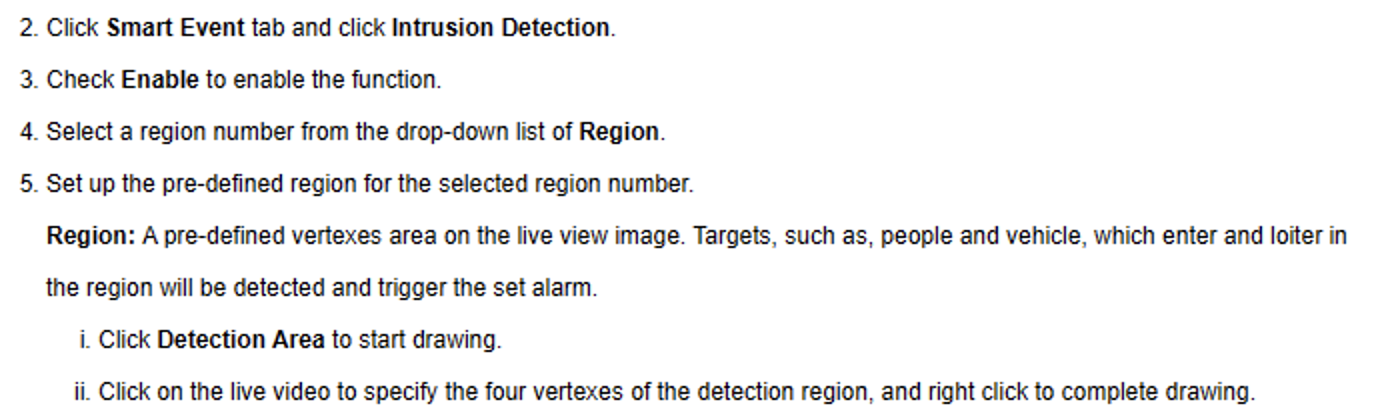

The help file associated with both my M series NVR and the G5 camera both indicate that for intrusion detection you're limited to a four sided polygon (not 10 as is allowed for motion detection)
M Series:
G5 Camera:

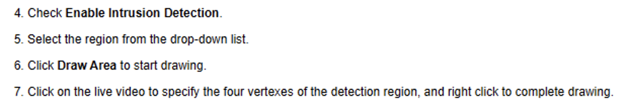

Both indicate 'click on the live video to specify the four vertexes of the detection region'
Yes I know JB. Same thing for DS-7608NXI K series

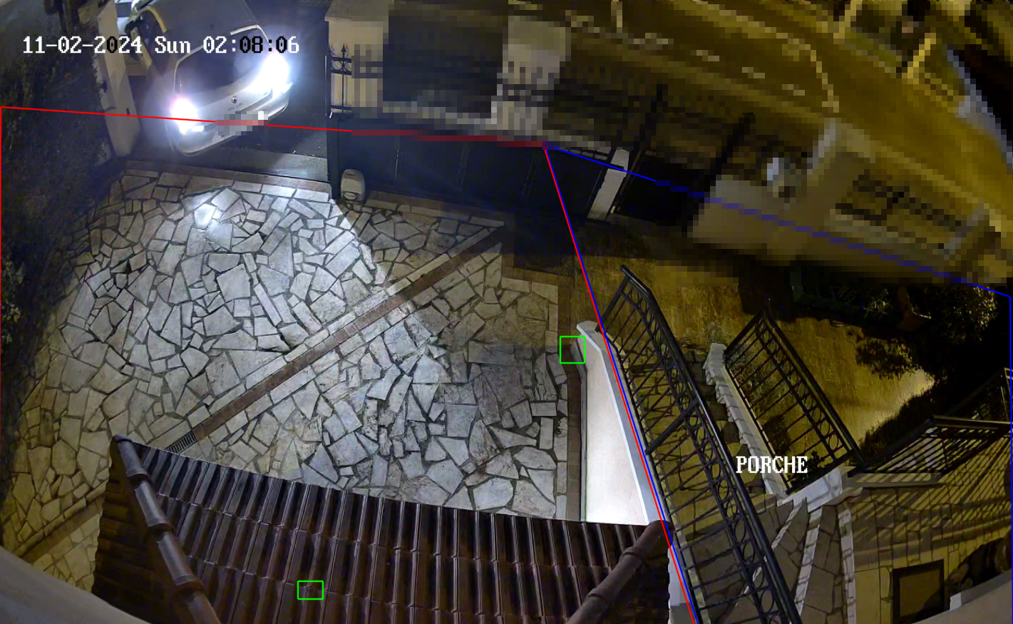

With the new settings, i get no notification at all, for ex this night at 2:07AM the car entered the area with lights, the area turned red but i did not get the notification on the app. (basic event/motion detection recorded the event)
Settings:
From smart event/ intrusion detection with human and vehicule unchecked, sensivity 100 and thresold 0 . I've redrawn min size and max size (as on the screenshot). The max size has to be that big because i've seen that the shadow of someone walking in the area is also taken on the analysis.
I've also configured basic event / motion detection with sensitivity at night = 50 and i get 100% records on the hikconnect app. I haven't enable notification as i would get a lot of false positive. Every car passing on the street with lights get trigger by motion detection as the light is moving inside the area, reflects on the walls, car, etc..
I'm not sure if i'm doing something wrong, should i check again human/car ?
All settings were done on the camera (not on the NVR)

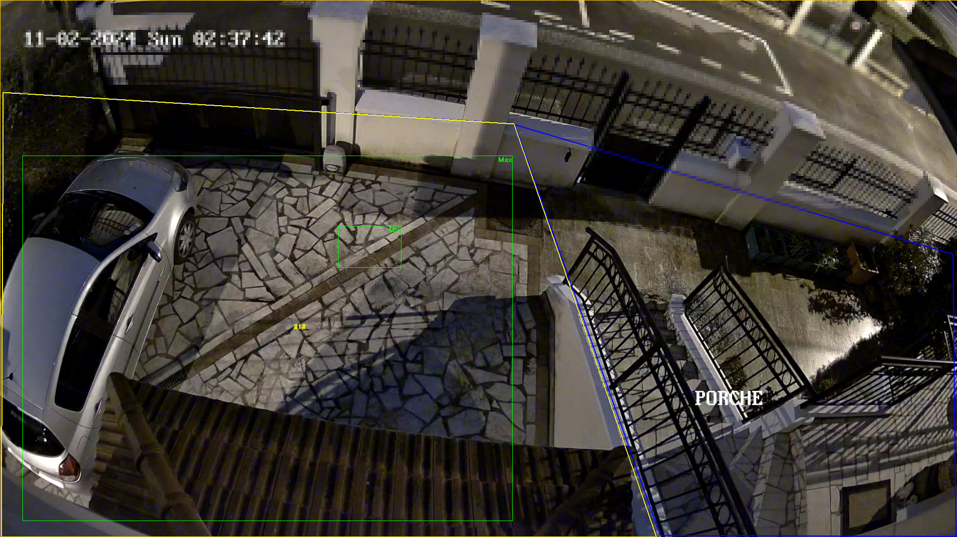

Hi Martel
No I believe there is nothing wrong with your settings. Checking Human and/or Vehicle does not change anything.
I have the same settings and have also Motion detection enabled, because as you also mention, this is 100% reliable and I feel safe.
I have the same issues with Smart Events and I cannot solve them. All kind of smart events.
- Targets are Detected, Observed, Recognized, Identified, there are green moving rectangles and red done regions set for event alarms, but some times, not always, there is no alarm and there is no VCA record at all. No VCA record possibly means that ColorVu did not sent the VCA to NVR or the NVR did not accept the VCA event or for some reason could not record on the disks.
- Some other times, a large target(human) is not smart detected at all, but a cat or a bird is detected in same region. This usually happens if target moves from far to near or near to far on a straight line, in the middle(about 60%) to lower part of camera view(closest to camera). On the other hand, the slightest movement, left to right or right to left, detects target and gives alarm or is simply recorded as VCA. To explain better. For example your car is always detected when moving on the road left to right or close to far, but is not detected(or detected very few times) when entering your yard(70% to 0%) moving far to near. It would be always detected though, if the car could be moving left to right or right to left inside your yard.
I have tried reducing Resolution, bitrates, video quality, enabled-disabled ROI area, calibrated with the NVR way, but there is not difference. What is common for both of us? The position(placement) of the camera and the ColorVu DS-2x47G2x with DS-7608NXI-K2. The height placement is different(mine is about 2.7m) but seems it does not change anything.
Maybe the issues concern some models of the colorVus with lower resolutions(2 and 4 mpixel)? Maybe a not full compatibility of ColorVus with new Acusense K series NVR?
I cannot solve and I quit.

Attached screenshot, this is exactly what you are describing, the region is triggered (red) but send no notification.
What are our option ?? How i'm supposed to get notification if some thieves are visiting us at night?
