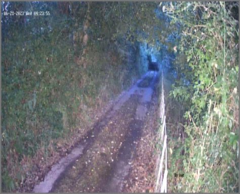

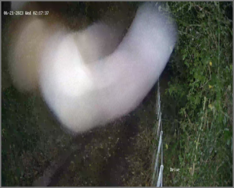

Attached photos show two images at night, one when insects are crowding the lens, the other when not. Image of area settings also attached.

Although it's working during the day, I would start by adjusting/enlarging the configured area. From the camera's perspective, if you were to stand at the left edge of the drive, only your feet would actually be inside that coverage shape; your body would appear to be over the adjacent hedge. Get someone to stand in the lower left of your image adjacent the hedge so that they're in view and then redraw the polygon. The left side of it should be above their head on the hedge rather than where it currently is. That alone should improve the detection.

I can fiddle with the shape but it’s not detecting/notifying vehicles that drive right through the middle from beginning to end.
Looking at the view of that camera, rather than draw a shape, just set the detection area as full screen temporarily to prove the point. It shouldn't cause any false alerts.

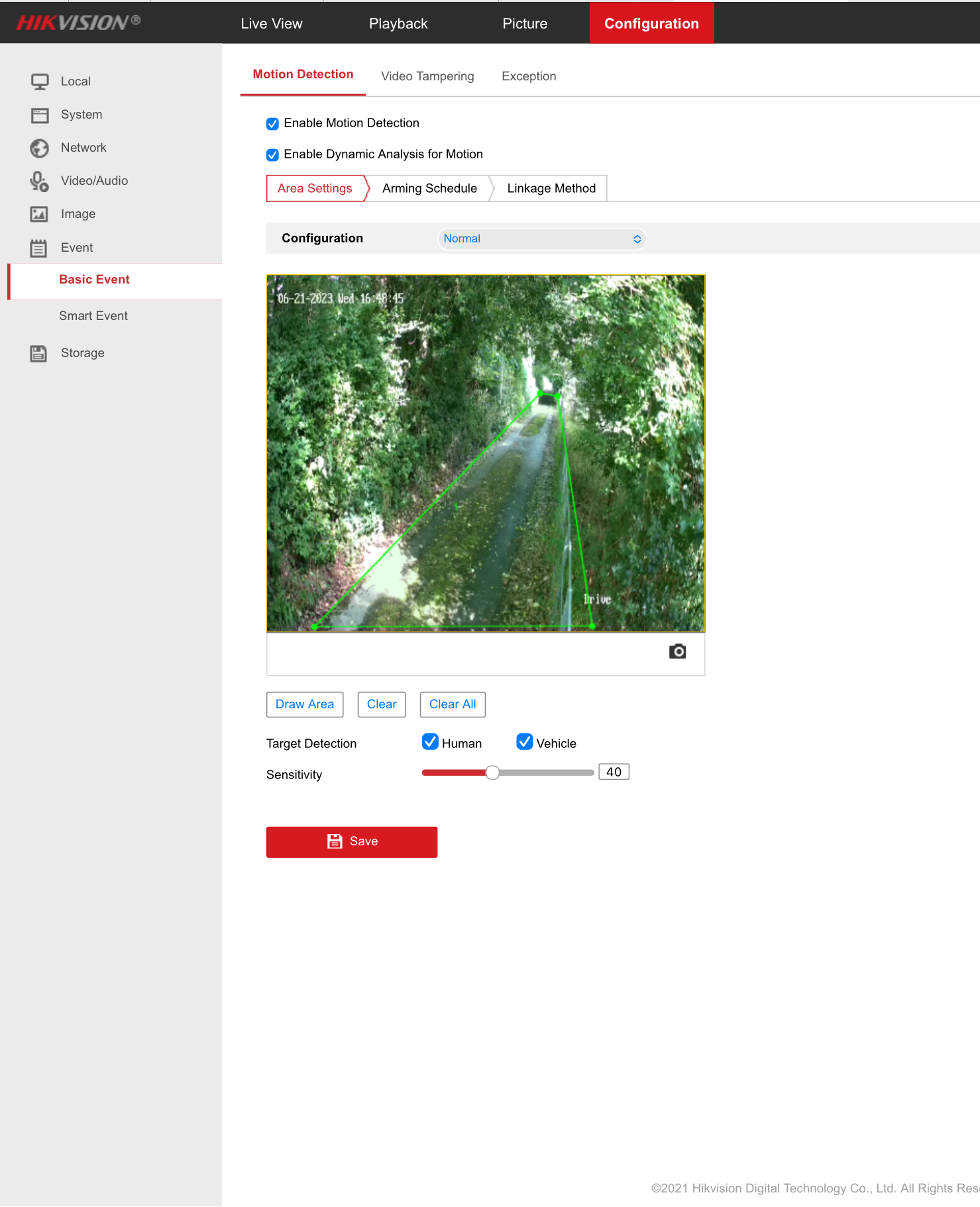

Yes, on the cameras that weren't giving notifications at night, I set up motion detection on 20 or 40 sensitivity and unticked human and vehicle targets. I now get all notifications, although I do get cats and lights setting it off too, so there are more false alarms but I don't miss anything. I think I tried intrusion detection with human and vehicle targets unticked and I was getting even more false alarms. It works ok on motion detection for me.

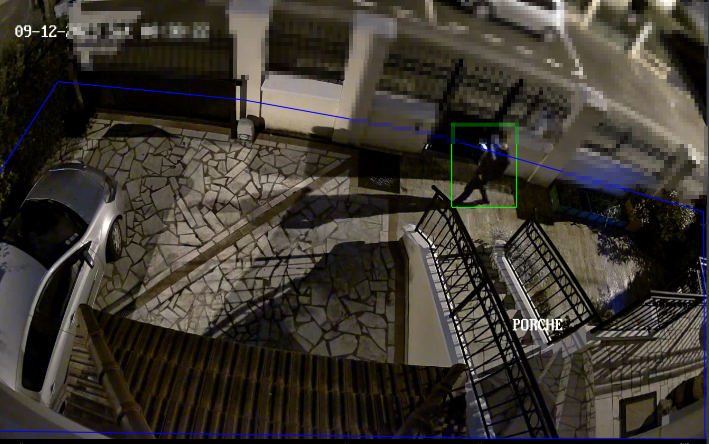

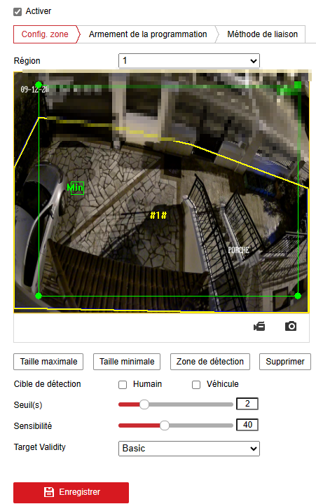

No matter i tick/untick human/veh or adjust sensibility from 20 to 70 seems the acusense aint working at night
When i try to enter the area, i get scanned by there is no detection from the camera

Hi Martel
We all have similar issues with ColorVu cameras.
In a previous post I included a Link of an expert Dave from DVSLTD that shows almost the same thing for new Hybrid cameras. The delay between Detect and Alarm pop-up or Pre-Record on the NVR. But as I can see your lighting and target entering the region are OK . The target also gets 100% inside the region area.
Seems that for both issues, alarm pop-up delay and pre-record delay on NVR, the problem is the ColorVUs.
About your Smart Event:
-Is this an Intrusion Detection Area or a Region Entrance area? Region Entrance, at least for me, has a double possibility NOT to give an Alarm pop up even though there is no setting for Threshold time and this should be INSTANT.
-Try reducing the target size so that it fits inside your region area size.
-I use now only Intrusion Detection, Human and Vehicle unchecked, Thresholds at 0 sec, Sensitivity 100 and Target Validity Basic.
I do have a better result but I also have a small delay of 3-5 seconds and some times the target has gone, detected(green rectangle) but not recognized(making red the region area) so that to give an alarm or record on NVR.
My settings should be similar to Motion Detection that gives instant alarm, but it does not.

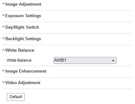

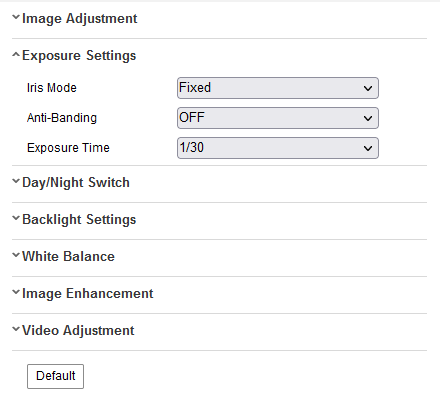

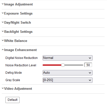

I've setup all display settings from the camera, should i do it from the NVR?
(Ive posted screenshot attached)

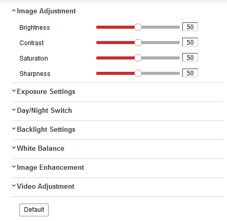

Image adjusment all 50
Exposure Settings
Iris mode Fixed
Anti-binding = OFF
Exposure Time = 1/30

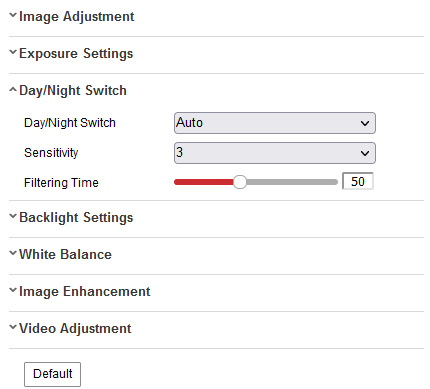

Day/night switch = Auto
Sensitivity = 3
Filtering time = 50

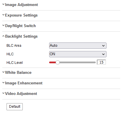

Blacklight settings
BLC area = automatically
HLC = On
HLC lvl = 15
White Balance = AWB1
Image Enhacement
Digital Noise reduction = Normal
Noise Reduction lvl = 50
Defog mode = Auto
Gray scale = [0-255]

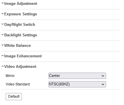

Video adjustment
Mirror = center
Video Standard = NTSC(60HZ)
I've draw the area from the intrusion detection (SMD events) setting on the NVR (windows 11 + edge + latest plugin) -> For exemple from the NVR i can't put in full screen mod to draw whereas on the camera i can. (Region entrance isnt activated)
I'll try, but i want it to detect car and humans
