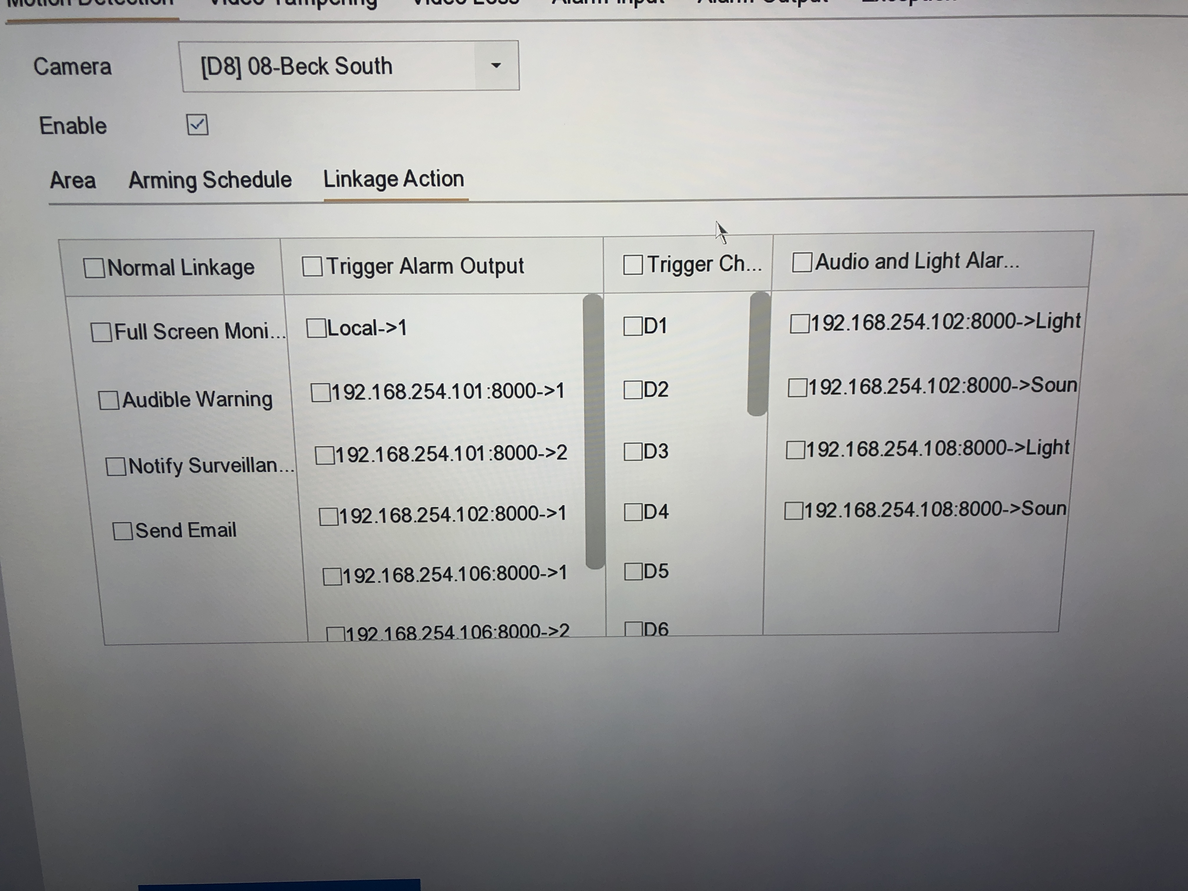

1.) Im still getting some really odd results in terms of notifications not working as they should. Within linkage method the "audible warning" - am i correct that this is for the NVR making a noise? Or is it for the camera making the audio alarm? Whats the general method i should be following of when to set up an event in the camera, vs on the NVR, vs via the web login?

1- Yes the audible warning under Linkage Action > Normal Linkage is just the beep from the NVR itself. On the same page of the menu there is a Audio and Light Alarm Linkage which should list and have a checkbox for any supported cameras. I've attached an image from my NVR which shows there are two cameras. You can fire the audible and visible alarm separately fro an event on any camera. I prefer to set up first from the NVR local login but you could use the NVR webpage just the same. I advise only to set up items directly in the camera webpage that cannot be set in the NVR webpage (such as the arming schedule that the light and/or sound is available)

Not a huge issue but one out of curiosity - for the flashing alarm and audible output.... What events are they linked to? I.e. when i go into the camera settings direct and choose an arming schedule for them, what events need to be triggered for the alarm / flashing light to be active? e.g. line crossing, intrusion? or presumably any/all events? Main reason for me asking is that occasionally one of my cameras will speak not flash whereas all my other cameras speak and flash so didnt know if id missed a setting somewhere.
The arming schedules for the flashing light and alarm are set in the camera. I've just had a look and you can actually set them via the NVR if you're logged in via the web browser. They have they're own individual schedules and those schedules will determine when it is possible for a linked alarm to trigger them. The schedules don't have to be altered but by default both would be set to 24/7. Each event itself can also be configured with an arming schedule.
Any event can be set to trigger the light and/or the audible alert. That is set under Event > Linkage Method > Audio and Light Alarm Linkage. So you should be able to configure it exactly as you want.
