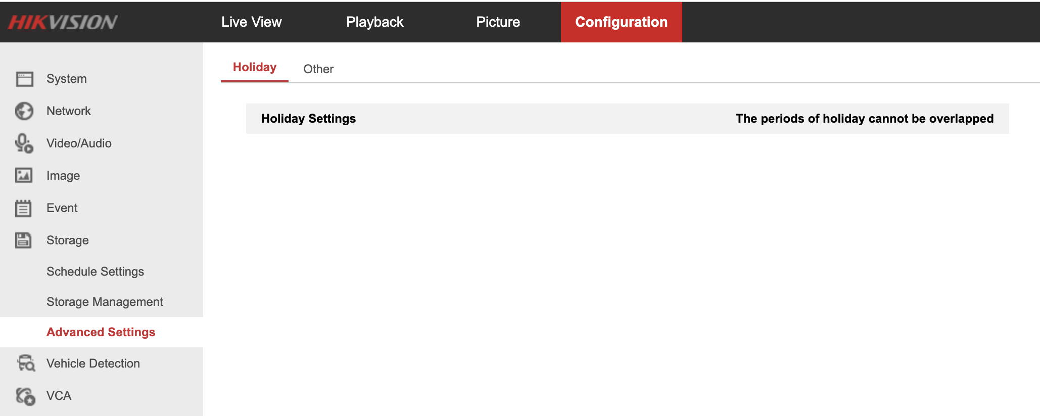

On a DS7616NI-K2/16P running V4.74.210 build 240108 the table is missing:

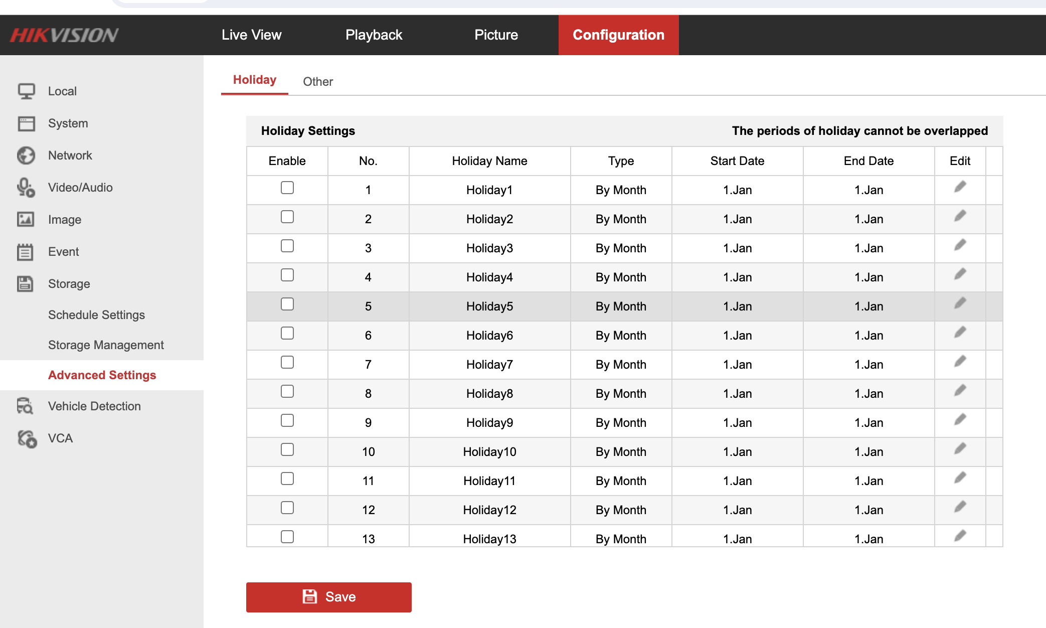

Whereas on a far older DS7608NI-E2/8P running V3.4.106 build 230316 the page is complete with the table for editing the schedules:
Thanks for the pics, and it shows I don't understand something. I DO have the page in your last picture. When I click "edit" it give me the opportunity name the holiday and set the dates. What I don't understand is *where* I set the arming schedule for the holiday.
So a simple example, for Camera 1 I have intrusion/line crossing set for 10pm through 7am only. For the holiday schedule I want to set intrusion/line crossing to 24/7 while I'm gone. Where do I set that new "holiday" schedule for Camera 1? Under smart events I do not see anywhere to set the alternate, "holiday" arming schedule so that when I enable it in the pic above, it overrides my normal settings. Any help is appreciated.
