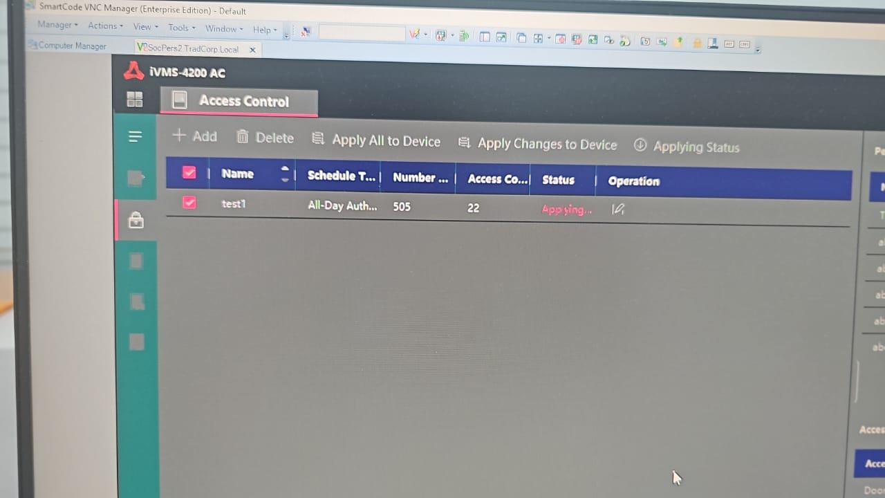

i have around 25 Hikvision DS-K1T341CMF - Face Recognition Terminals connected to an IVMS 4200-AC (all have latest firmware)
I have created an access group and joined all together to have all the employee credentials (photo and fingerprint) on all devices

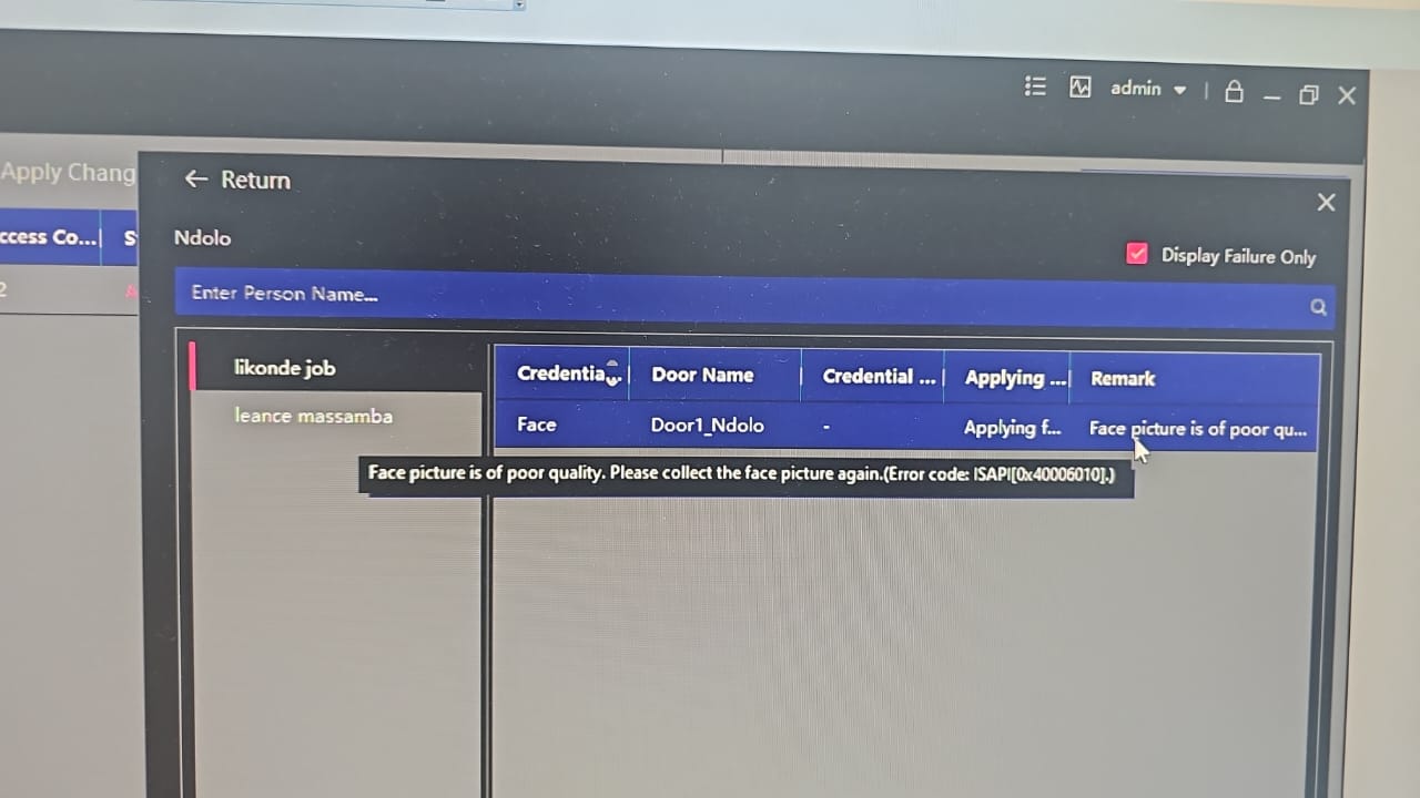

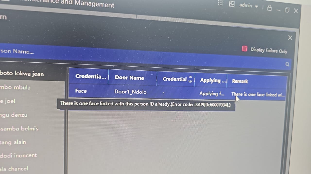

It is working good except for few devices where i am getting these errors ( and hikvision support is not replying at anything )
What should i try to verify?! i have tried lowered the quality acceptance of the photo but in vain
also i can see i have 500 persons but 1200 fingerprint ( only 1 fingerprint per person !) - i don't know how to check these fingerprints?

It could be you have multiple organizations and that user already exists in first, and you are sending both to device.
You said you are getting on just few devices that error, that's because that particular user have permissions just on those particular devices.
Poor image quality: Problem can occur when background is too detailed, it has to be either grey/white wall and nothing behind when enrolling image. User has to be approx 60cm from device and it has to capture face and shoulders.
