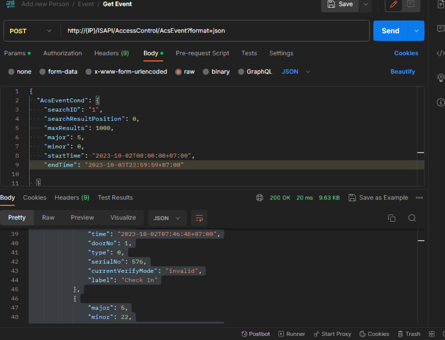

I am trying to test my attendance device of hikvision.
Model: DS-K1T341AMF
I want to get event which show the list of event that have a check in and check out event here is the sample response:
"AcsEvent": {
"searchID": "1",
"totalMatches": 72,
"responseStatusStrg": "MORE",
"numOfMatches": 30,
"InfoList": [
"major": 5,
"minor": 22,
"time": "2023-10-02T07:46:40+07:00",
"doorNo": 1,
"type": 0,
"serialNo": 574,
"currentVerifyMode": "invalid"
"major": 5,
"minor": 75,
"time": "2023-10-02T07:46:48+07:00",
"cardType": 1,
"name": "test schedule",
"cardReaderNo": 1,
"doorNo": 1,
"employeeNoString": "99",
"type": 0,
"serialNo": 575,
"userType": "normal",
"currentVerifyMode": "cardOrFaceOrFp",
"attendanceStatus": "checkIn",
"label": "Check In",
"mask": "no",
"pictureURL": "URL",
"picturesNumber": 1
"major": 5,
"minor": 21,
"doorNo": 1,
"type": 0,
"serialNo": 576,
"currentVerifyMode": "invalid",
"label": "Check In"
"major": 5,
"minor": 22,
"time": "2023-10-02T07:46:53+07:00",
"doorNo": 1,
"type": 0,
"serialNo": 577,
"label": "Check In"
here is the request json form:
"AcsEventCond": {
"searchID": "1",
"searchResultPosition": 0,
"maxResults": 1000,
"major": 5,
"minor": 0,
"startTime": "2023-10-02T00:00:00+07:00",
"endTime": "2023-10-03T23:59:59+07:00"
reference :
I'd like to know how to filter the get access event which shows only event list that only valid authenticated check in and check out with fingerprint and face recognition?
filter by major :5 , minor : 75
This is only authenticated user
