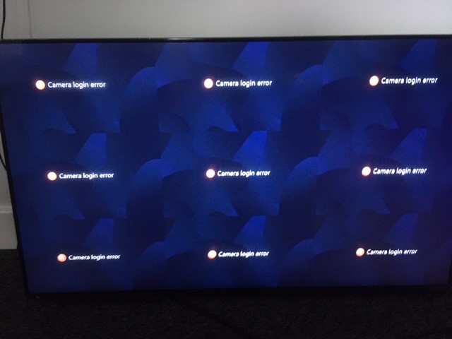

I'm trying to display multiscreen images over 8 x HDMI outputs from a 6908UDI decoder, I can see all 3 of my NVR's on the network and the decoder itself.
My NVR's are 9632NI, 7608NI & 7604NI
I have set up the decoder via the web browser as per User Manual but am getting "Camera login error's" on my screens.
Any thoughts and advice would be greatly appreciated
Tony

Sorry for the slow response, have you made any progress with this?
Unfortunately not yet, I'm back on site on Friday 14th Oct so will have another play while I'm there

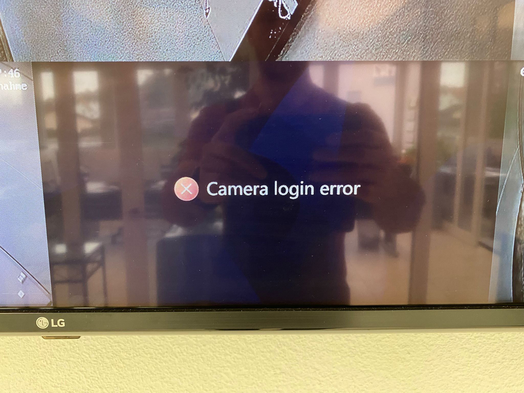

Hello, what was the problem? I have this annoying problem myself. The configuration is exactly the same like with other cameras which are working.

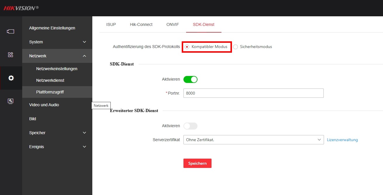

Because there is nothing worse than an unanswered forum thread, here is my solution to this sh*tty problem.
Our setup:
- camera: Hikvision DS-2CD2087G2H-LIU/SL
- decoder: DS-6901UDI
Our solution was to set "compatibility mode" under "SDK-Service" at the platform access settings on the camera, check out the attachment.
