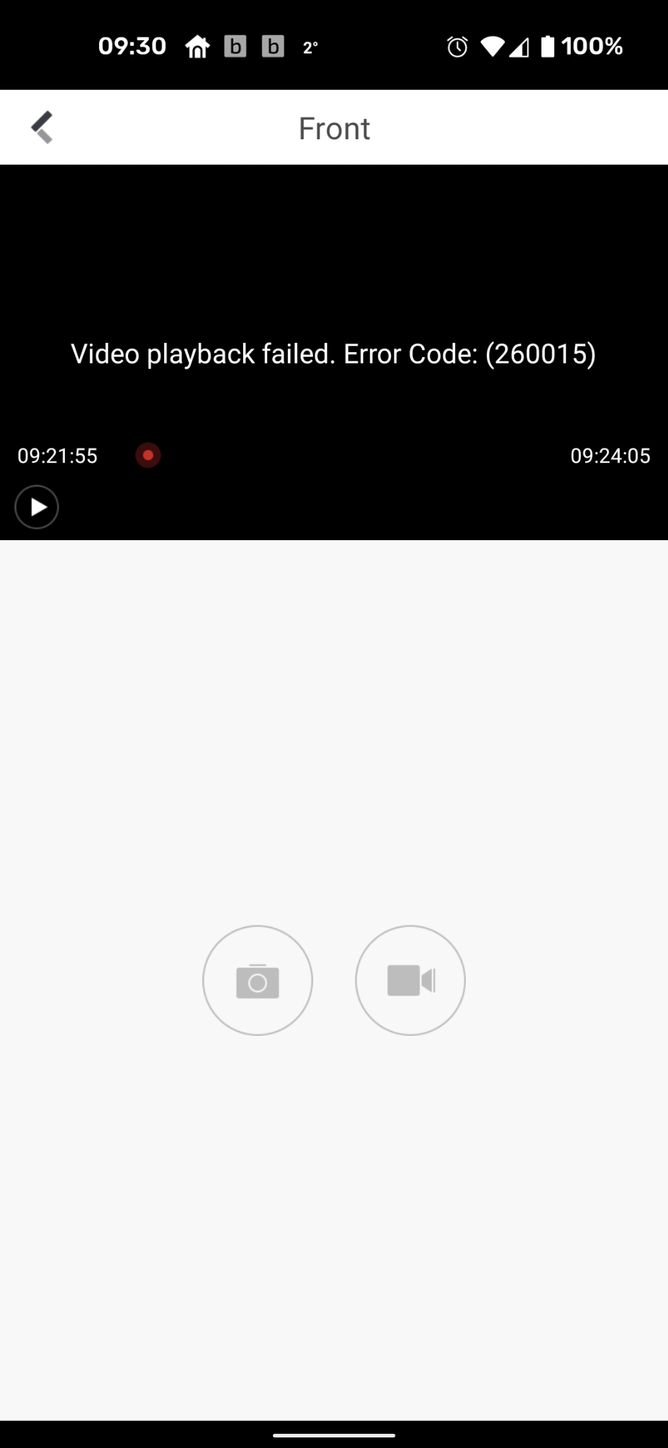

hi All,
Just purchased a hikvision DS-2CD2347G2-LU 4 MP ColorVu Fixed Turret Network Camera. I have it setup for notifications sent to the Hikconnect v4.11.0.1204 Android and i`m receiving them fine and it displays an image on my phone notifications, but when i press the option to play it goes to about 80-90% and then just stops and eventually i get a fail message , see screenshot attached.
The playback works if just run play on the camera via hikconnect , just the notification fails.
The only thing i can think is that when i originally tried it with the app it was working, and i`ve since been tweaking it over the week and updated the firmware of the camera. Could it be that at all? If so could i regress firmware version to the original to check. Unless there is something else it could be.
Just to add that it seems to be effected depending on time of day. For example at night i can play videos but then i check that after 8.20am today i suddenly couldnt play back any notifications or recording. I checked if there were any schedules that change at these times but nothing obvious.
