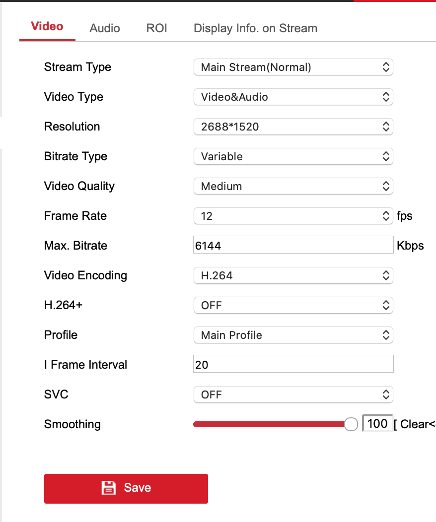

When I do Hik-connect liveview/playback on my local network the playback is good as expected.
But when I do Hik-connect liveview/playback remotely the cameras take long to load and the liveview/playback is slow and skipping seconds.
I've reduced the quality of the video from high to medium and the FPS to 12 from 20 but still having remote playback issues.
I have 8 cameras with identical settings:
How can I improve remote liveview/playback?
Why is it working fine on local network but having problems when connected remotely?
Do I need to set up sub streams for remote viewing?
