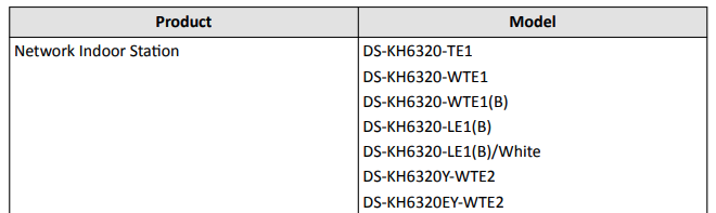

Well, 6320 has looot of versions :)
6320-WTE1 is all the same like 6320-TE1. Only difference is that WiFI module JB1970 said. Both of them works with KD8003-IME1.

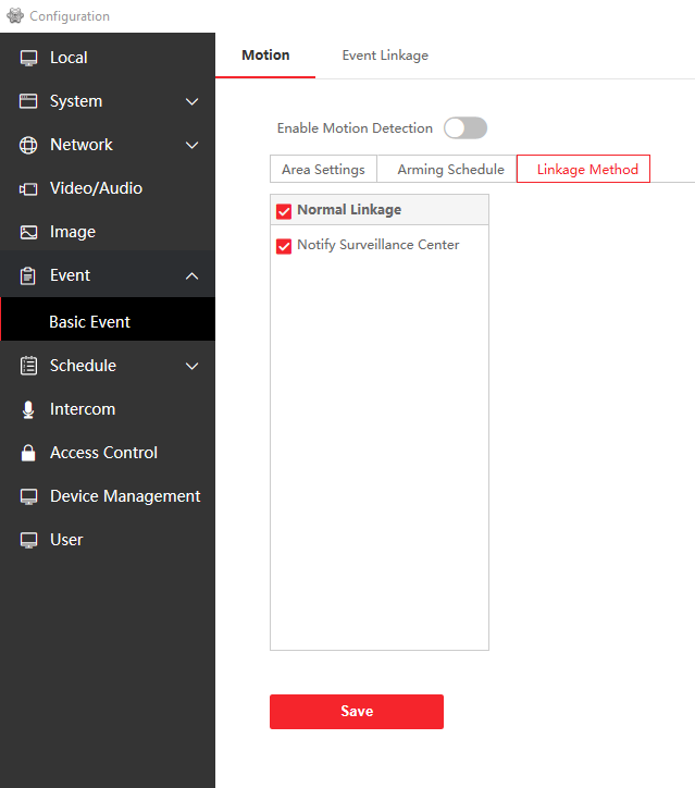

Just go to the units IP address in a web browser and log into it and go to Configuration > Basic Event to switch it on and set up. Unfortunately it's only standard motion detection (no AcuSense) so you'll probably get a lot of nuisance activations.

I adjust it in the ip address, but it's not working, I enable the motion detection and set schedule, but there is no alert.

You won't see motion detection event from outdoor unit on your phone. You could see it if you are running IVMS, but not trought your mobile app.

Is Notify center on?

the notify center is on and I schedule the event when to work
enable hik-connect on outdoor unit and add it to hik-connect. Then see if you will recieve it.
