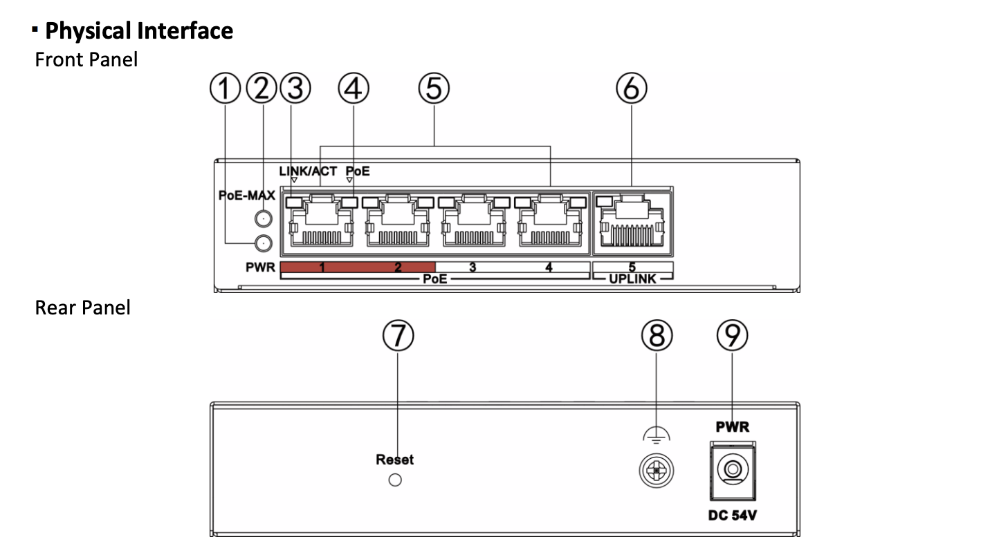

The datasheet for this PoE switch has a diagram that shows there should be a hole in the back of the switch to access the reset button, see below:
Thanks, and now I must remember to double-check that in the future! Unfortunately, this one doesn't have such a reset button (nor hole in the case).

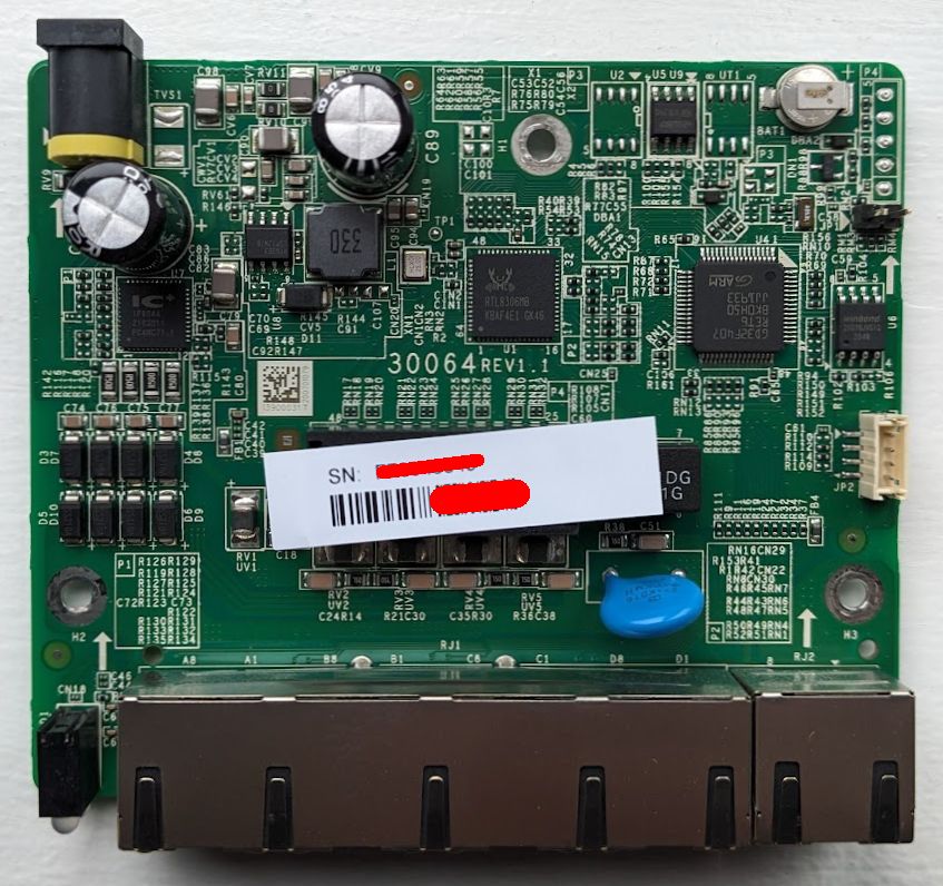

That looks like a button cell top-right on the pcb, with the power OFF you could try removing that and leaving it for say 10mins before replacing it and powering the switch ON again.
My hunch would be that without the battery it'll forget any custom settings and revert to default ...
Yes, a back-up battery with bonded tags. I did give it a brief short but not enough, everything remained. I didn't want to kill the little soul with a full-on 10s short. Looks like I'll be doing soldering iron surgery on it and get it disconnected fully.
- I was so hopeful that the JP1 would come into play (like power-up with it linked etc.).
Well that wasn't so successful.
I lifted one terminal of said battery, ensured was fully clear of the pad and solder below and waited a full ten minutes (it was more in the end). Reconnected in one clean move, soldered. All stable.
Put the switch back into position, it has three test cameras on it. All fired up after the usual delays.
Exactly the same. The switch has helped it self to a fixed IP where it's not really wanted (checked of my router's dchp log, shows no request from that mac address today).
iVMS-4200 says it is there but a 'device' not a switch like the others and id/password fails to gain access. Says it is off-line with a 'Risky' password but try to change anything and the lockup countdown has begun.
Back to the beginning.
