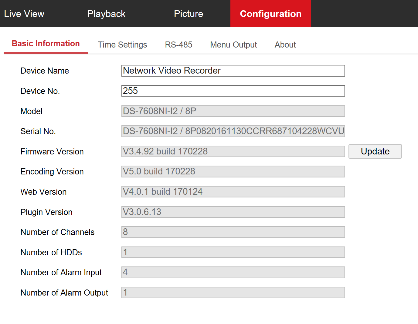

Hello. If anyone could help it would be greatly appreciated. I have a Hik vision system and I am looking to upgrade the firmware to the last released version. As my system is a few years old, I would imagine Hik Vision stopped supporting the NVR I have but I would not mind having the latest or last firmware update they released. I have looked around on the internet but to be honest I am confusing myself with the amount of info that's available. If anyone could point me in the right direction I would be most grateful. I have added a screen shot of my firmware which I hope will assist someone better qualified than me. Many thanks in advance. :)

We can guide you towards the correct firmware, Hikvision firmware files can be confusing.
The v3.4.92 firmware you are currently running is very old (was released in 2017) and so we would definitely recommend updating, as you are so far behind it is advised that you update through several different versions and don't just jump to the latest version. See all the versions between your current firmware and the latest here at the Hikvision Download Portal
below are versions we would update through:
V4.1.10 build171107
V4.1.60 build180717
V4.22.005 build191208
V4.40.017 build 201124
V4.51.025 build210927
V4.60.005 build220108
If you've never updated your firmware you can find the instructions in the below thread:
Due to the old firmware you are currently running, you will likely have to access the NVR with internet explorer to update the first few firmware versions as modern browsers like Chrome/Firefox removed support for the plugin used by the older Hikvision firmware.
Hi Dan. I can't thank you enough for your help. I have just started downloading the updates and will do as suggested by following the build list you've provided. I will no doubt be back here again within a day or two, even if it's just to update you on the final update. Thanks for your help, hopefully things run smoothly :)

Hi Dan. Sorry this is a little late coming but I just wanted to thank you for your assistance. My NVR is now fully updated to the latest firmware version and I am happy to report that it's all working really well. I like to new GUI screen and the functions that provides. Do you happen to know where I can down load a set of comprehensive instruction manual from. I have looked on line but can only find basic manuals, most of which I already know. I am looking at something that will go into a lot more detail. Any help would again be appreciated. Many thanks. :)

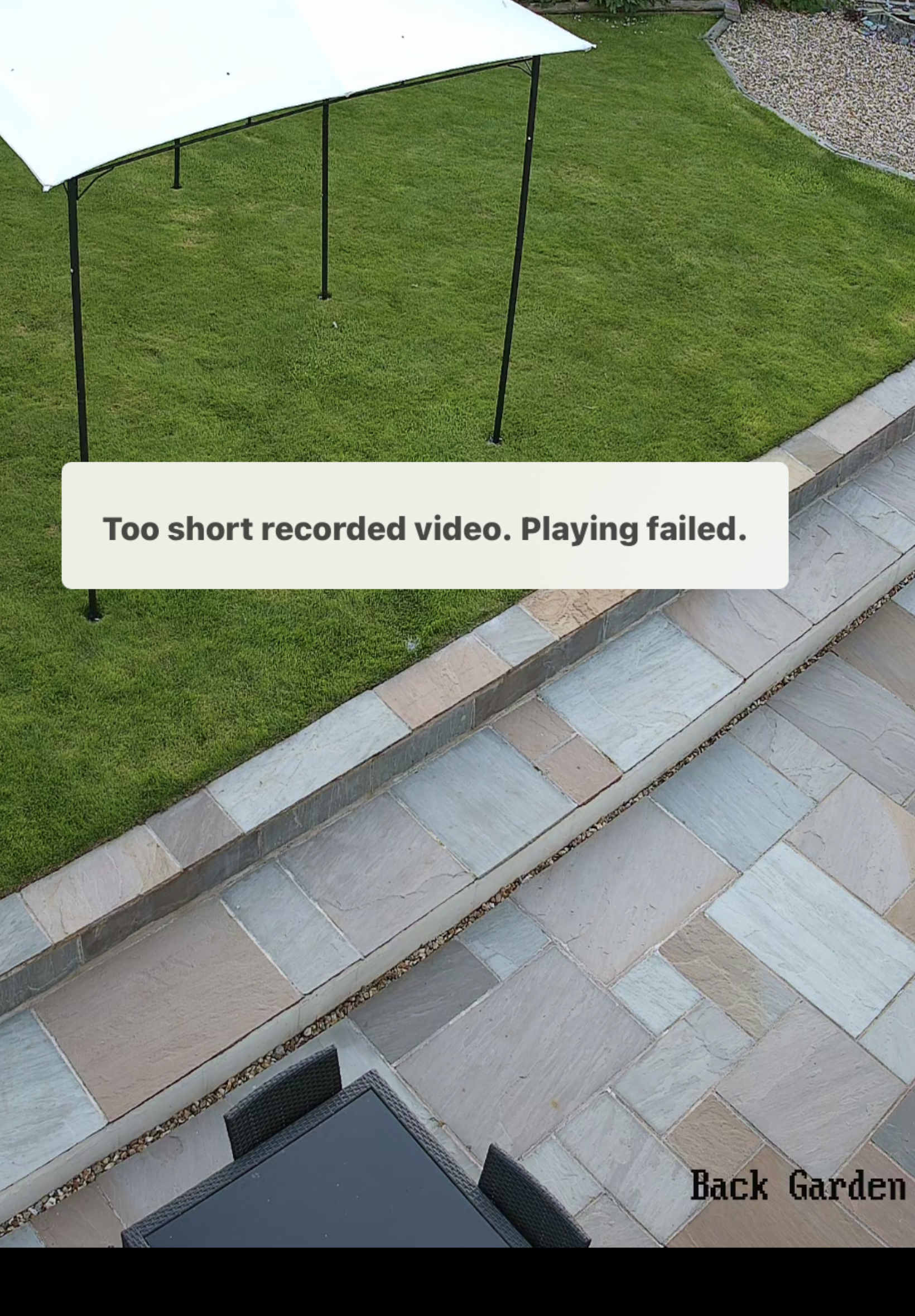

the 8 cams are all on hd and they do work fine .. the only issue I have sometimes is with the hik connect app and saving playback …for some reason I get this message and saved playback doesn’t play …and yet sometimes it’s fine ..which is all a bit frustrating Ive read that the minimum recording time is 10 seconds but my recordings are about a minute . … so I’m a bit confused on this one !
