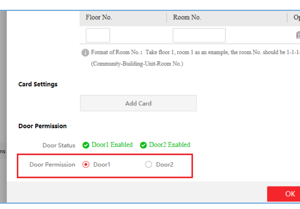

Hi guys,
@nirmnet and @Munu8744
Does what you guys have been discussing resolve my objective number 3 as mentioned in the original post? I am still very curious if it's possible.
