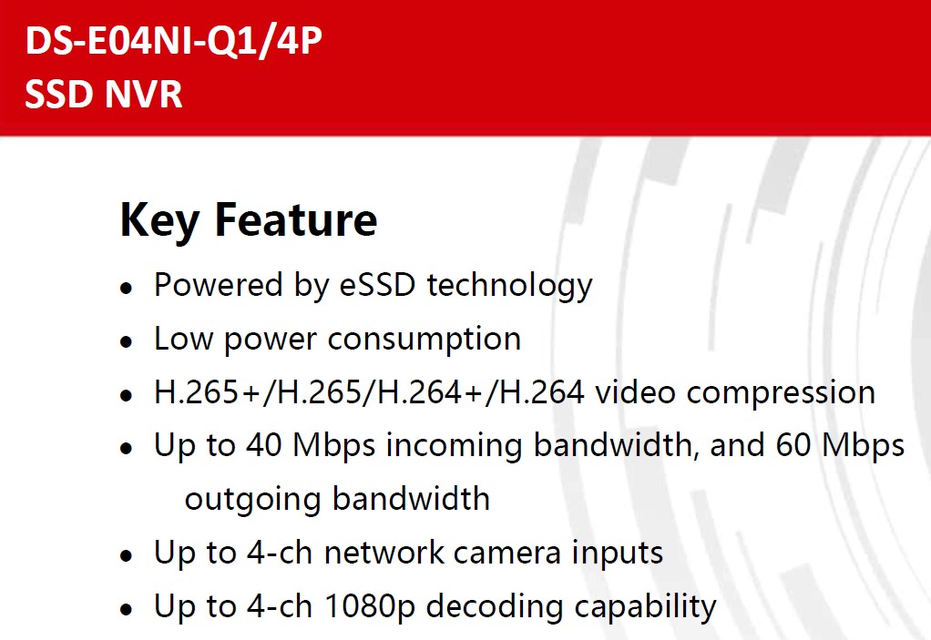

If you look at the attached snapshot of the Data Sheet for the DS-E04NI-Q14P Hikvision NVR, you will see that it has an incoming bandwidth of 40Mbps and outgoing bandwidth of 60Mbps.

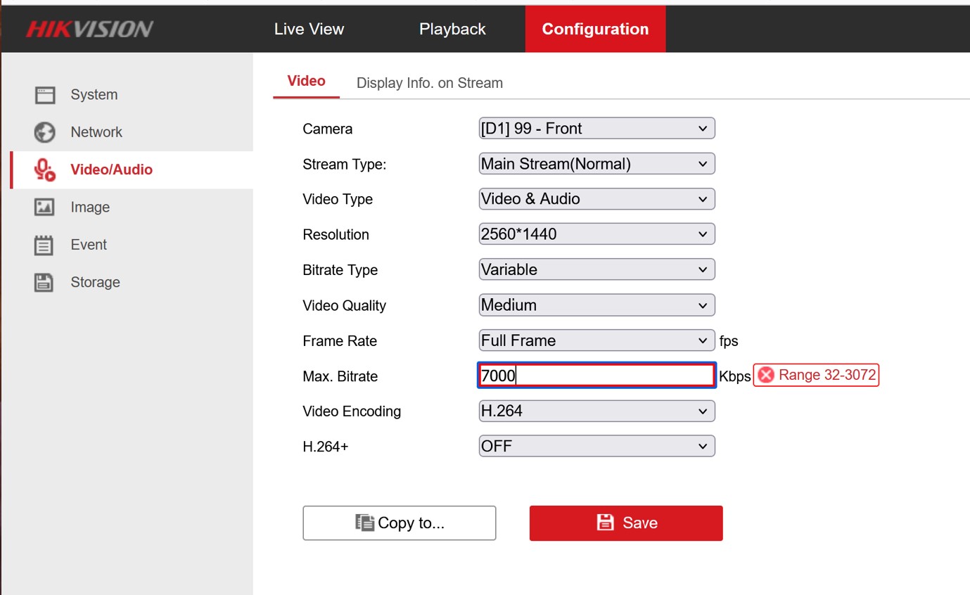

The problem is that this NVR does not let you set a max bitrate of over 3072, an error message pops up stating that the range must be between 'Range 32-3072'. See attachment.
Currently whether I connect 1 or 2 cameras to the POE ports, it does not let me exceed this setting to get better quality recording. I need to use 8192 to cater for the Frame rate and quality. I could use H264+ or H265+, but do not wish to do so. I normally on all my NVRs use H264.
Is this a bug?

Worth a try but I've no idea whether this will work...It's an NVR so the video parameters come from the camera even though you are adjusting them via teh NVR interface. Connect to the camera directly using its web interface and set your parameters in the camera. What the NVR interface will show after that in the Video Parameters I'm unsure, but the NVR will just record the main stream as it receives it; the NVR shouldn't change it after that. The only issue I can see is that if the Main Stream (event) settings on the NVR don't automatically adjust themselves to match the main stream settings you enter directly on the camera. That could cause some strange results. You'd be able to see what's going on by hovering teh mouse pointer over the stream details icon on a monitor while viewing the main stream.
It may be a bug. It seems unusual to be unable to set up the cameras to suit your requirements. I tend to use the total incoming bandwidth rather than the number of channels so might have an NVR partially populated with cameras set at higher bitrates.

I did the following:
  • Left the POE camera connected to the NVR POE port.
  • Removed the Ethernet cable connected from the NVR LAN port.
  • Connected an Ethernet cable from an unused POE port of the NVR to the Router Switch.
  • Used SADP to change the IP address of the camera to the same subnet as the router.
  • Logged in to the camera and changed the Max. bitrate to 8192. It allowed me to do this.
  • Used SADP to change the camera IP address back to the subnet used for the NVR.
  • Removed the Ethernet cable from an unused POE port of the NVR to the Router Switch.
  • Connected the Ethernet cable from the switch back to NVR LAN port.
  • When viewing the camera settings in the NVR, I see 8192 under custom, which is correct. Also noticed the NVR is now showing the Variable Maximum bitrate up to 8192 when viewing the camera stream.
So, the above worked and the camera retained the setting. Unfortunately, if I tweak any other setting for the camera in the NVR, it reverts back to 3072 as the max bitrate. So, I got to be careful I do all the settings as I want first time round, otherwise I have to go through this procedure again.
