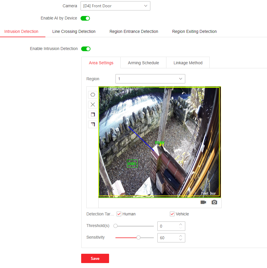

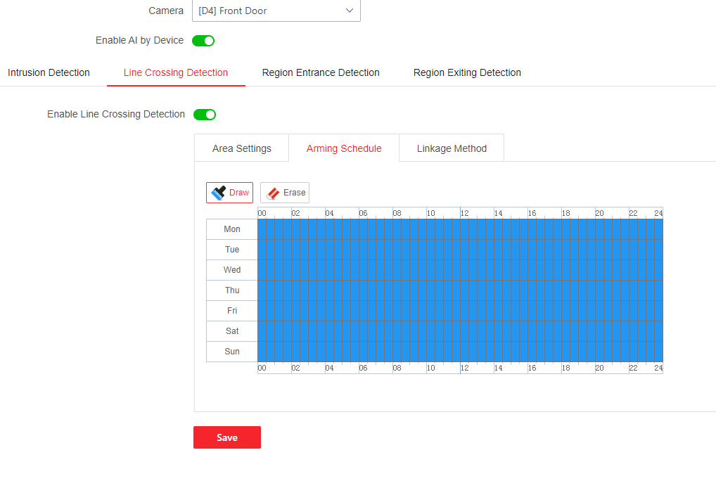

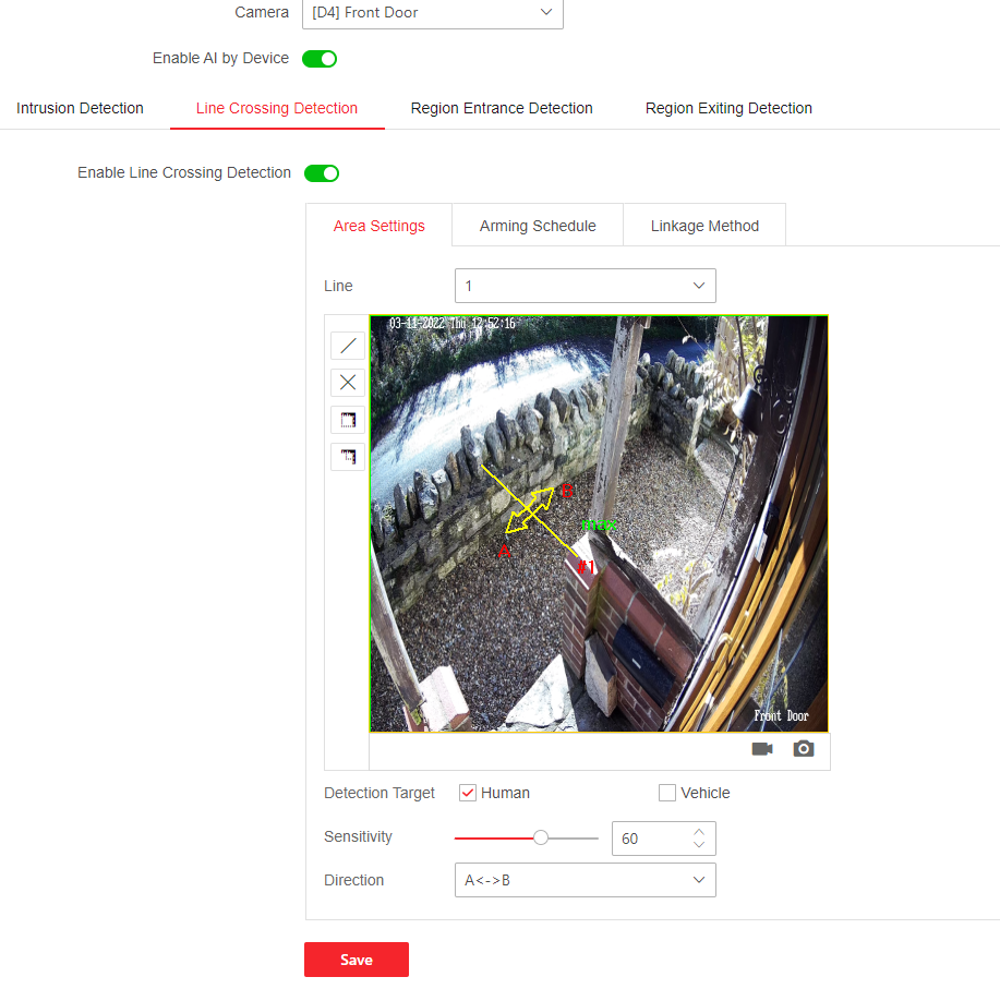

Can you send a screenshot of the event area settings and arming schedule, please?
(Feel free to block out the camera preview.)

Thanks, your settings all look good to me.
