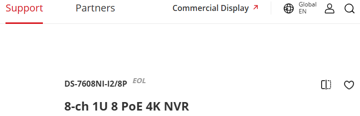

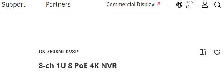

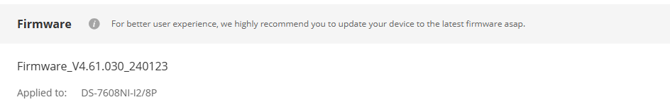

You guys have to stop leaving the house :) ... it's the same on both UK and Europe product pages:

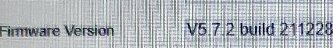

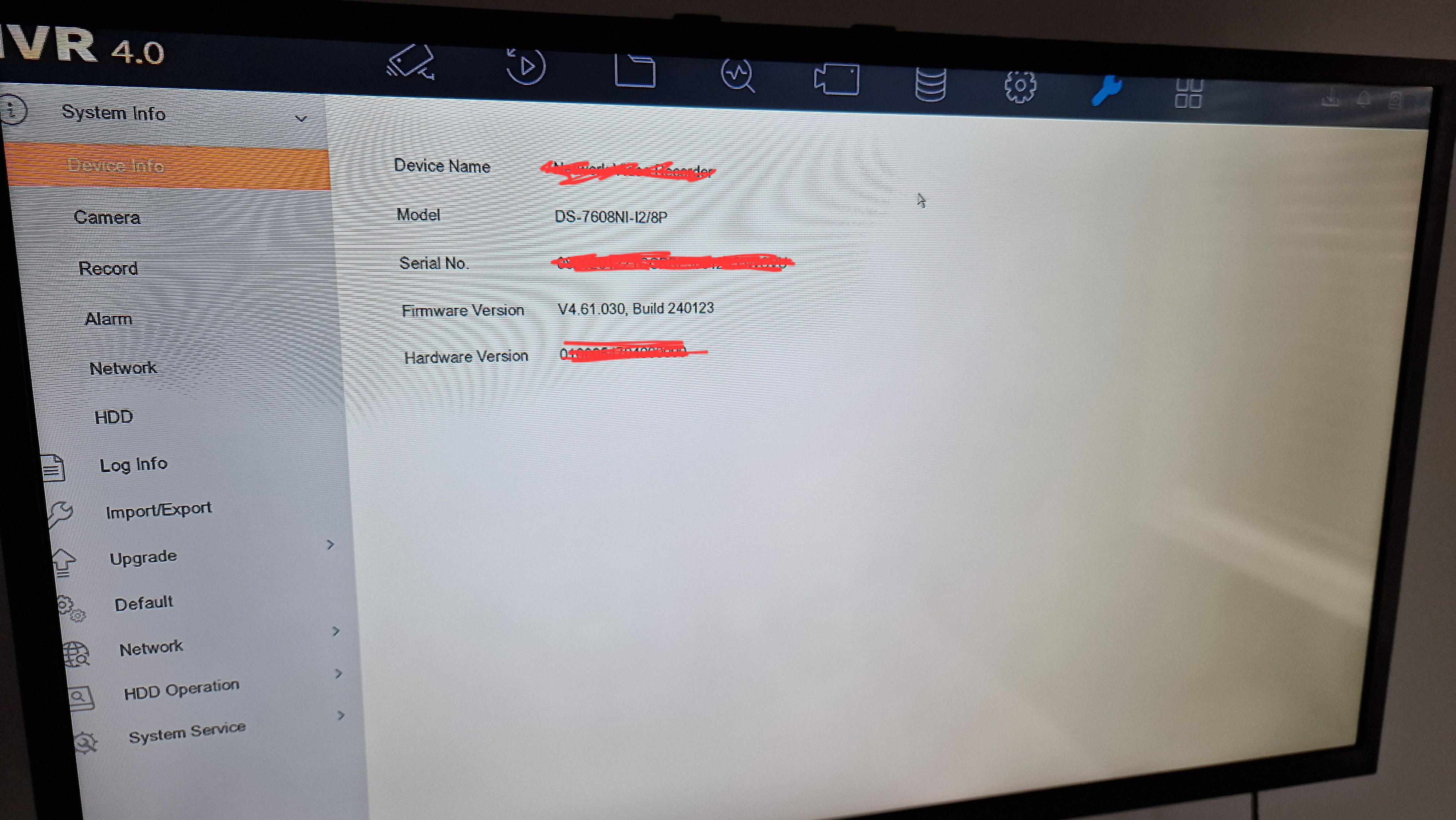

my firmware is V4.61.030 build 240123.
Camera connected to the NVR is a DS-2CD2347G1-LU, firmware V5.6.6 build 210625, set for continuous record, dual VCA box ticked.
playing back at the NVR with smart selected and human / vehicle not selected, I have a continuous blue line with red intrusion events on it. These events are anything that moves in the box. Selecting human or vehicle / human & vehicle the red lines disappear, leaving the continuous blue line.
Does that help?
