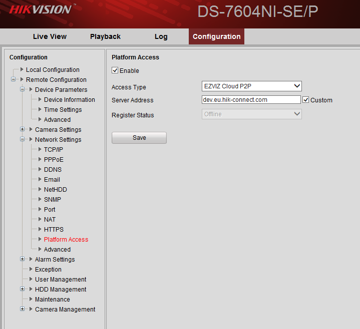

If you are already using IE can you post a screenshot of what you are seeing when trying to enable Platform Access in the browser?
I'm running IE Tab within Chrome, screenshot below. Also tried with EDGE but still no luck, I can select the button but it won't let me save. Select and save works fine on all other tabs.
With SADP the enable button is greyed out so I can't even select it.
Can you try the server address that the current NVRs use - litedev.eu.hik-connect.com
I can input the current address and save that but enable still won't save.
Okay, I can only think that due to the age of the NVR and the fact that the Platform access menu does not offer the option to set an encryption key (which is a security requirement of all the newer NVR models) Hikvision has removed support for SE models on Hik-Connect.

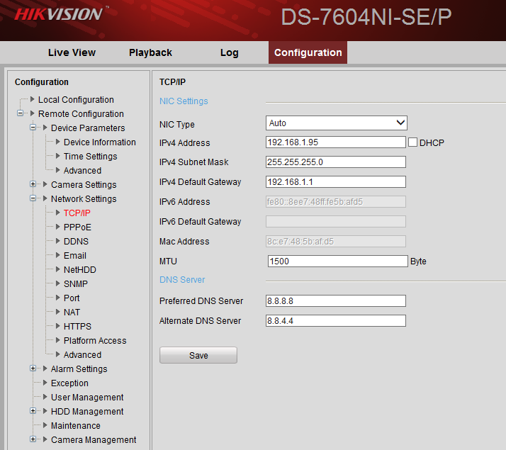

Perhaps show us your Network Settings?
Gateway, DNS, etc.
Just to make sure that the basics are in place?
Thanks Dan, could be an obsoletion issue then. Time for an upgrade maybe.
Gateway, DNS, etc.
Hi Phil - screenshot below of Network settings. Anything look amiss?

Those settings look fine.
You could try setting up DDNS or port forwarding (you won't get Push alerts).
