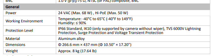

My first thought would be insufficient power.

The PSU/Transformer is a 24V AC 3amp 72W
The POE is a 60w 55v (1.25A-Max)
Based on the above stat's in the PDF my power supply's should be sufficient.
