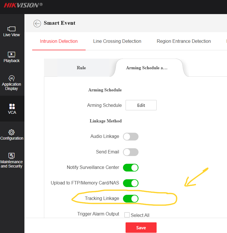

Just installed the hikvision DS-2DE4225IWG-E but really struggling to configure the configurations for auto tracking my camera only moves when I move it

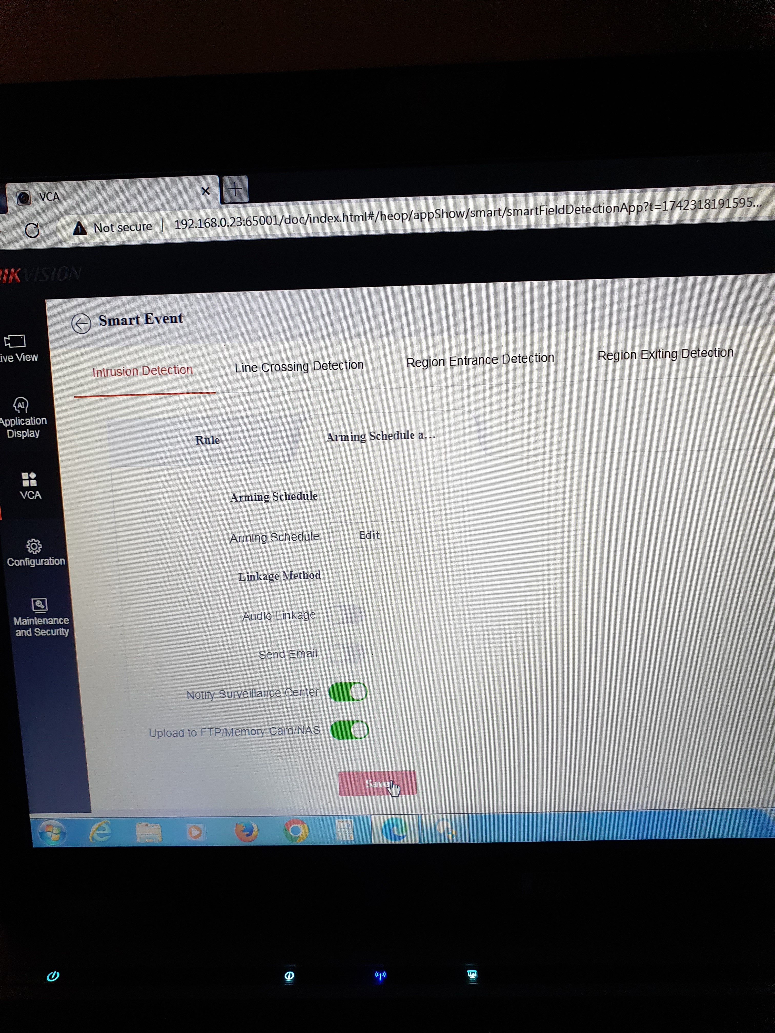

My DS-2DE4A425IWG-E and your DS-2DE4A225IWG-E cameras do have auto-tracking. Same cameras with the exception one is 4MP and the other is 2MP. You can configure smart events on the camera to start auto-tracking. This is where you need to go in the camera web GUI menus to configure it:
View attachment 12630 View attachment 12631

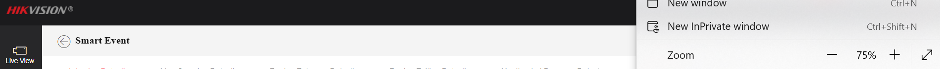

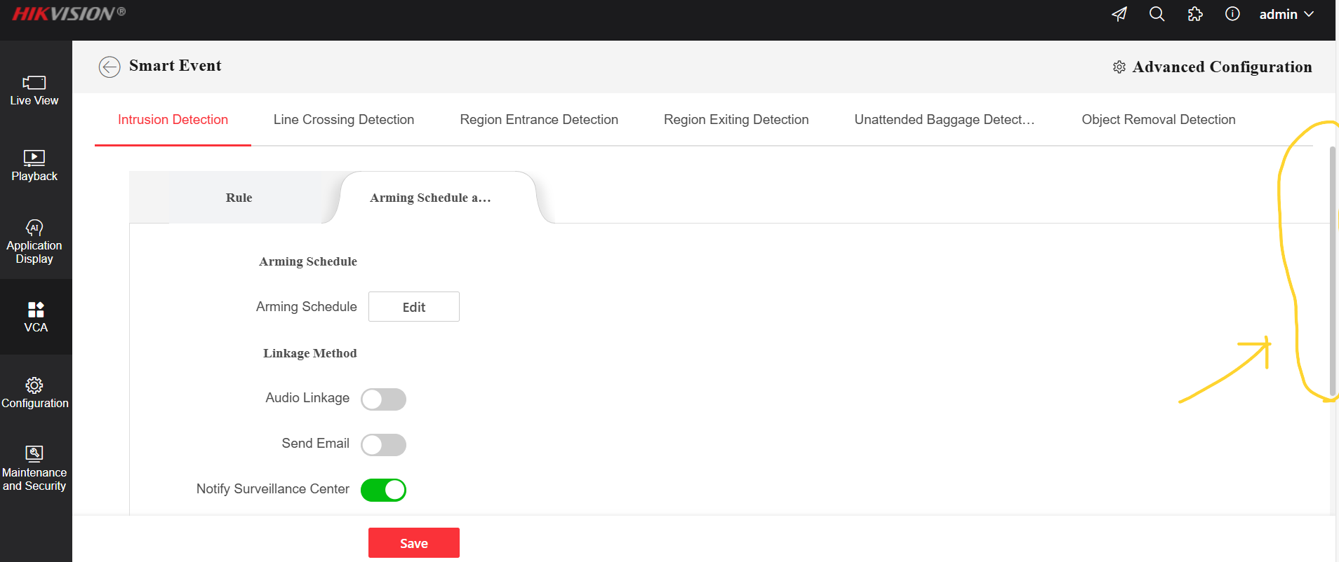

No tracking I can highlight green nothing there?

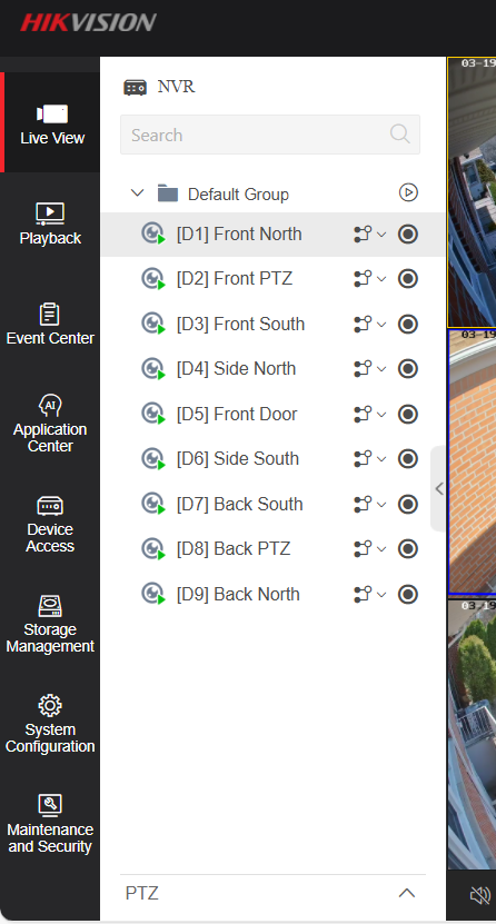

It's down there... either use the scroll bar on the right side of the screen:
or lower the zoom level in the browser:

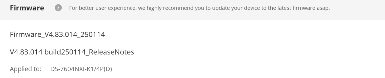

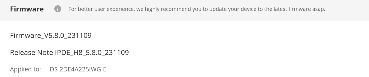

There is newer firmware for you NVR available here:
DS-7604NXI-K1/4P(D)
Also, check your PTZ camera that you are running this latest firmware:
DS-2DE4A225IWG-E
Amazing I was crying last night now got a big smile om my face...thank uou sooooo much xx

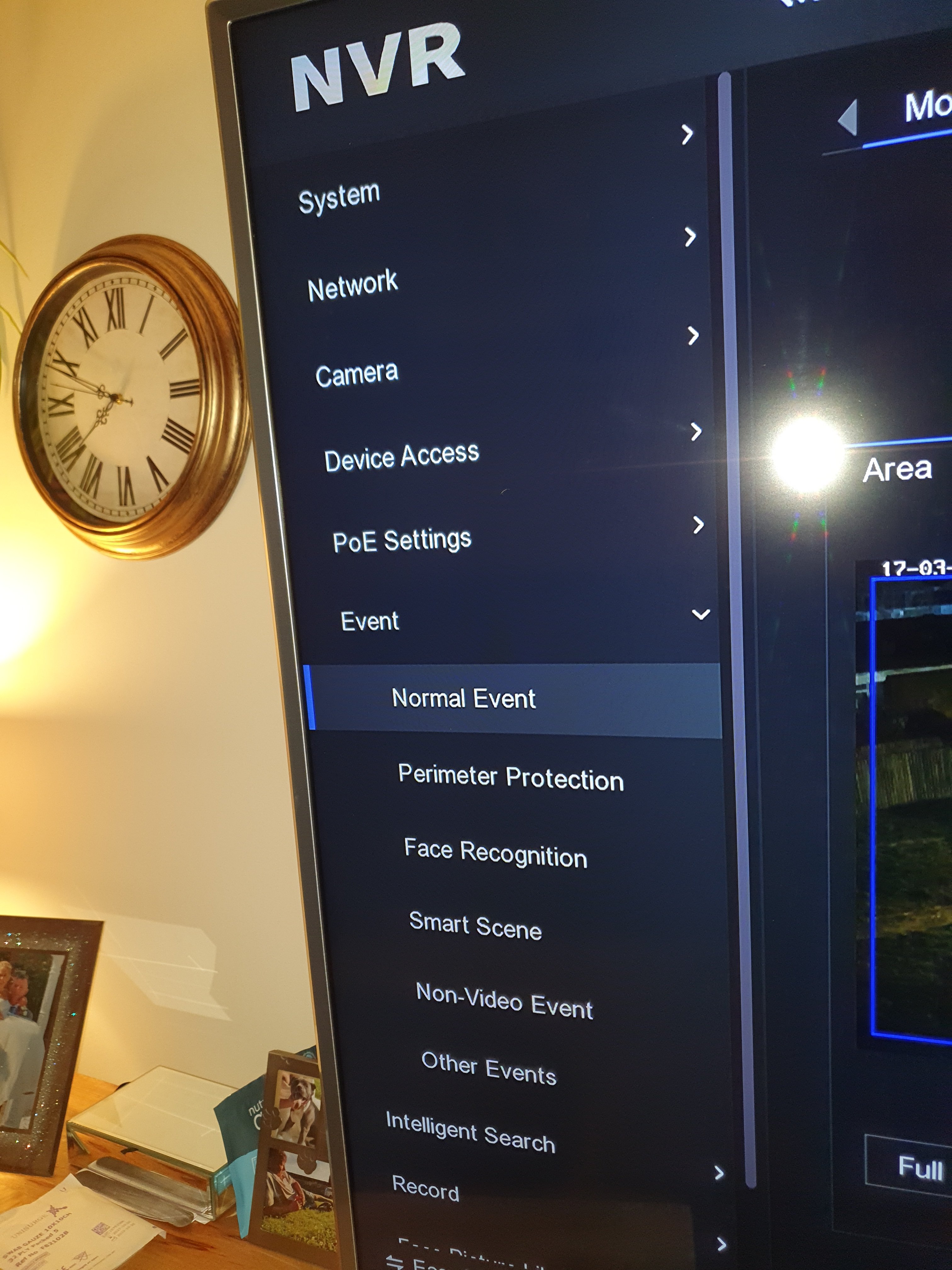

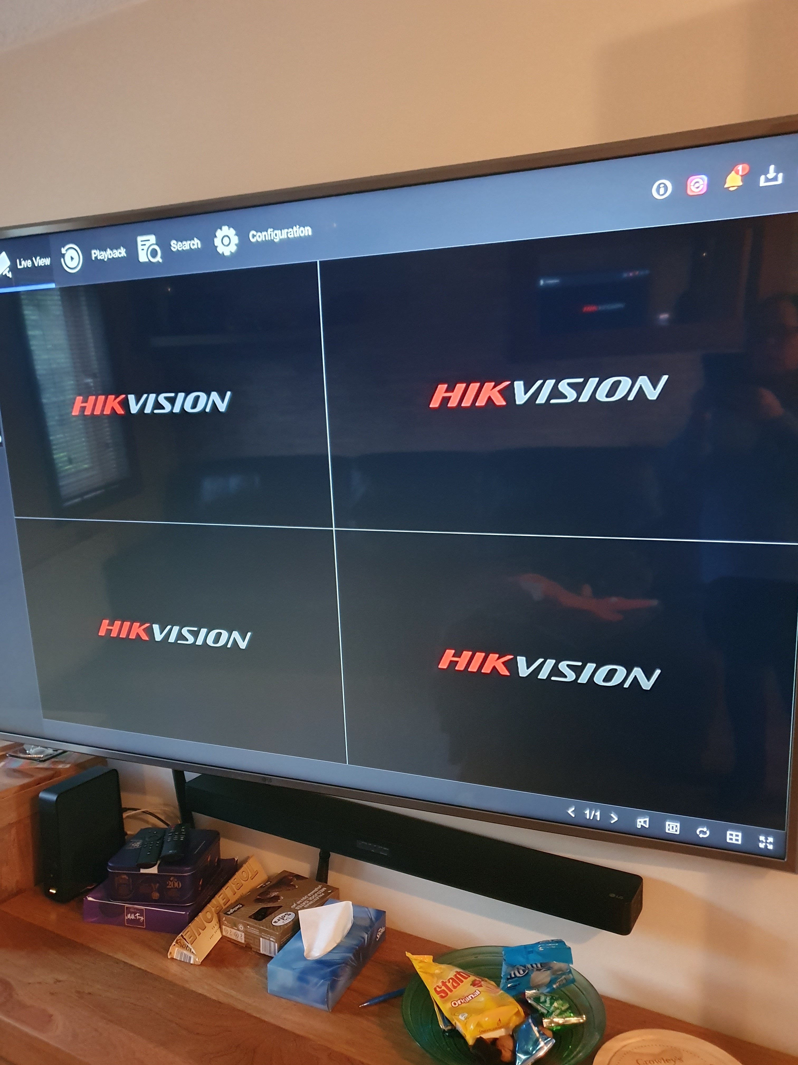

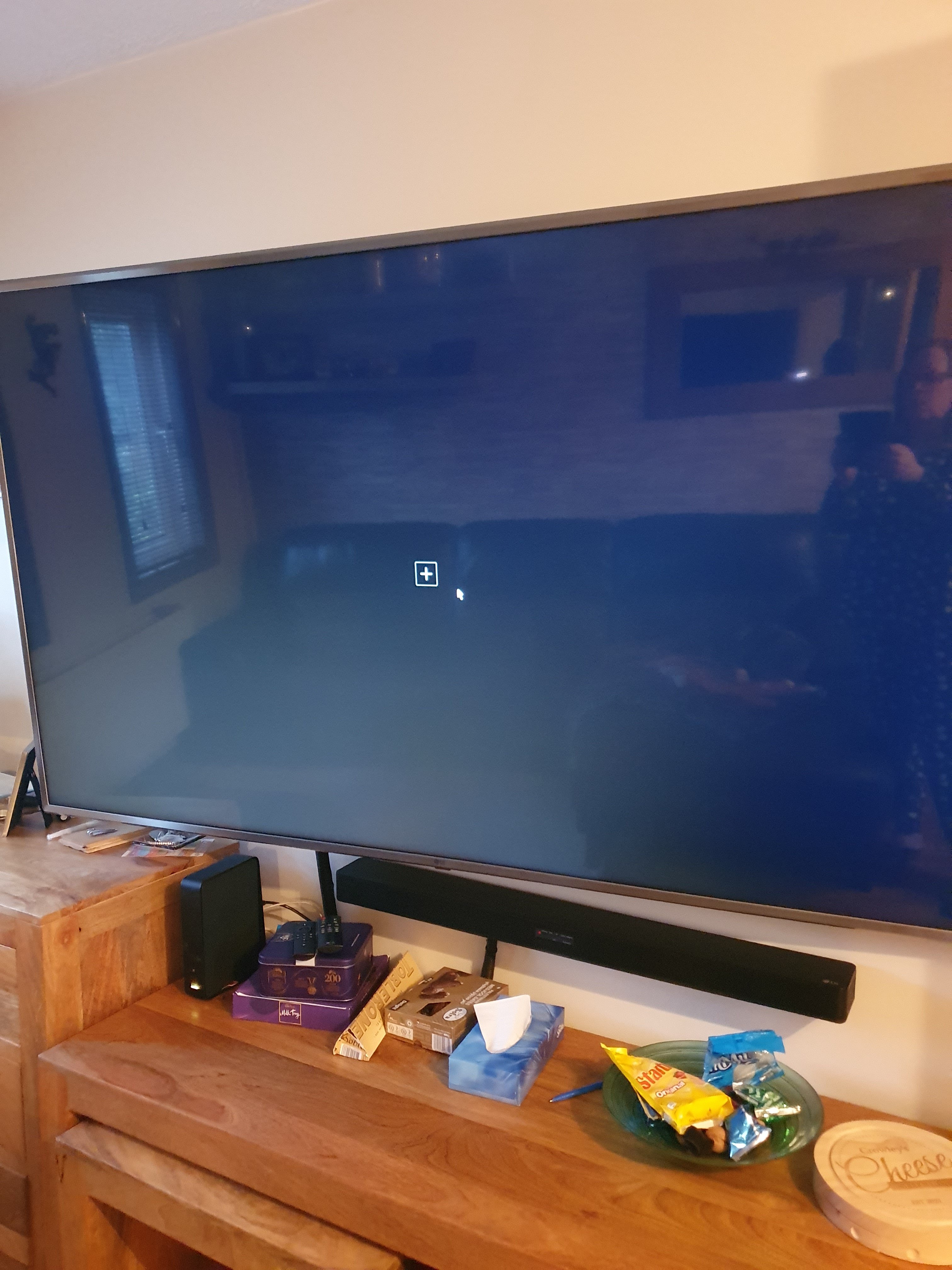

Hi John somethings happened can't cam on tv but can on phone? Husbands going to kill me
Hmm... it's not too bad if you can still see the cameras on the phone...
First easiest thing to try is rebooting the NVR.
What was the last thing you remember doing before this happened?
Do you see the cameras if you use your computer and log into the NVR web GUI? like this:
Rebooted the NVR still the same
I was looking play back then went to live view and screen had gone.

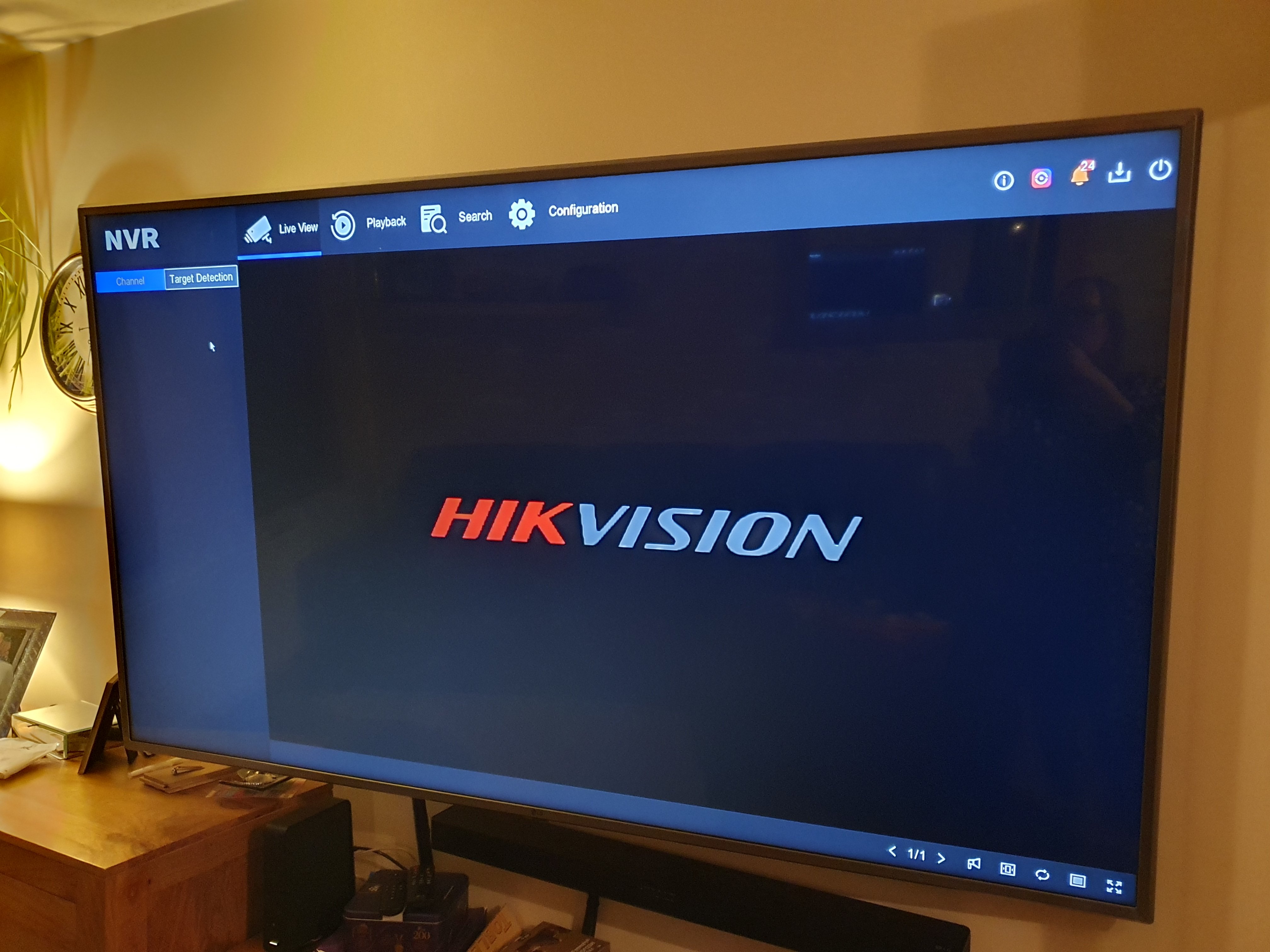

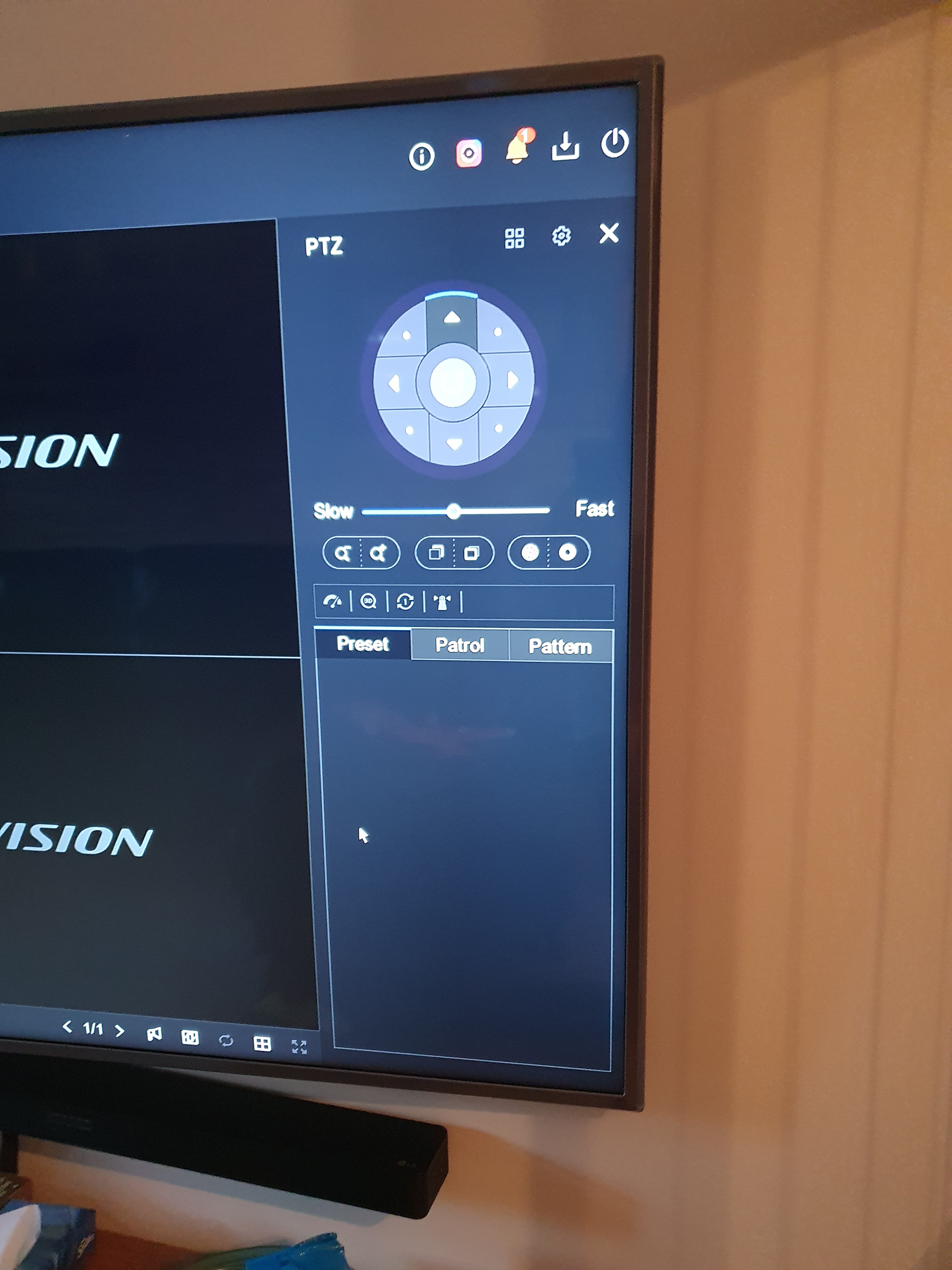

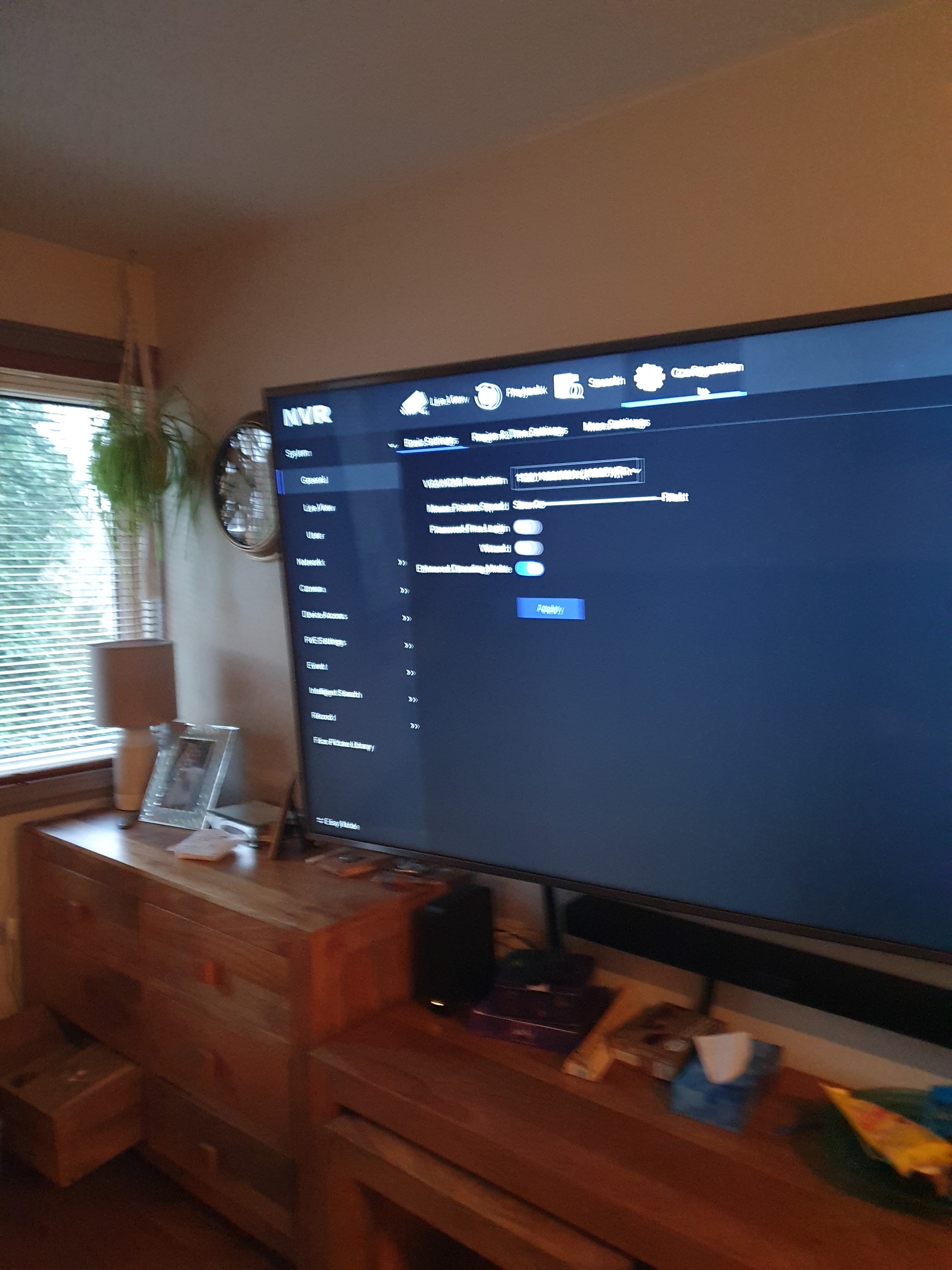

Can see on laptop..but on tv can't use any of the setting preset or go to the settings at top

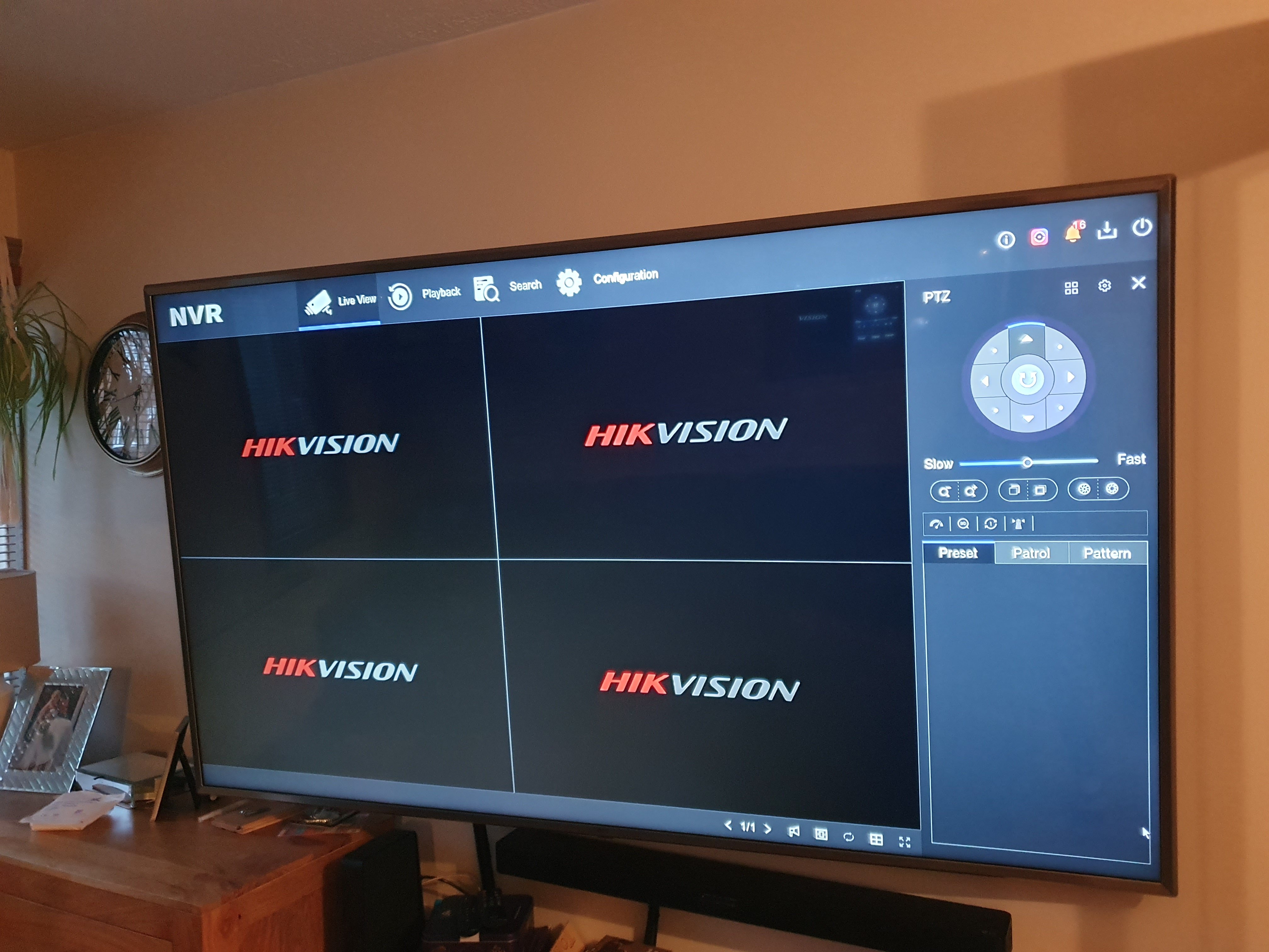

Send another picture of the TV... I need to see the left side of the screen.
If you use the mouse to click configuration at the top, do you get the configuration menu?
Thinking back I may of click on that

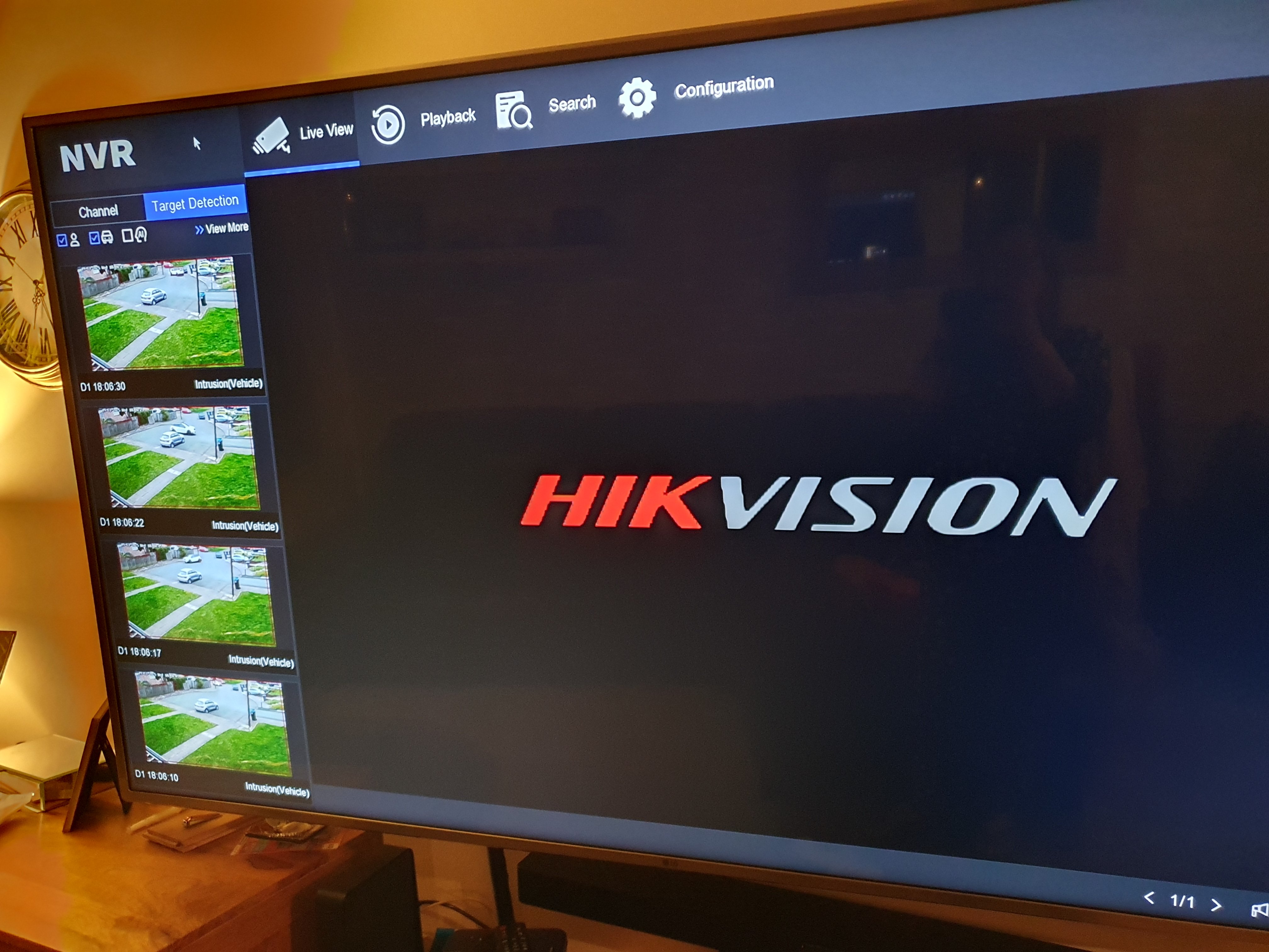

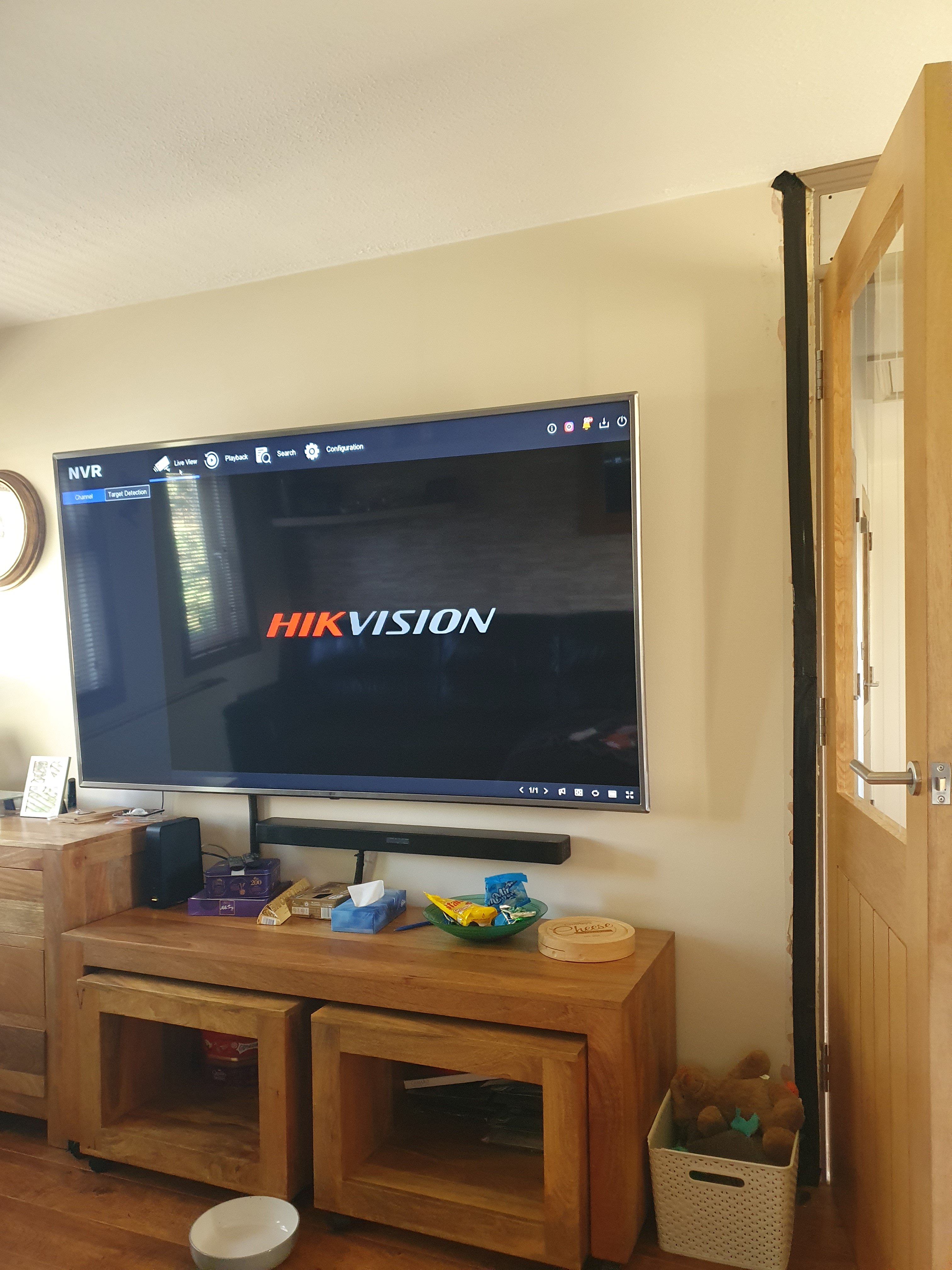

oops... I'm meant send a picture of the whole TV screen on "live view" before you clicked configuration
All leads are I've checked them because I pulled tv out
hit the "X" on the PTZ menu window and send another picture... I looking to see this again...
