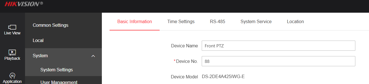

I have a DS-2DE4A225IWG-E, and the auto-tracking works pretty well... first, I think you may have a typo in the model number:
DS-2DE4225IWG-E
I'm pretty sure you meant DS-2DE4A225IWG-E (just missing the "A")? Please confirm if this is correct.

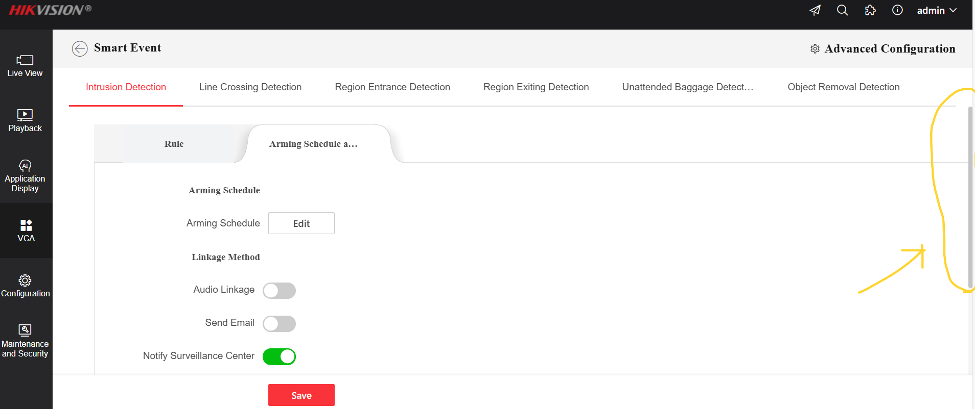

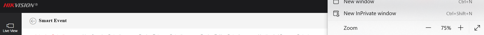

My DS-2DE4A425IWG-E and your DS-2DE4A225IWG-E cameras do have auto-tracking. Same cameras with the exception one is 4MP and the other is 2MP. You can configure smart events on the camera to start auto-tracking. This is where you need to go in the camera web GUI menus to configure it:

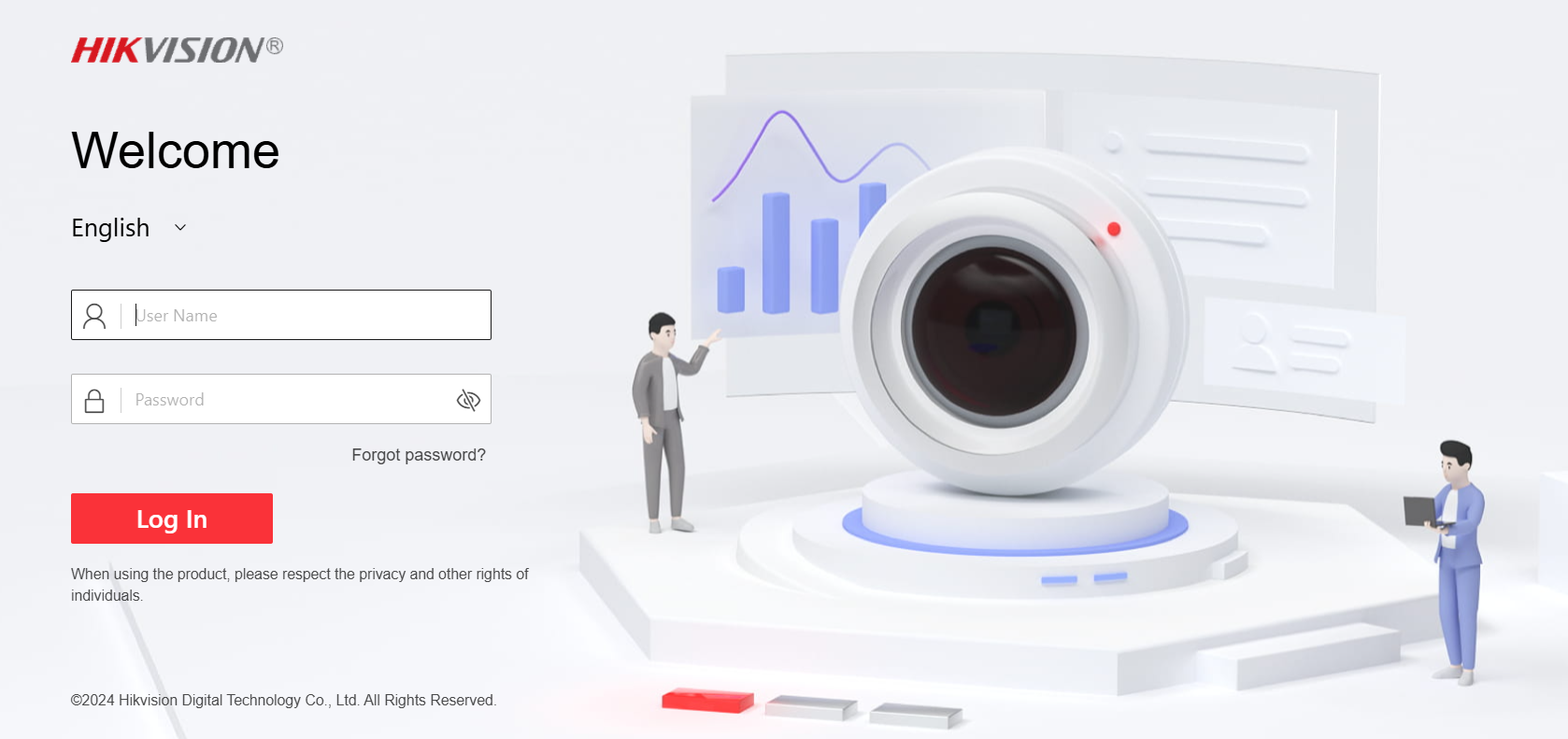

Then you should get the camera login page:

Good... now the NVR will allow you to get to the cameras GUI web page... use the NVR IP address with ":65001" if the camera is in PoE port 1, with ":65002" if the camera is in PoE port 2, etc.
Like this:
After you login, you will probably need to download the browser "plug-in":
Close the browser after you download the plug-in... it needs to be installed with the browser closed... then log back into the camera... let me know when you get this far...
View attachment 12630 View attachment 12631

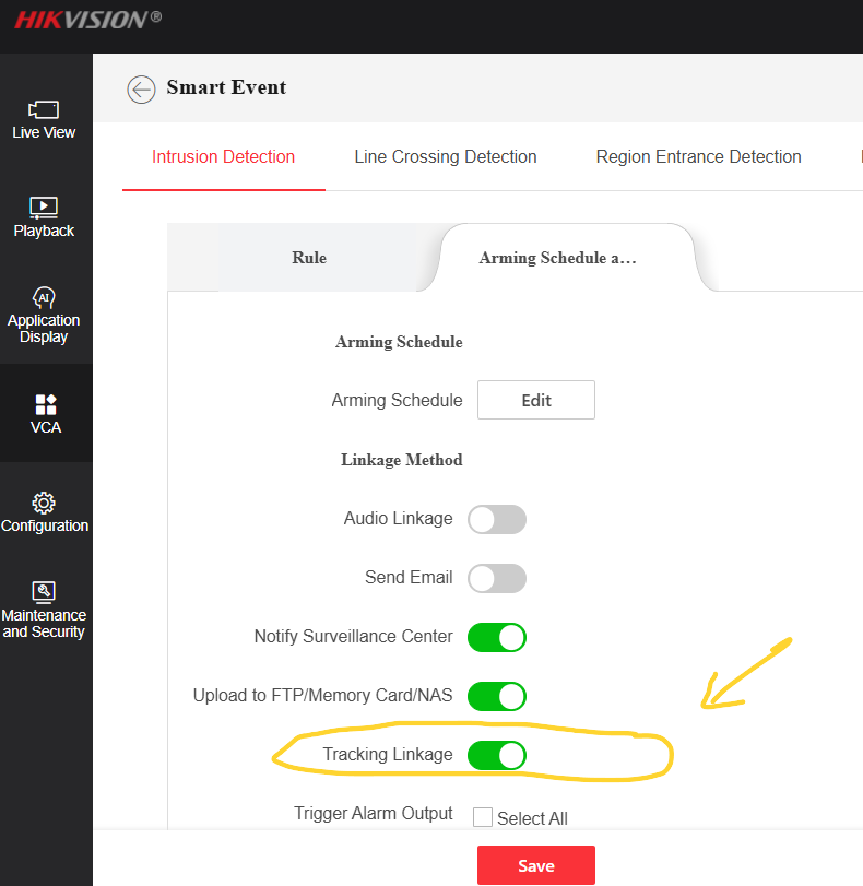

Next, configure an intrusion detection area:
You can use the whole screen to start... save that and set the other parameters similar to this:
Set Human, Vehicle as you wish... and then make sure "tracking linkage" is checked on the "Arming Schedule and Linking Methods" tab:

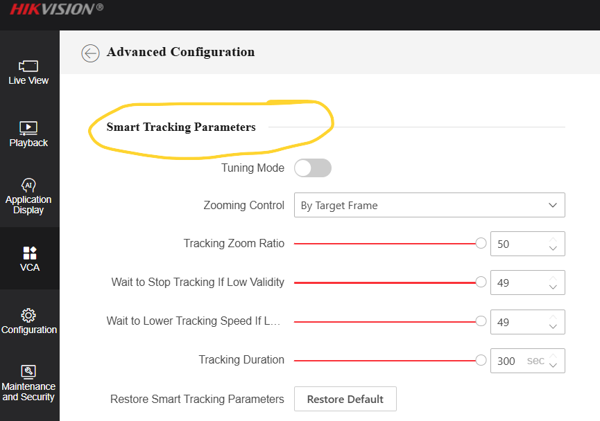

Save that and the camera should start auto-tracking humans/vehicles whatever you set. Also confirm the advanced settings:
You may want to change these later, but these setting work best for me.
