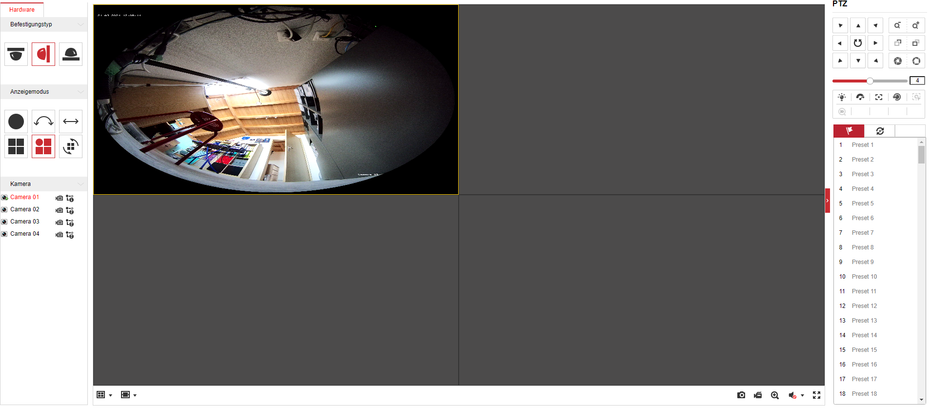

After that i want to activate audio in the right bottom corner (picture).
Also when i change the view to Fisheye + 3PTZ (picture)
Is this a FW issue?

Thanks @valbuz
What browser are you using to access the camera? Firefox, Chrome, or something else?

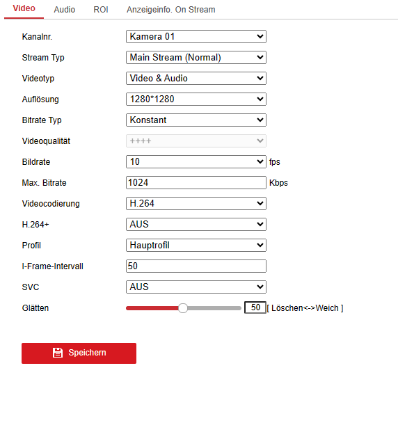

In regards to the viewing mode issue, it might possibly be to do with your stream settings. See the below information from the camera's datasheet that states the camera must be set to 10fps and one of these 3 resolutions for this particular viewing mode to work:
Fisheye + 3PTZ
50Hz: camera 01: 10 fps (2560 × 2560, 2048 × 2048, 1280 × 1280)
Thanks.
The settings for the cam is correct.

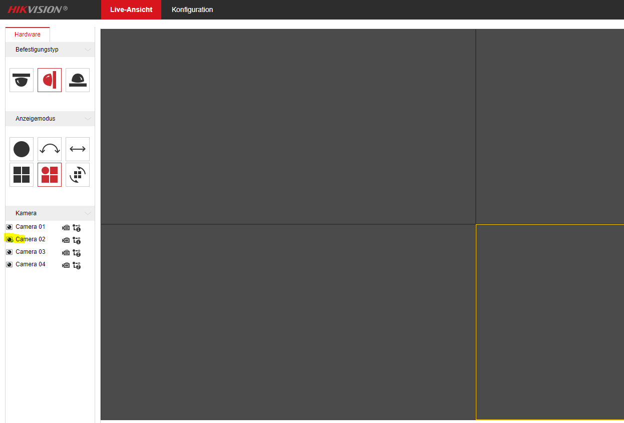

On the camera's live view page where you have the list of cameras 01/02/03/04, have you tried double-clicking the little camera icon to the left of cameras 02 to 04?
Sometimes in the browser live view, not all of the camera channels will play automatically and you have to manually start the live view by clicking those camera icons.
Ja, ich versuche es auch. Jedes Mal, wenn ich unten rechts erhalte: Livefeed-Fehler
it seems, i can onyl active one cam, but after i double click on another cam, my first feed goes down

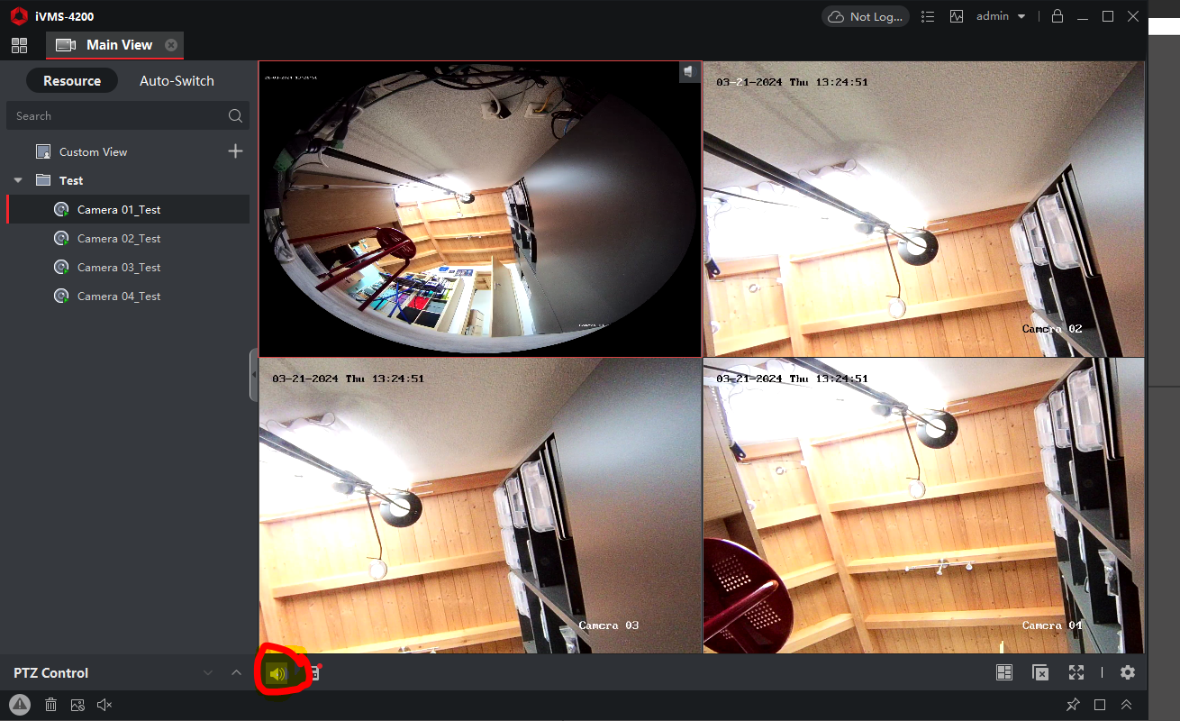

Yeah, I think the problem is that this camera has not received a recent enough firmware to offer full support for modern browsers like Chrome, Edge, and Firefox.
I think this might mean that the only way for you to get stable performance out of this camera will be to access it using Hikvision's free desktop software - iVMS-4200(V3.10.1.5_E)
Thanks.
With this Software i can select 4 Cameras and Audio!
