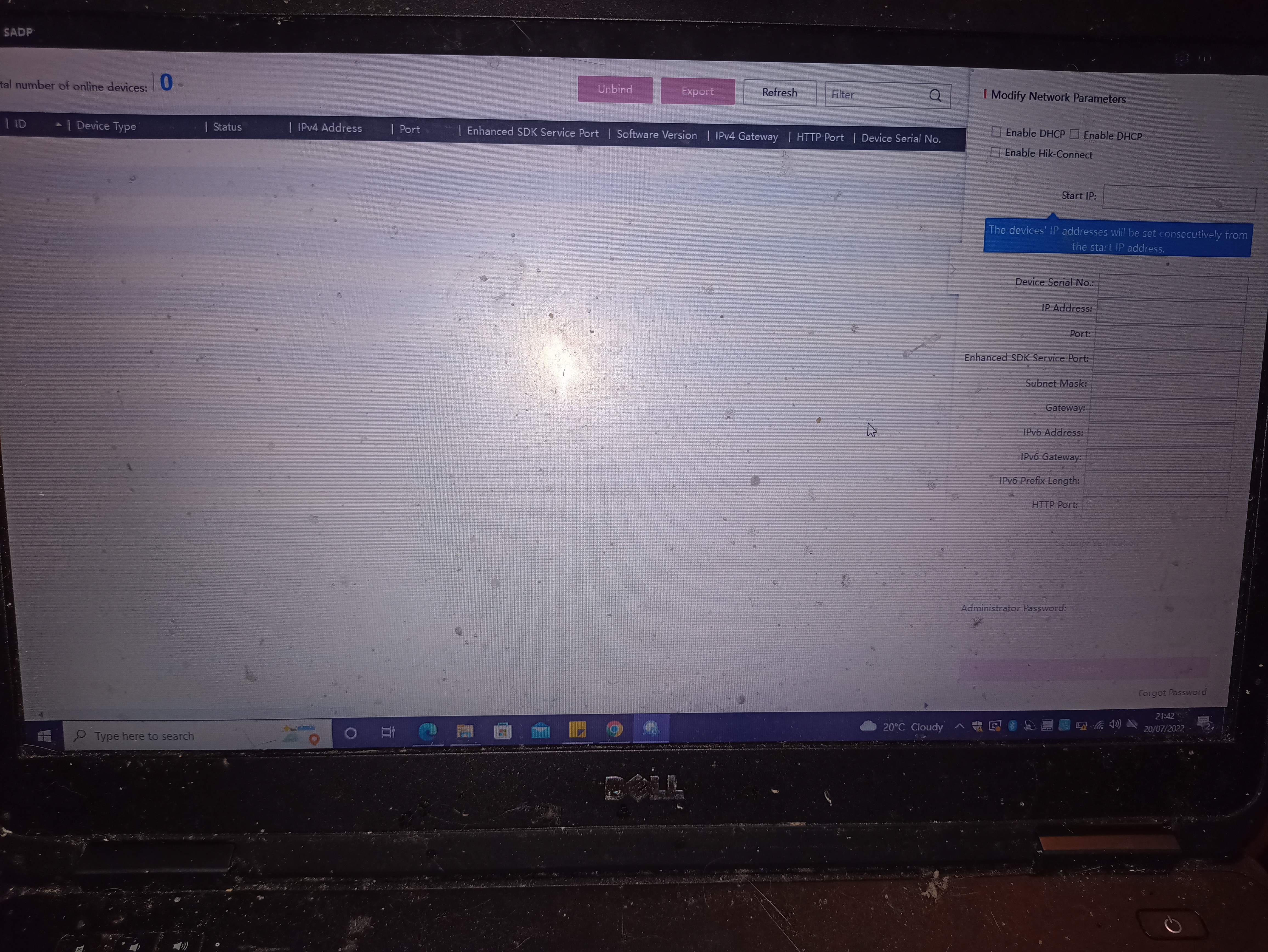

Open SADP
Maximise it to full-screen by clicking the small square icon at the top-right
Press the PrtScrn button on your laptop keyboard
Come back here to the forum
With the cursor in a new Post, press the Ctrl and letter V buttons on your laptop keyboard to post the screenshot of SADP here
Click the forum's Post reply button to let me see it

I don't know if this is going to work!

OK, as you said, SADP is showing no devices.
Is that laptop connected to the same network that your cameras/NVRs are?
i.e. you are at home / the CCTV is at home / the CCTV is connected to the home network / the laptop is connected to the home network.

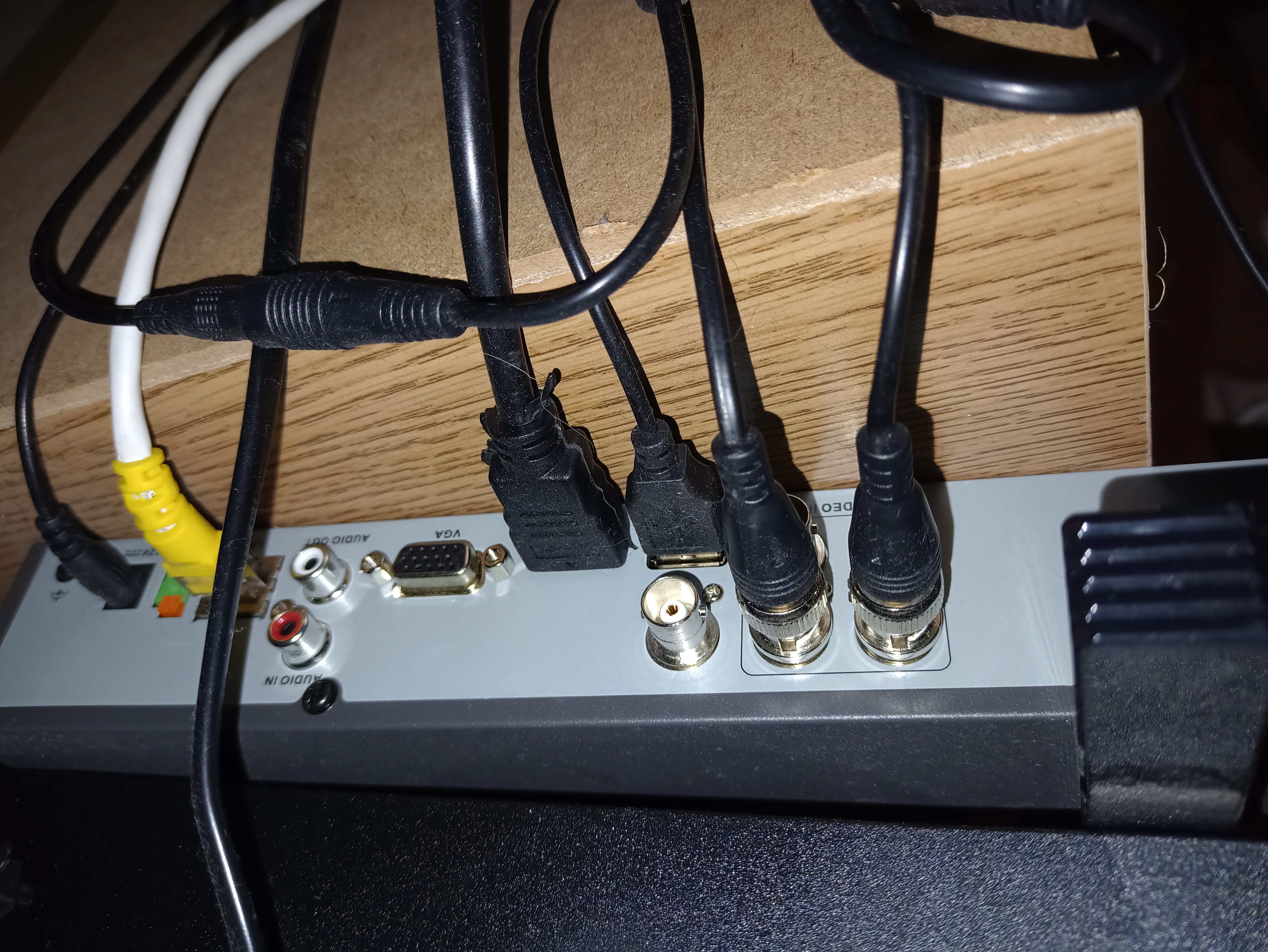

If it is still working on your TV then there must be a video/monitor cable connected from the NVR to the TV.
That cable will be plugged into either the HDMI socket or VGA socket on the rear of the NVR box, and also into the back of the TV.

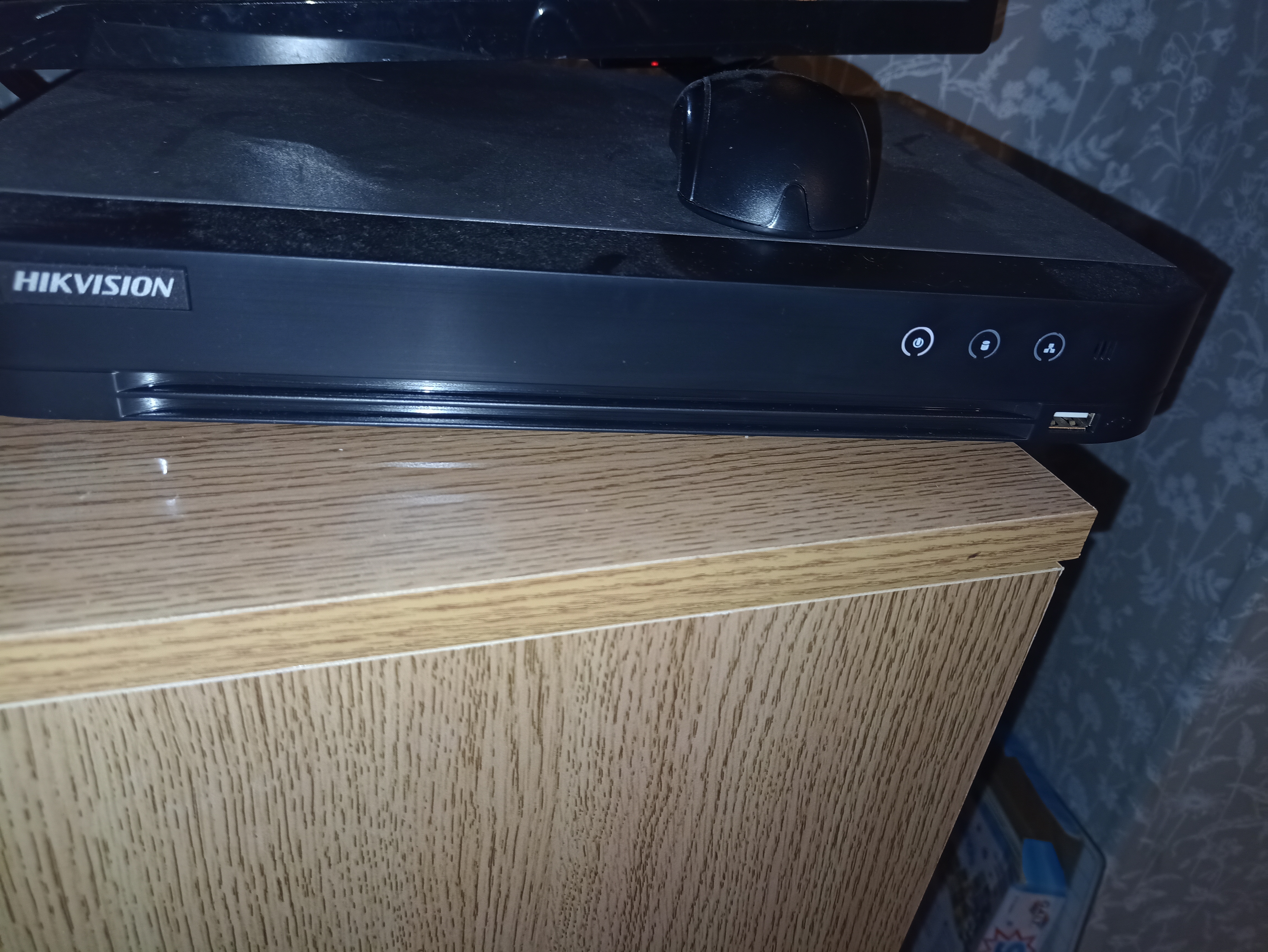

Can you upload some photos of the NVR box please?
Maybe front, rear, and label ...

Yes I'm sure it's hikvision

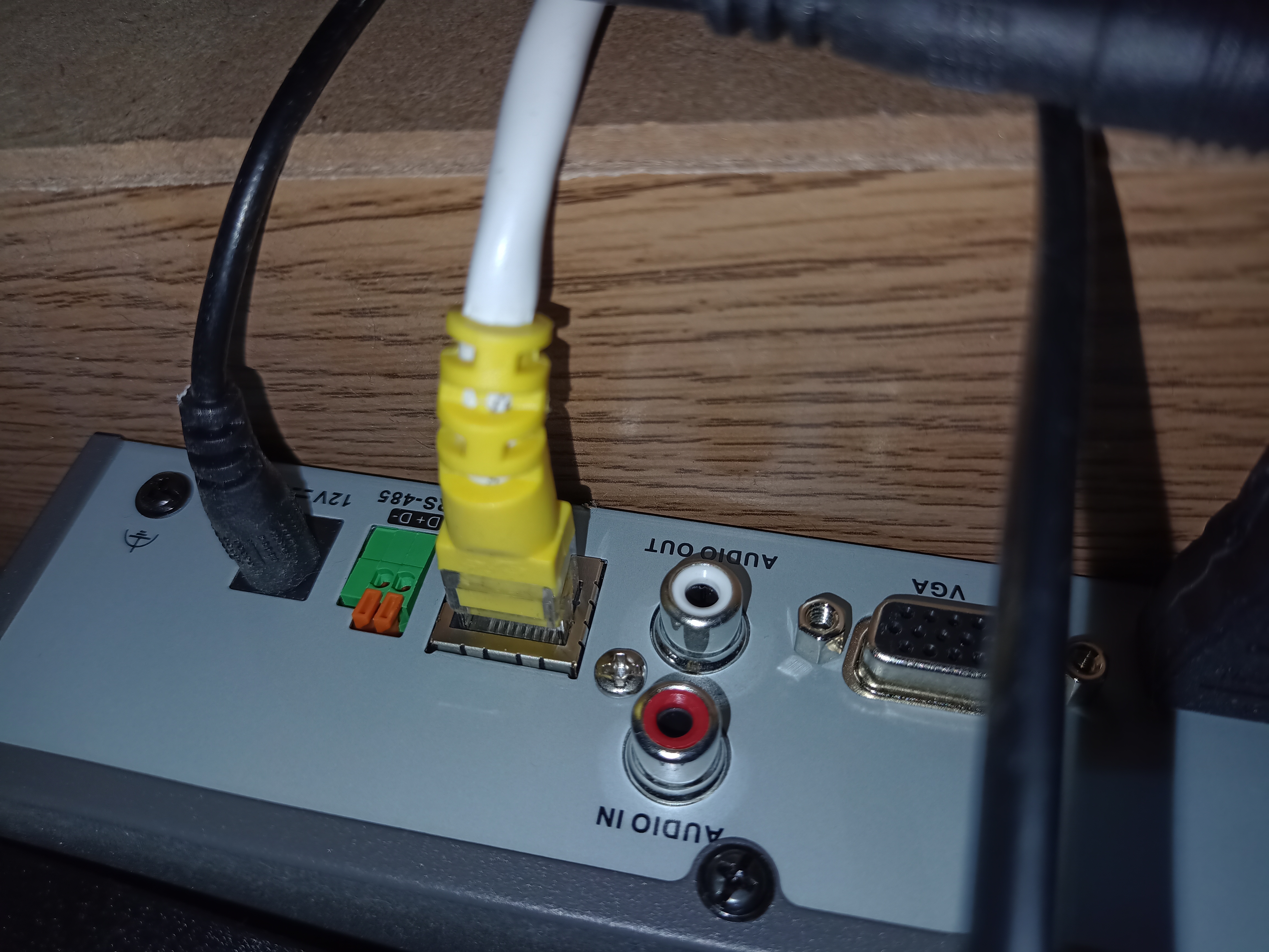

It's a Hikvision DVR, with analogue cameras.
Can you check that the yellow plug of the network cable is fully plugged-in please.
Then follow the lead, to see where the other end is connected, and ensure that it too is properly plugged-in.

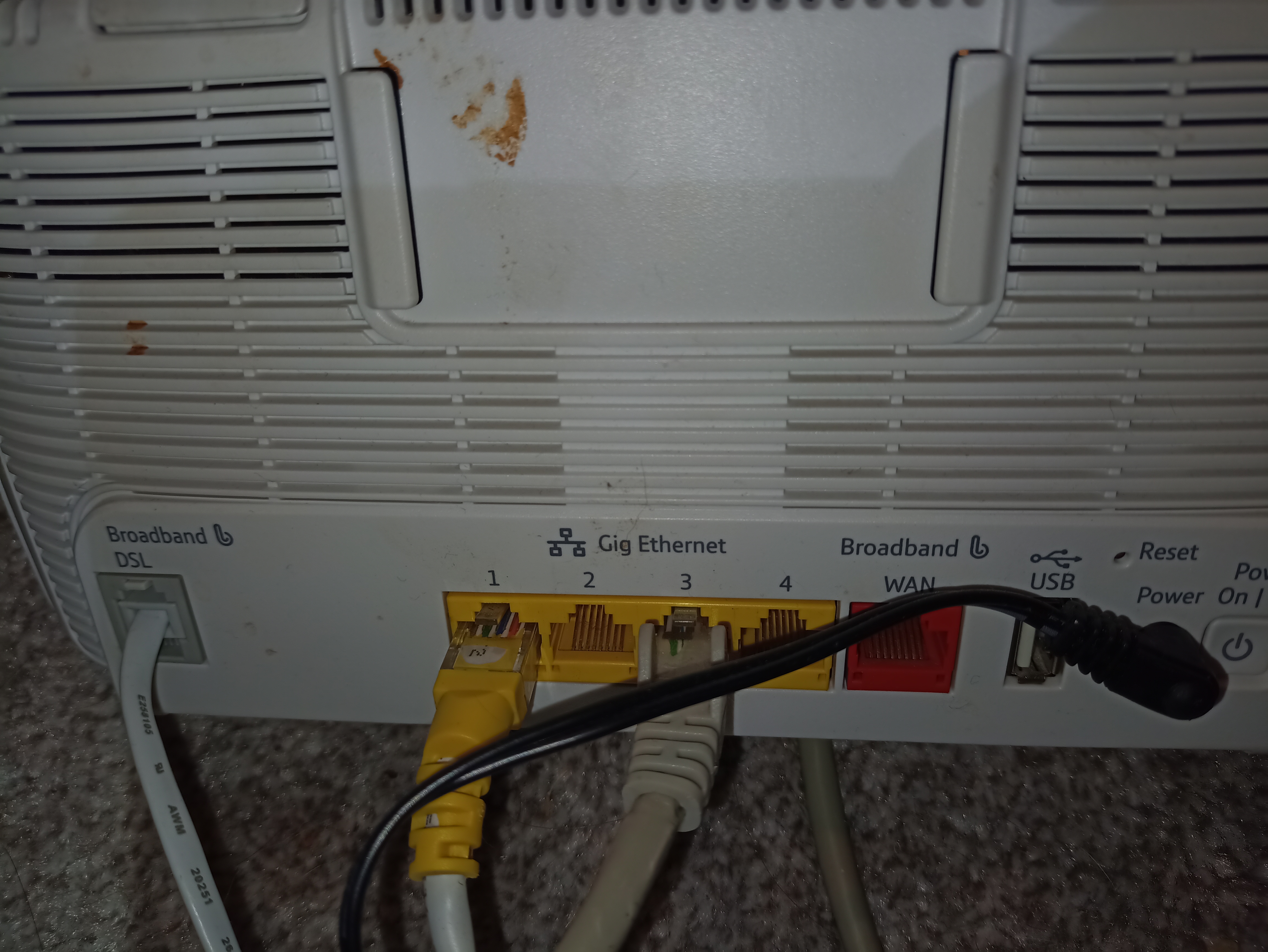

Maybe then share a photo of what the other end of the network cable is connected to (perhaps your home router).

They all seem to be plugged in ok
Is this the right pictures?

Yep, that looks like your modem / router.
Do you know what is connected via that other network cable?
We know that the lead with the yellow plug connects the DVR to this router.
Do you still have OK internet access from your laptop and other devices?
If you have a spare network cable available, it would be good to connect your laptop with a cable to the spare port between the yellow and grey plugs on your router, then run SADP again on your laptop to see whether it then finds the DVR (with a wired network connection).

Yes the internet is ok on laptop and mobile.
The other one is ethernet cable I plug into laptop when I'm working from home so I don't use the WiFi.
Should I plug that in my laptop then? Would that help?
