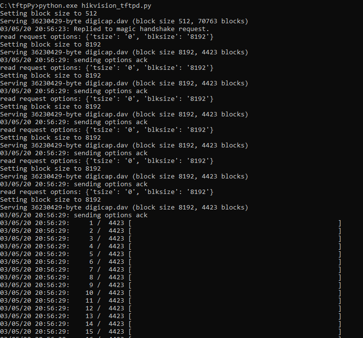

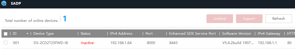

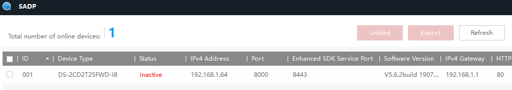

Using Scott Lamb's TFTP tool I was able to upload the firmware and the camera was set to inactive:
To make use of this wonderful tool you will need:
Python 2.7 X86-64
I have not tested it with v3.
A code editor like VSCode or Atom.

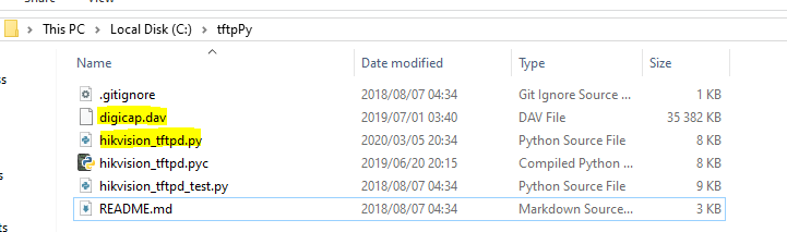

Extract all the files to a folder - C:\tftpPy> is what I went with.
Place the digicap.dav firmware in the folder.

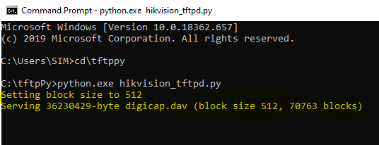

Open a command prompt.
Navigate to your folder and run:
python.exe hikvision_tftpd.py
The camera and PC can be connected to the switch during all of the above.

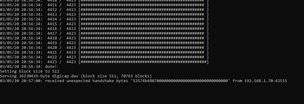

Next unplug the camera and reconnect it. Provided all is setup correctly the firmware will begin to upload:
Don't worry if you get a 'Unexpected Handshake' at the end.
Close the command prompt. Unplug the camera and re-connect it.
Give it a minute then load SADP and see if it is detected.

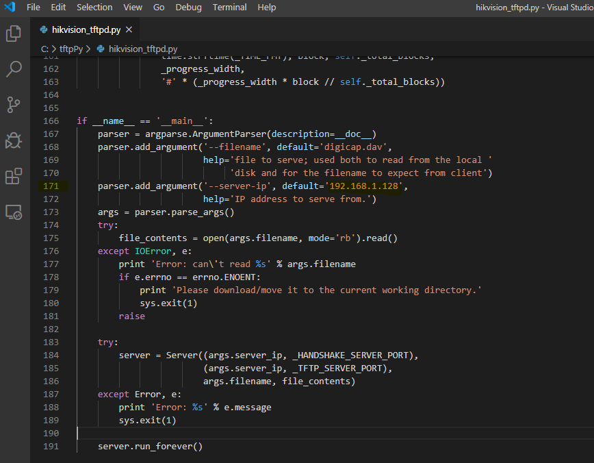

Forgot to mention you may need to edit the TFTP server in the code here (line 171):

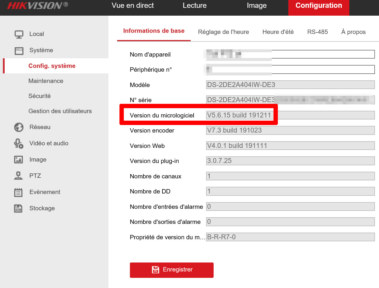

I correctly update my DS-2DE2A404IW-DE3 from V5.6.15 build 191211 to V5.6.18 build 210428 (B-R-R7-0), by UK download Portal (instead of Netherlands).
Like my 2186G2, I dont use any more my 7ZIP tool to unzip the firmware, but regular and basic windows tool to open the zip file.
Have good day
