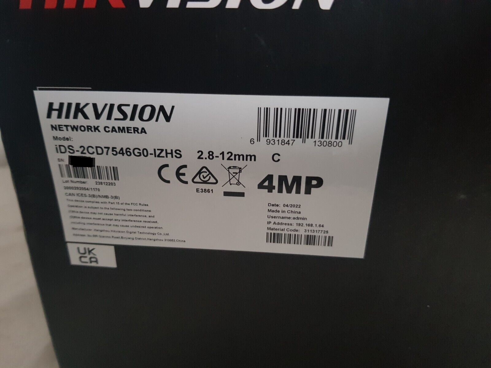

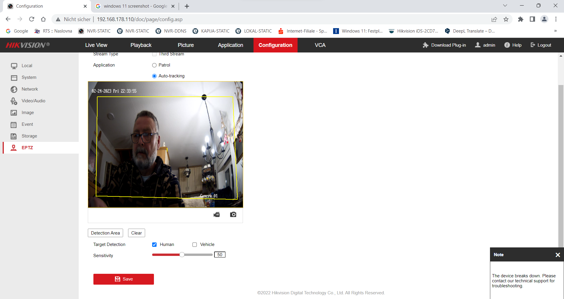

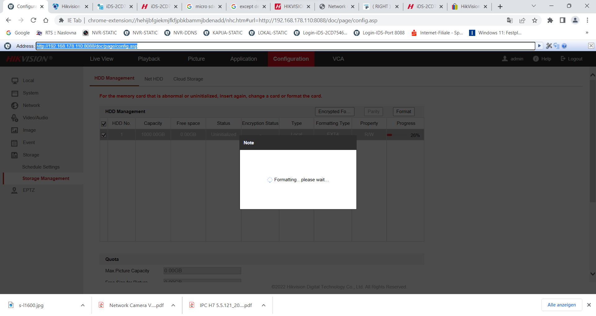

i´ve updated the cam to Firmware__V5.8.10_230220_S3000483188 with success. BUT if i try to enable ( function only in smart event available ) the EPTZ function and check "Auto-Tracking" and then check "Human" and then i try to save the settings a message appears "The device breaks down. Please contact our support for troubleshooting"....the datasheet says you can insert a nicro sd card up to 1 TB...i bought one but tha cam can´t handle 1 TB ( no initializing pssible ) it always stopps initializing at 26%. I realy dont know what to do. I´ve contacted the UK Hikvision support at monday but no response till now. Could you or anyone help me ? Iám really CONFUSED.....don´t know what the correct Datasheet or Firmware of my Cam is. In thr screenshots below you can see the Problem with the Auto-Tracking Function and i send a screenshot of the original label of the cam.

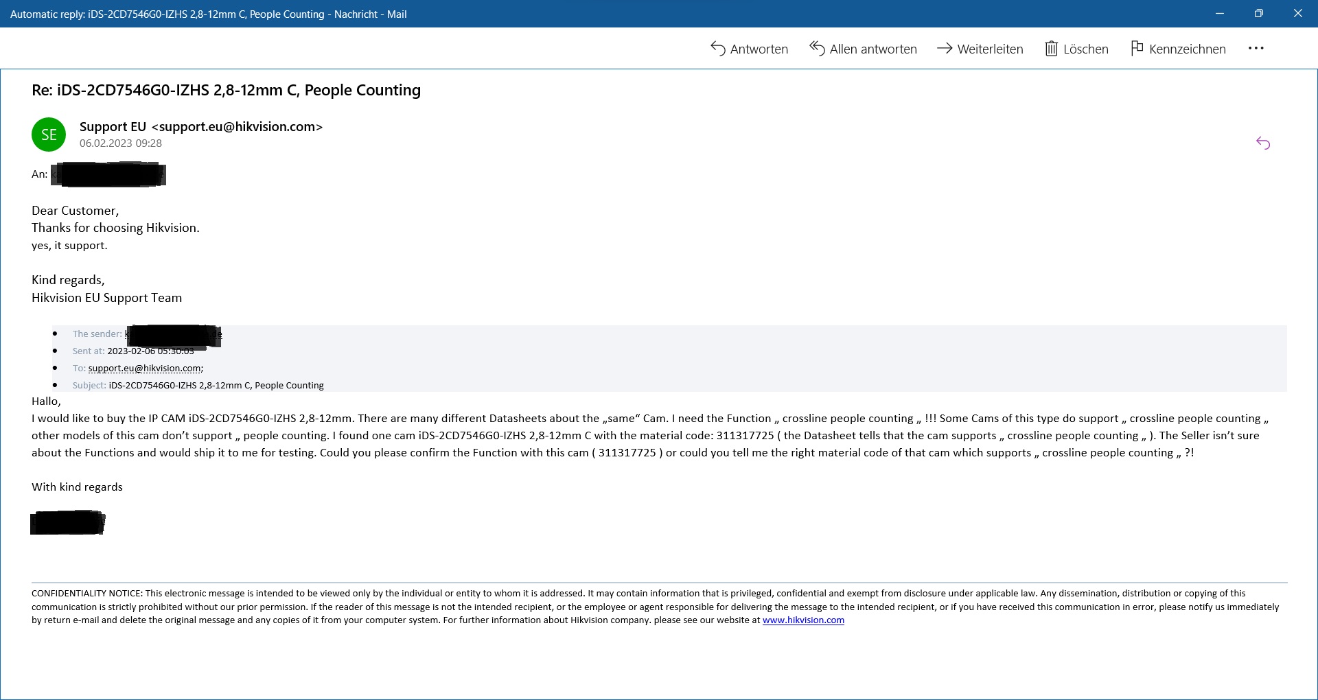

before i bought the cam i asked the Hikvision support if the cam-version with the material code: 311317725 is able to do people counting, they told me that this version supports people counting.

does the cam have a malfunction ( Auto-Tracking issue ) or do i need another firmware or did i crash the cam with the wrong Firmware ??? I'ám totally at a loss. So please help me if you can.

Hi Gagi, support recommened to factory default camera if you haven't done it after FW upgrade.

You don't need to have old FW. Just do factory default now. camera will go into inactive status and default ip address.
Hi Kamir ZG,
i made a factory default reset....power off...press reset button....power on, hold the button for min. 15 seconds...then booting. Try to enable EPTZ....ciribu-ciriba...EPTZ ( Auto-Tracking ) works fine. You´re the only guy who tried to help me. Kapa do poda ( means my hat to the ground --- RESPECT ) for you KamirZG.
