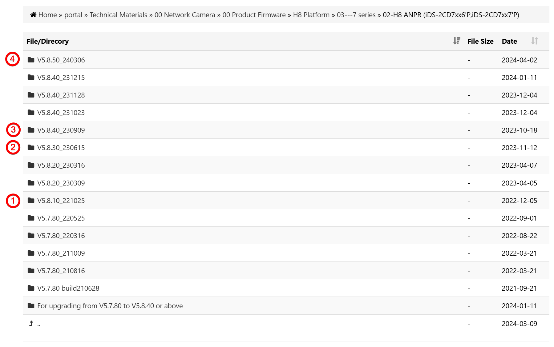

Hi, I'm searching for some legacy firmware for a Hik iDS-2CD7A26G0/P-IZHSY with out much luck for a cam on v5.7.80 and i'm trying to get to latest: (v5.8.60..) version. I read on the Hik pages you should ascend in steps to higher firmware and you can't jump up quickly, my version seems fairly close to the current but i'm still new to this.. I had no luck on the Eur or UK Hik site, the legacy page on the US site only had the current version from what i could see.
Can anyone steer me towards where i might find those firmwares or does anyone have the old files knocking around please?
No problem! It'll probably take a while with the file sizes, so best of luck!
I've had no luck despite repeatedly trying unfortunately. I tried the suggestion of no1 (V5.8.10_221025) which I can see is the next sequential number available above my existing firmware (V5.7.80 build 230712) but just get the 'The type of upgrade file mismatches' error each time. I did try other versions also but still the same message unfortunately.
I notice the list didn't have my exact current version number listed (V5.7.80 build 230712) but assume it doesn't carry some in between releases possibly?
Hi, yes i do follow the steps in the link above exactly as set out. I've been fine with my other (similar) cam in applying new firmware (though not as far back in date) but after a reset on this slightly older cam (same model) i've been struggling for a couple of months now.
. J'm trying to start the upgrade path upgrading to 5.8.10 over my existing V5.7.80 build 230712 which Kyle kindly pointed out would be the next logical upgrade am that looks correct in principle. I've placed the digicap.dav in my route folder out of it's zip but it still shows the mismatch error.
I've tested the troublesome cam overwriting it's (old) current firmware (not on the legacy list) so i know the process should be possible but i'm at a loss how to approach this now. There are 2 types of my cam in relation to zoom lenses (i own both) . The legacy download page is definitely the one for my cam i think I don't know what to try next really.

I got it working, TFFT. Stupidly I hadn't checked thoroughly as the legacy page I initially got steered towards (in good faith) was the Netherlands portal and seeing EU on the page i thought I was in the right place but I just realised there was a UK equivelant and i'm now getting the updates at last. I can't believe I didn't check enough. :-)
