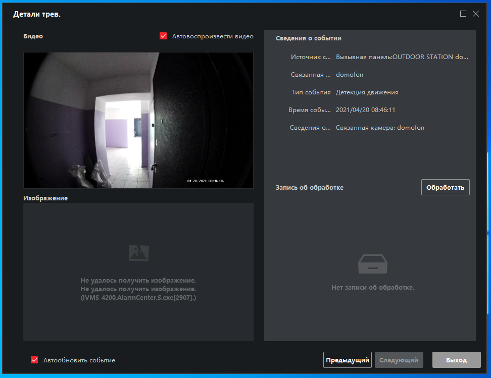

Maybe I'm doing something wrong
Error, does not allow to receive the image
If you look under the Log Search tab in iVMS-4200, you should find small (and distorted) video recordings of motion events from the door station. You can't save them, they're misshapen and it's weird that they can't be displayed as regular motion events.
