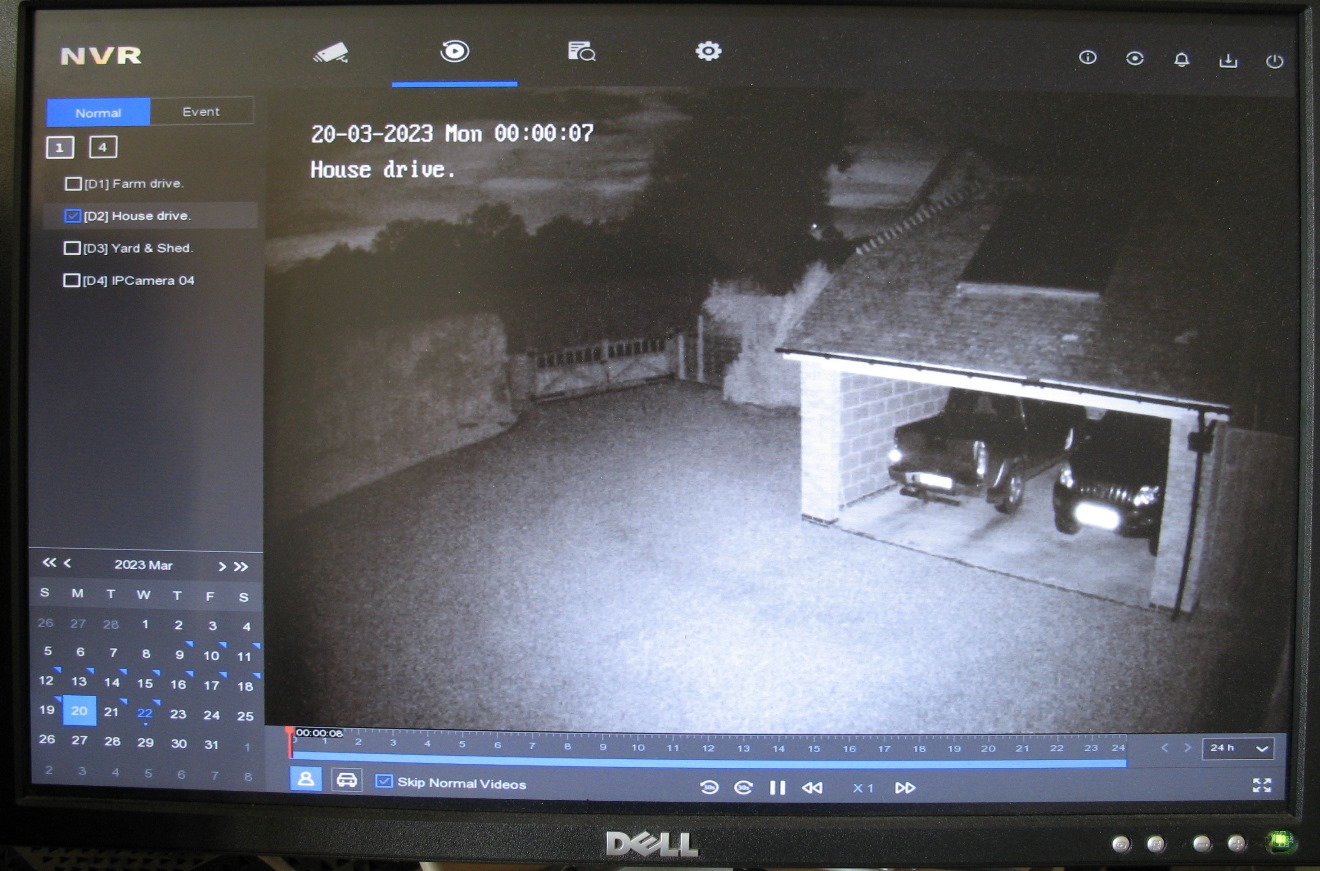

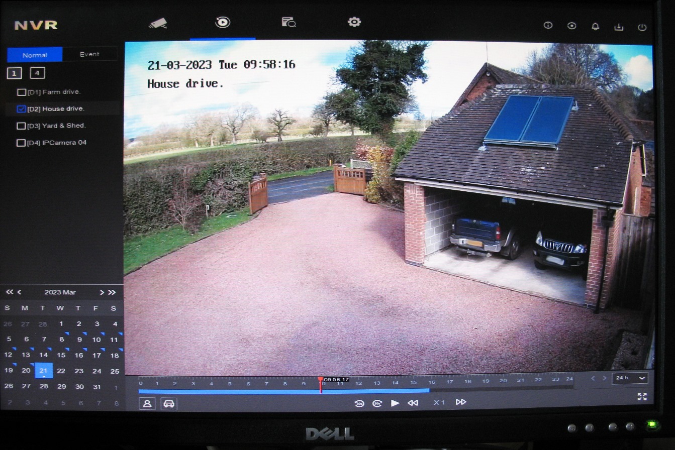

Two last points as I think I've exhausted suggestions:Thank you. I clicked Event, made sure that I had a camera selected, double clicked on a relevant date, and then hovered around the timeline and found the "Space Rule" option. I clicked that, selected the "Line Crossing" option, drew the line and then clicked Search. The red Time Line marker never moved.
I also tried the same procedure with Motion Detection and Intrusion Detection but still didn't get any results.

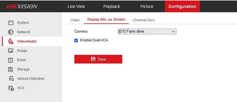

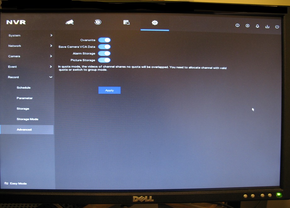

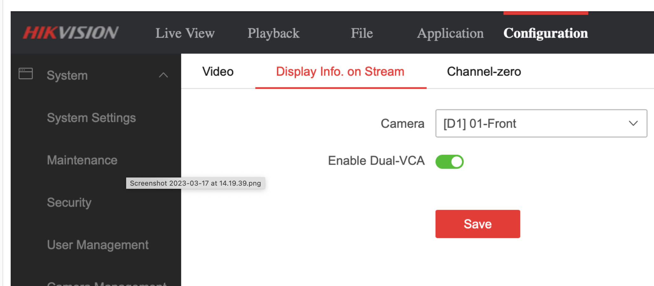

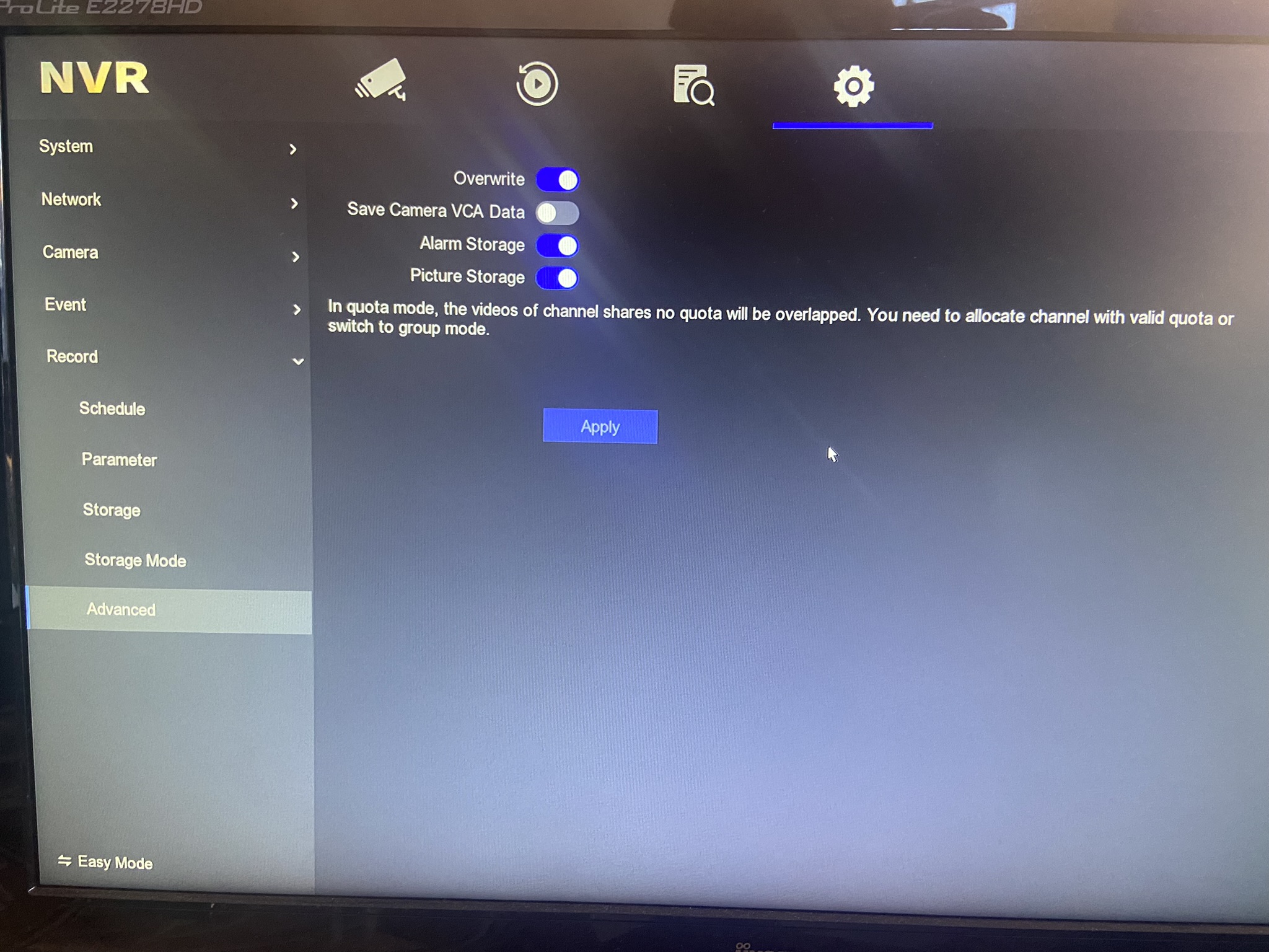

1 - Did you try disabling re enabling VCA on each camera as I suggested in post #12 and again in #14? Reading through the posts it seems you disabled/re enabled "Save Camera VCA Data" which is different. There's an option per camera to enable the VCA data to be sent as I showed back in post #2. "Save Camera VCA Data" controls whether the NVR saves what it receives.
2 - Do you have motion detection or line crossing enabled for the cameras? It used to be the case (may not be now) that in order for a VCA search to function, the specific function had to be enabled in the camera. IE you couldn't do a VCA search for motion detection/line crossing if those functions weren't enabled in the event settings. To prove that just enable motion detection full screen for one of the cameras and don't alter any other options. Also set a line crossing alarm across your drive and don't alter any other options. Wait an hour and do a VCA search for motion/line crossing on that camera.
