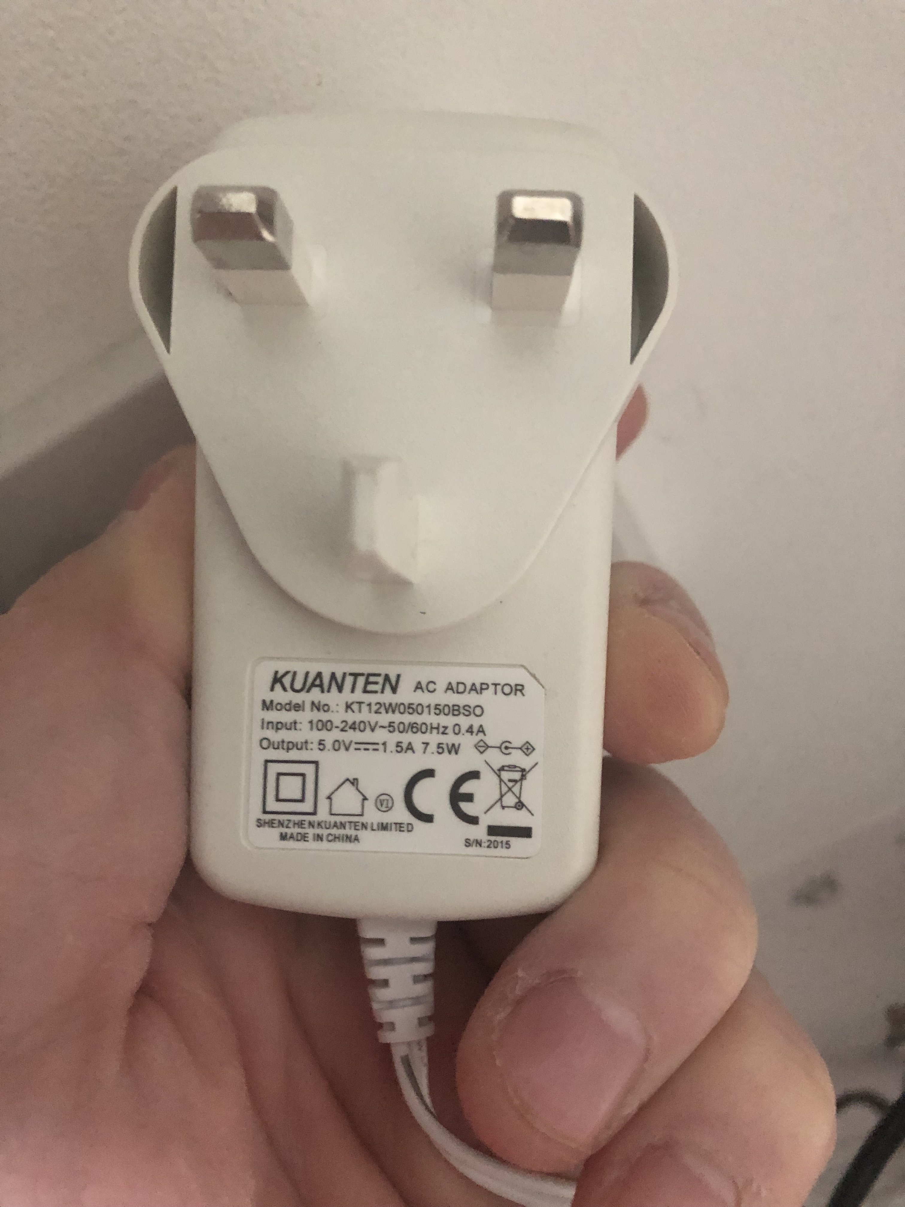

Did the AC adaptor come with the camera or not? Can you please confirm the specs of that AC adaptor? (a photo of the technical label on the adaptor will do)

The ERA camera model just seems to be referred to as the ERA Protect Wireless Outdoor Security Camera (Link to ERA Site). The AC adaptor comes with the camera and is a 5V, 1.5A, 7.5W unit (image attached). All cables are factory made.
