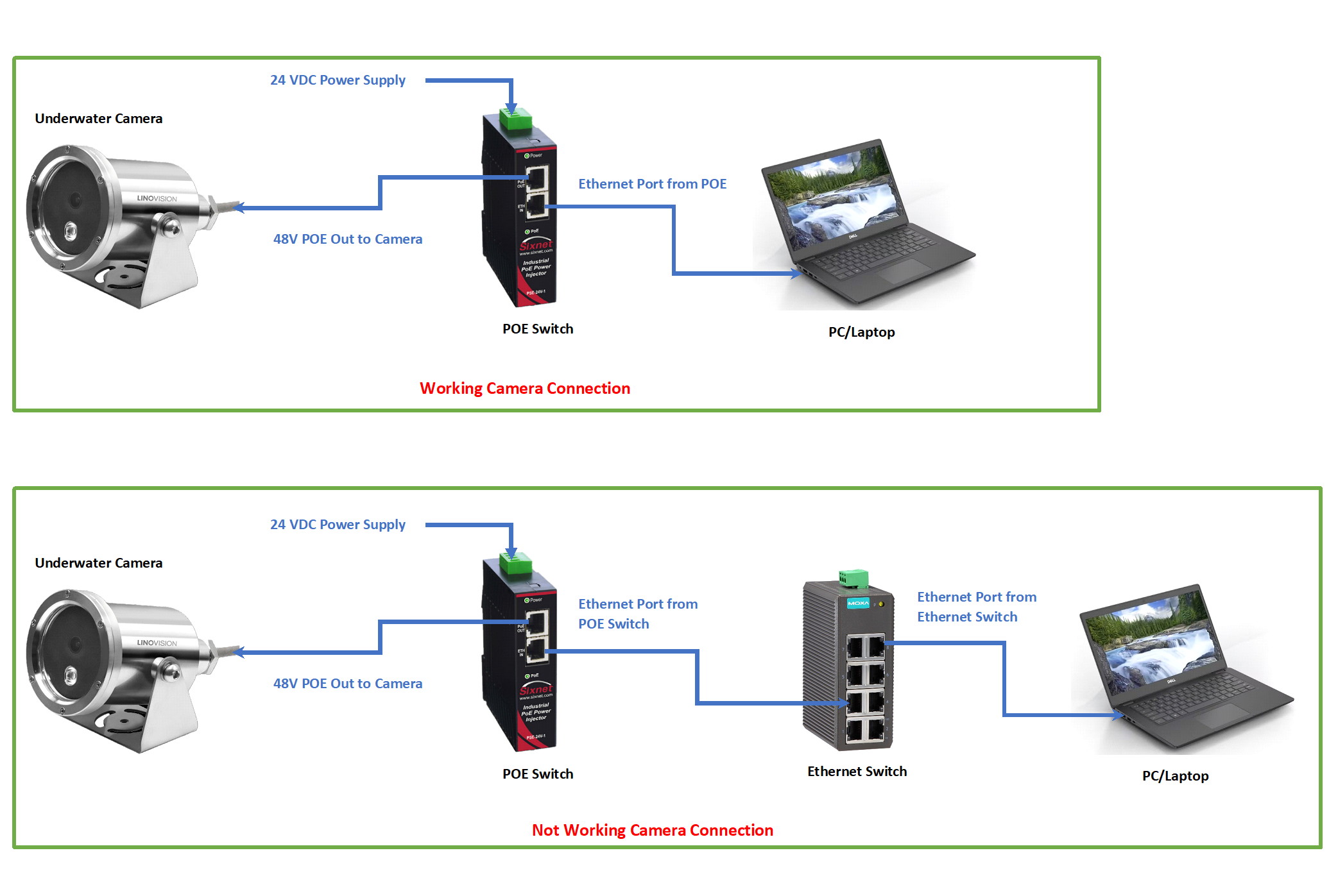

We are facing an issue with our Underwater Camera - (Linovision IPC608UW-10 with 75meter cable) with POE and Ethernet Switch.
Camera is powered by POE - (RedLion EB-PSE-24-1B, Single Pair 4wires) and camera was working well with this POE port and its Ethernet port only.
When we connect the POE's Ethernet port to an Ethernet Switch (Moxa - EDS 208 & Siemens Scalance XB005) for including this camera to a common network to monitoring the whole system. We cant able to ping the camera.

Camera and Cable are ok. Because when we use the same setup with POE switch it was working.
While we connect the Ethernet switch to the POE's Ethernet Port then only it was not getting the Camera.
Please see the Attached image for more clarification of our issue.

Ethernet switch was the existing one.
Our camera and the POE switch is the added newly one. In the existing system there is no routers to managing the network address.
We will try SADP, but the thing is camera has a Static IP, we only configured the Camera IP to static and it was working with the POE switch directly.
Our only issue is through Ethernet switch we cant able to get the camera?

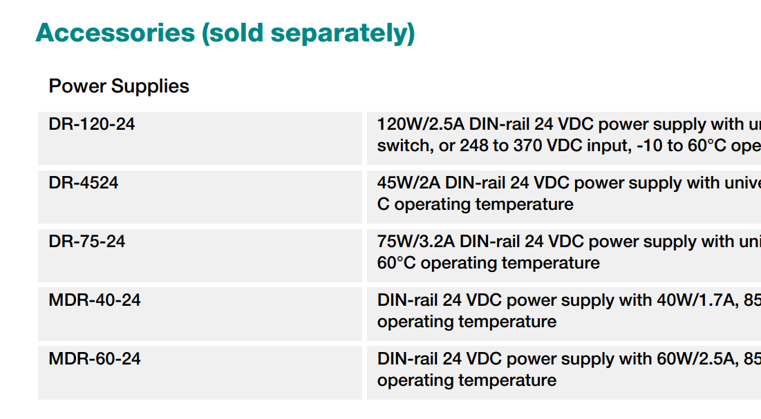

Are you using one of Moxa's recommended PSUs to power the switch?
It seems to be quite power-hungry

We have a separate power source from the Battery Banks, 24V...
The Moxa switch is working good... We checked internally.
