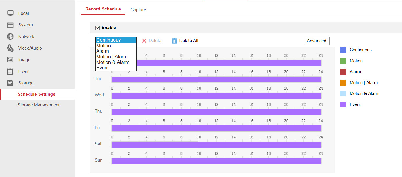

Hi Phil,
This camera model doesn't have Edge storage option, even though it has other options
