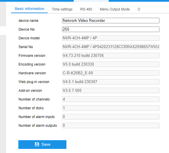

But im having some serious difficulty on setting up the devices on the Basic/Advanced settings.

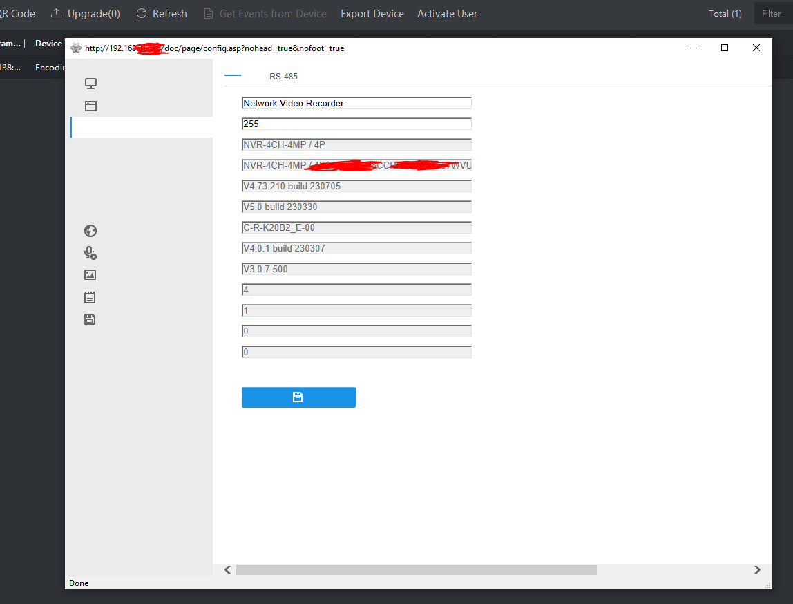

The page (either on the nvr system via iVMS 4200 or on the web browser) it shows, lets say, almost nothing...
This is what i see, and im pretty sure it should not be like this
Since page shows like this, im not able to control, led lights, alarms, schedules, etc...

Yes the result is the same even on IE mode (assuming you are asking before the update from IE to edge correct?)
I sorted the issue - by right click, and translate to english...
Apparently the page was showing a mix of simplified Chinese with Polish...
Anyway i can update the firmware of flash into it ENG language?
When i search for updates it tells me its the most recent version... but, im finding that hard to believe from other photos/videos i've seen online, this version feels clumsy/unfinished
Many thanks

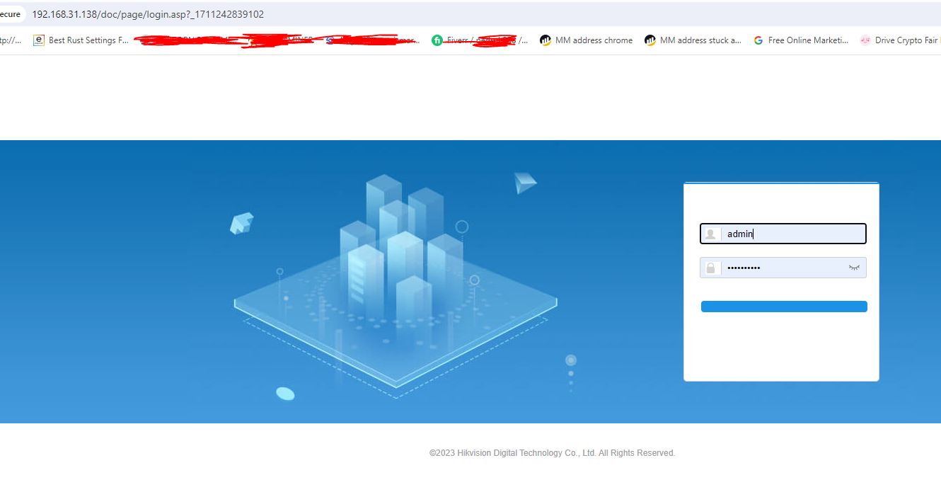

Even the login page on the webview looks... lets say clumsy :(
There is no option to settings or anything... Its far different from all the tutorials and videos i saw online
