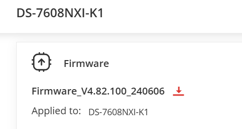

Firmware Accusense K Series new Firmware_V4.82.100_240606
MatPol
New firmware for all Accusense K series NVR

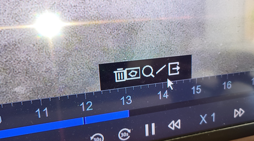

Also the Playback-Normal search issue with search by rule buttons(overlapping or layering over others) became worse and daily issue. Sometimes I need to reboot....

About the buttons "mixture"(icons overlapping or layering over others) that sometimes makes selection impossible in Playback Normal, I would like to mention that by changing output resolution from 3840*2160 to another lower resolution of 1920*1080 or 1280*720 the issue disappears at least for that moment. No need to reboot or perform a by Rule search on Playback Event. So high resolution(4K) is possibly using high graphics processor power and causes this kind of artifact.
I shall test and inform
Draw the searching area and Draw line Icons, overlapping or layering over others(Search, Clear and Quit), has stopped after HDMI output resolution is changed on other than 3840*2160.
Working now on 1920*1980 on my 4K TV for more than 3 days.
