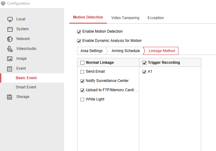

The newest version does not support white light linkage for event
My ColorVu DS-2CD2047G2-L (G5 platform), has this option on both Basic events and smart events. Of course no option for audio in - out.
Firmware is the latest 5.7.14_build 231213
I don't know if you mean this:
Yeah @alfaclvi. At one point there's a version (or two) of firmware where the G5 LSU/SL model has the same 'White Light' option as the L(U). However Hikvision have removed it in the LSU/SL presumably as it has a strobe light that can be activated on event (the flashing light can be configured to be solid on rather than flashing) Even though the model variants use the same firmware file, the option no longer appears on the LSU/SL variant. As said, the strobe light can be used to come on without flashing but it is not as useful to provide illumination for the exposure, as it's a single LED (half the power) and is cool/natural white rather than warm white.

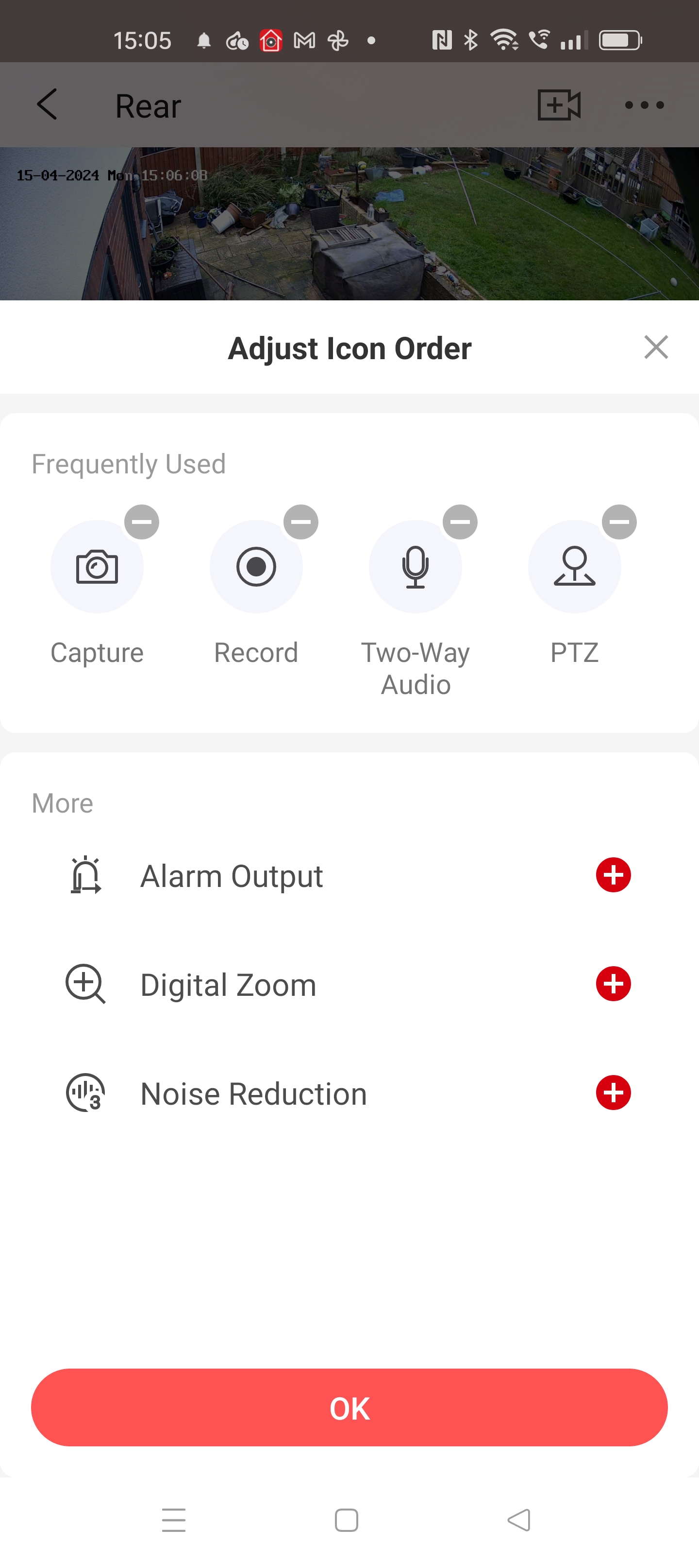

In the hik-connect app I am not sure where to manually trigger the strobe / alarm - when I go into the camera I have icons for pause, volume, HD, split windows, and rotate screen (top row) then icons for playback, capture photo, record, mic, PTZ control, noise reduction.
Click the little arrow beneath the snapshot (capture photo) icon to reveal the rest of the icons including Supplement Light Config, Strobe Light Activation, Siren Activation. You can rearrange the icons so that the ones you want are available first (there's little point of a PTZ icon visible if you've only fixed cameras)
I have the smart light configured which does appear to work for me (in that it's configured to use the IR until a trigger then the hybrid light comes on) - I havent tried any other configs.
Yes it will work. The bit that's faulty currently is the ability to switch between the modes (Colour, Black & White, Smart) directly from the app icon.
Thanks, however, I only have the icons I mentioned. See attached.
How is your Hik-Connect app configured to access the NVR? Some functions such as Push notifications, event clips etc are only available if you're using the Hik-Connect service (unavailable if you have the NVR added using IP/Domain or local device)
To be honest, I am not sure - an installer put the cameras up, NVR and basic setup. I did all the config for alerts, triggers etc.
I do get a push notification when an alert it triggered - 4 cameras in total with a mix of intrusion detection, line crossing - all send push notifications. Under notifications I can click playback and clips seem ok.
I intend to go back to the installer but when I found this thread I thought worth seeing if I can find the issue.
I have two of these cameras and both have the same issue.
Cheers,
If you get notifications then the NVR is added to the app using the Hik-Connect service. I can't explain why you're missing some of the icons. If you have a camera that has a speaker and strobe light, there should be icons in Hik-Connect to trigger those manually if needed and you should have an icon for configuration of the smart light. Unless there's some issue with the firmware for the Hybrid cameras featuring Live Guard (speaker/strobe) that's making those icons unavailable. Although I have the same NVR/firmware and Hybrid (G2H) cameras on the same firmware, I don't have any with the speaker/strobe (mine use the same firmware but are standard ColorVu) so can't advise.
