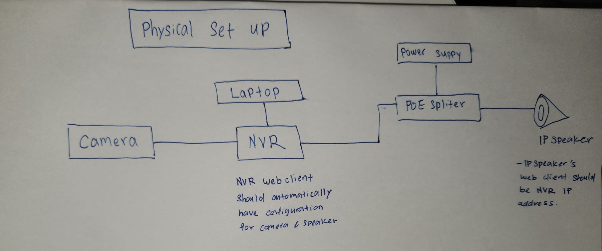

I am currently developing an .NET MAUI mobile application and I want to integrate my HIKVISION IP speaker with my mobile application. The features I want to implement are:

I have attached my actual set-up of my devices. May possibly not include the camera in actual setup if not needed for my implementation.

Hey, look on github pages, there are lot of examples how to use isapi with two way audio from hikvision
I use Home Assistant in combination with go2rtc, go2rtc has a script to enable two way audio
or alternative, you can use the SDK too from hikvision
here is an example on my github page to send one way audio to hikvision device:
