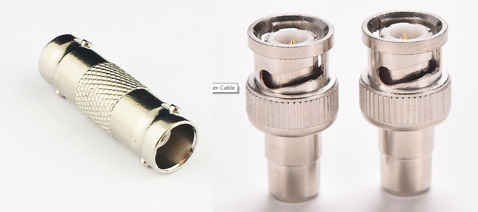

Hey, thanks a lot for the reply. Attached are a couple of images pulled from their website.
It would be great if I could just buy another box, plug these in and get a more reliable system!

Looks like standard analogue CCTV.
Which is the same for all brands.
e.g. composite video 1 volt peak-to-peak
There is a slim chance that it could be HD or some other variant - please provide a link to the manufacturer's product web page and I'll take a look and check for you.
