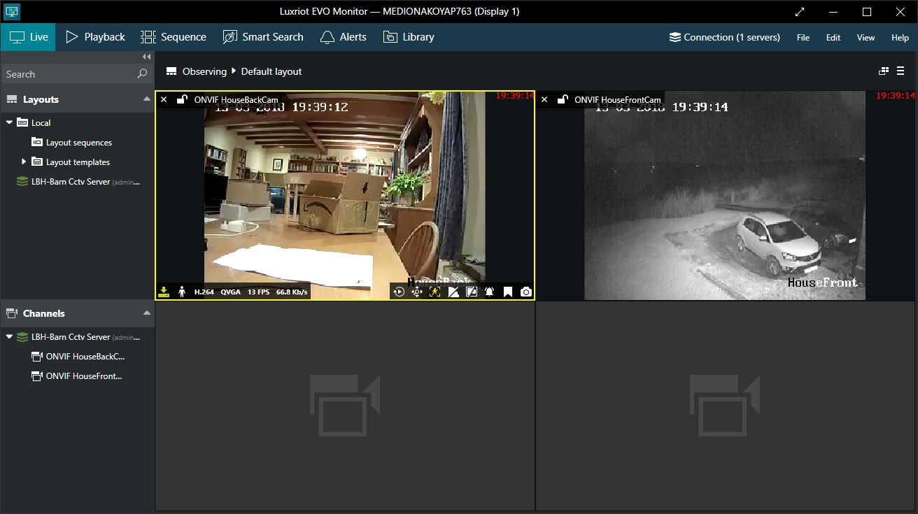

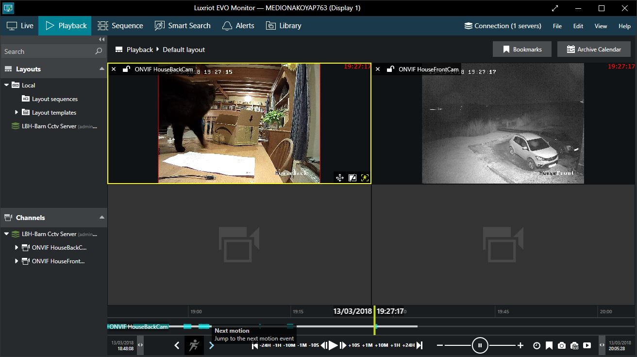

The free Luxriot Evo fits my bill (sort of) - it ran on all the test PC's/Laptops and recognised the Hikvision's and used their motion detection.
Here are a few screen shots:
and a nice article on it: Viewing multiple Sharx Security cameras with free Luxriot EVO software – Sharx Security Blog
