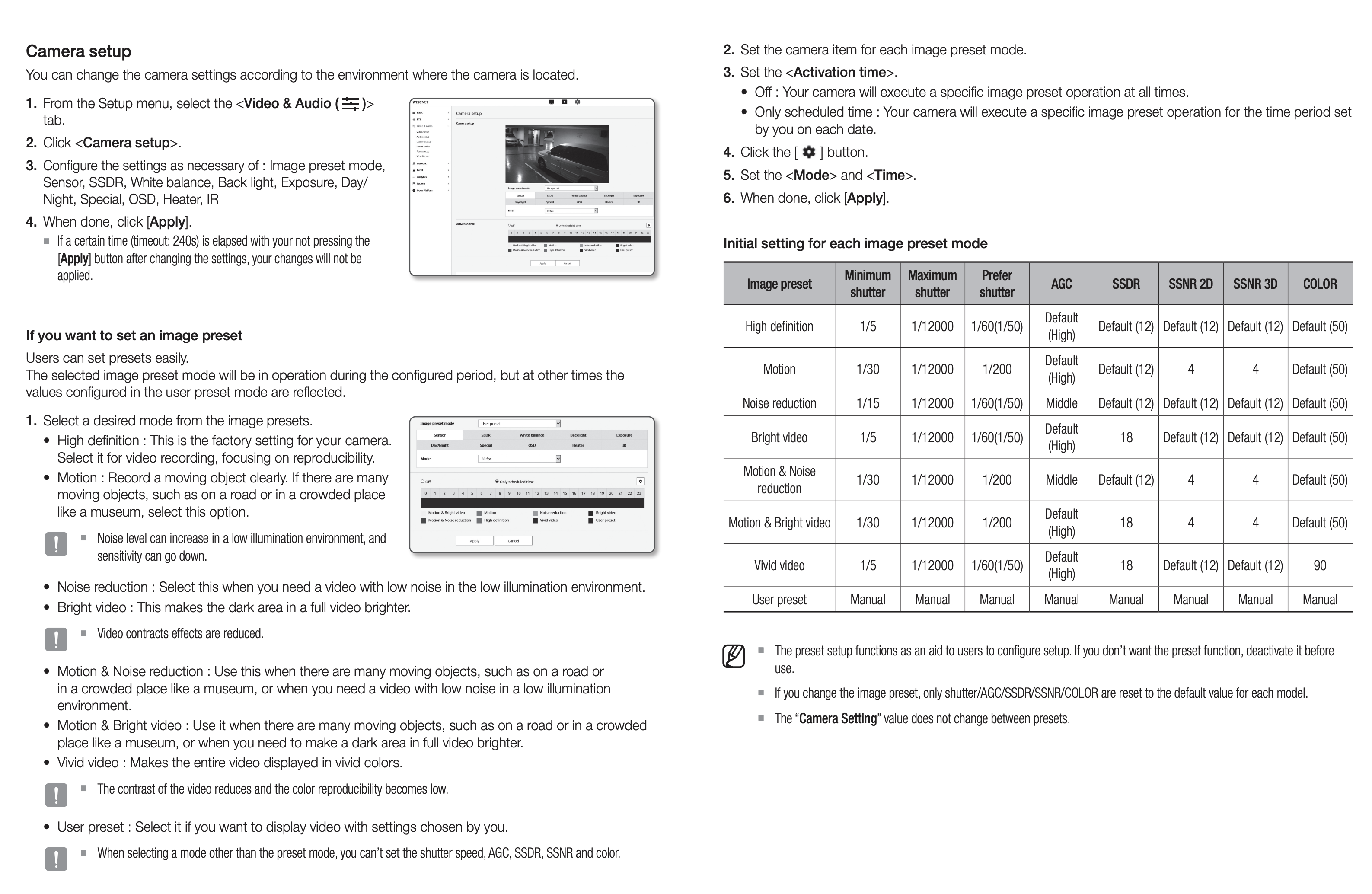

I've had a look at the camera user manual and it looks like if you go into the settings via a browser and go to Video & Audio > Camera Setup you should able to set the FPS under the Sensor settings (see below screenshot from the manual).

Hi Dan , thanks
thats the same image wisenet sent me but you cannot get those options up without connecting to their app and using a dongle on the camera ,
thats what their technical team told me thats as much info they would give due to fact they dont give any help to end users !
i can see most of those options except the option yto change the FPS which is defaulted to 25fps and greyed out.
okay, have you tried changing the Image Preset Mode to User Preset? Is the FPS still greyed out when set to User Preset?

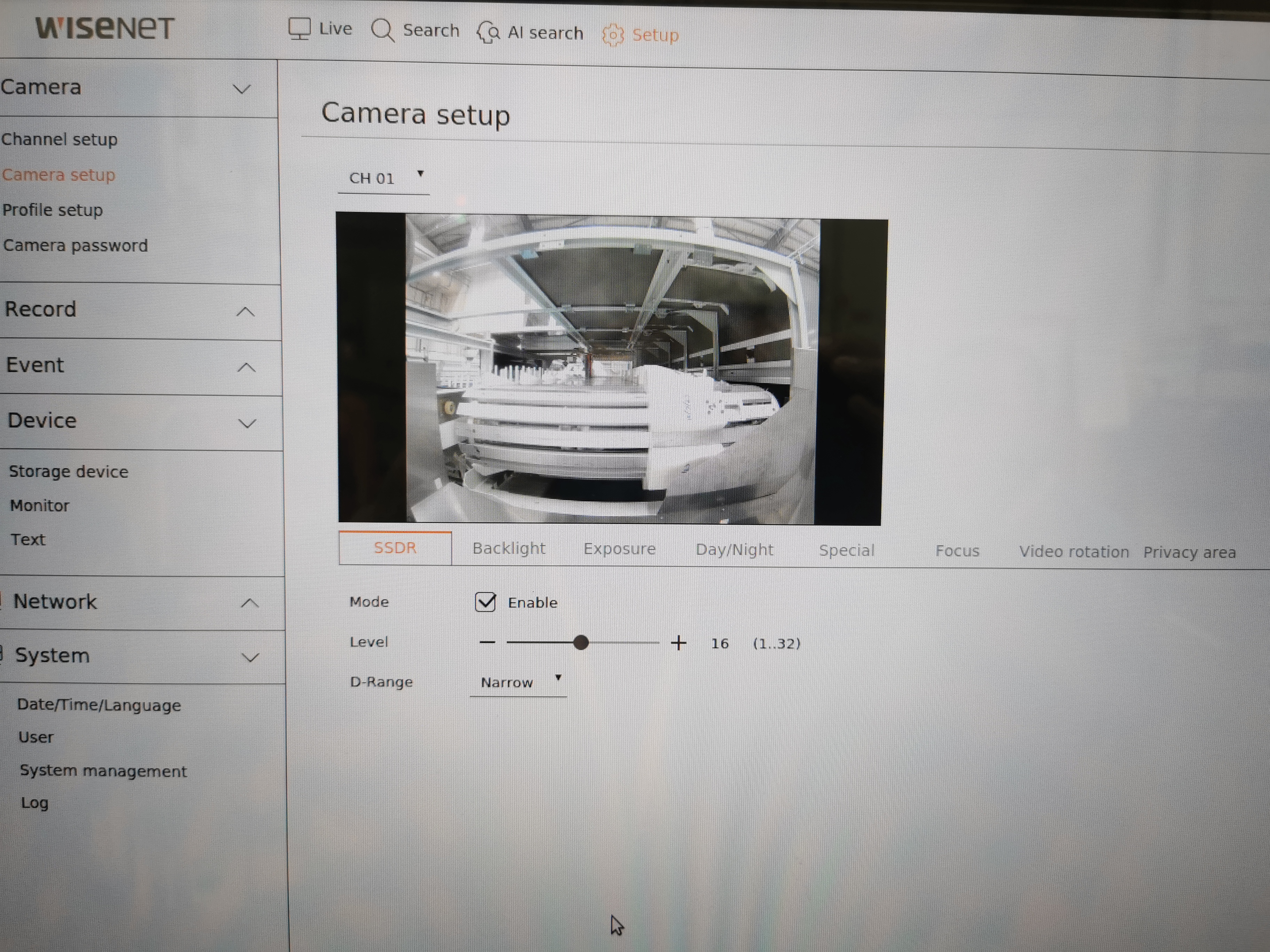

The options are different on NVR, I can only assume they are different when connected via their app and using the dongle to connect, but hav tried all options and settings via the NVR

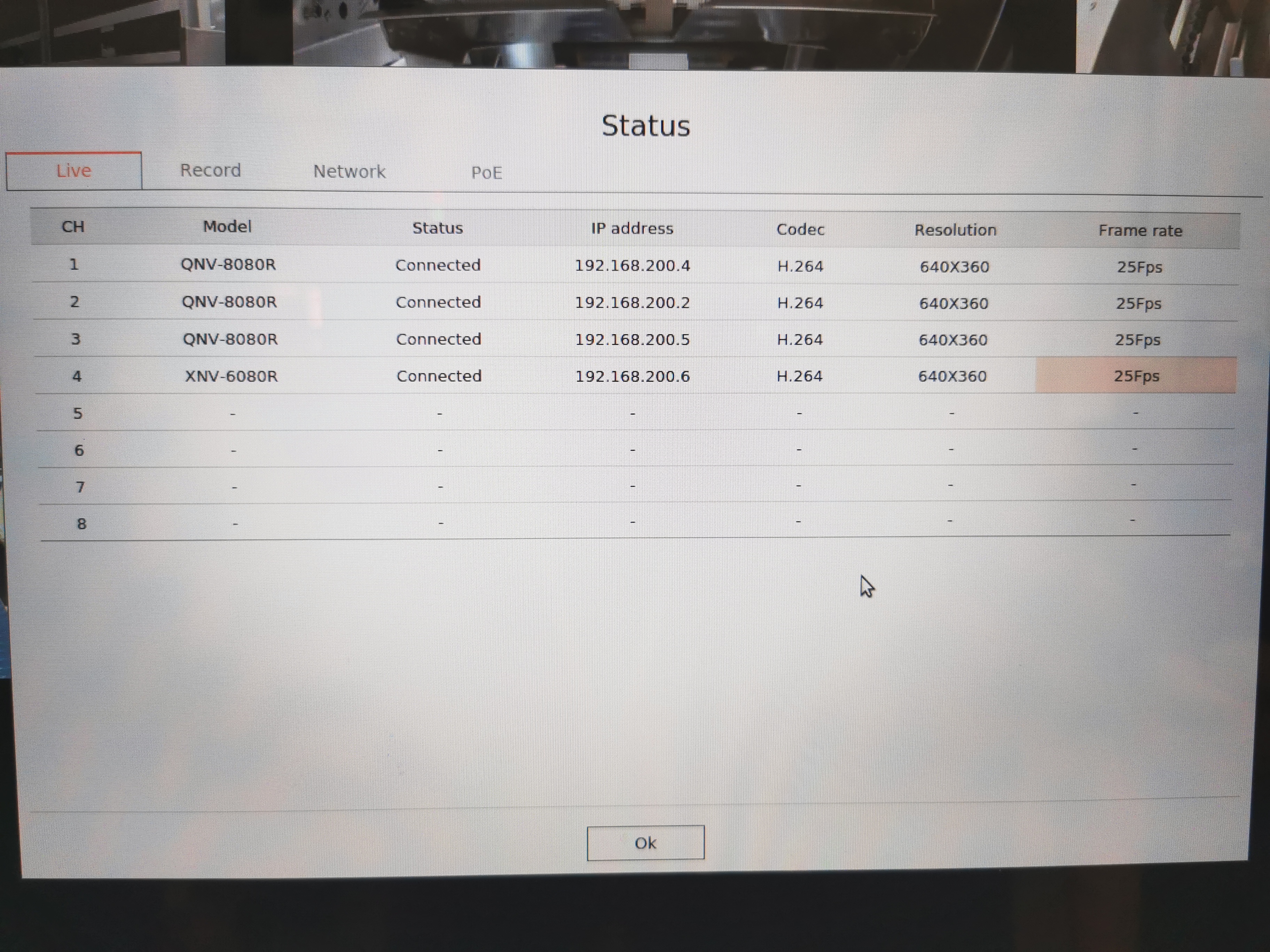

Hi yes all plugged in as per image, that image is from the NVR

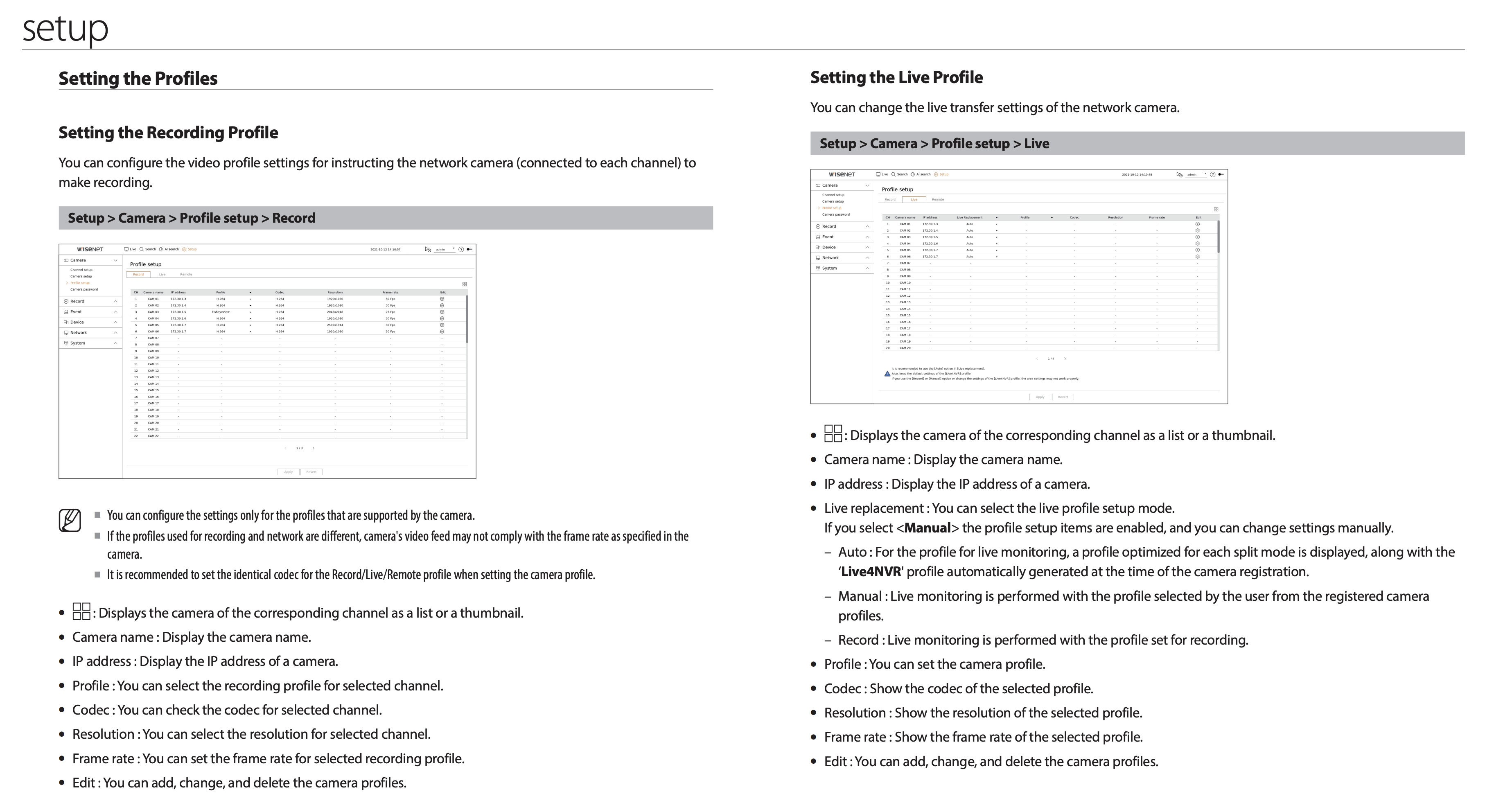

In the NVR settings under the Camera Tab have you checked the settings under the Profile Setup menu?
Profiles are the package of settings applied to the different streams for live view, recording, etc...

Are you sure you've checked that Profile Setup menu?
The user manual for the NVR says this is where you set the FPS/frame rate for the recording & Live View streams (see screenshot below).
