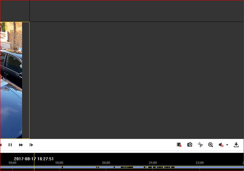

So I investigated much more closely the recordings of this camera and discovered its image gaps were worse than I had thought. You can’t see these as “black gaps” on the playback screen because of the scale on the time axis. However, there are skips of about half-a-second to a second going on regularly. Also, when I create an intrusion alarm, the event almost always triggers a loss of video, which then takes anything from a couple of seconds to a couple of minutes to reappear. The impact seem to vary with the scale of the moving intrusion, but haven't tested that rigorously.
