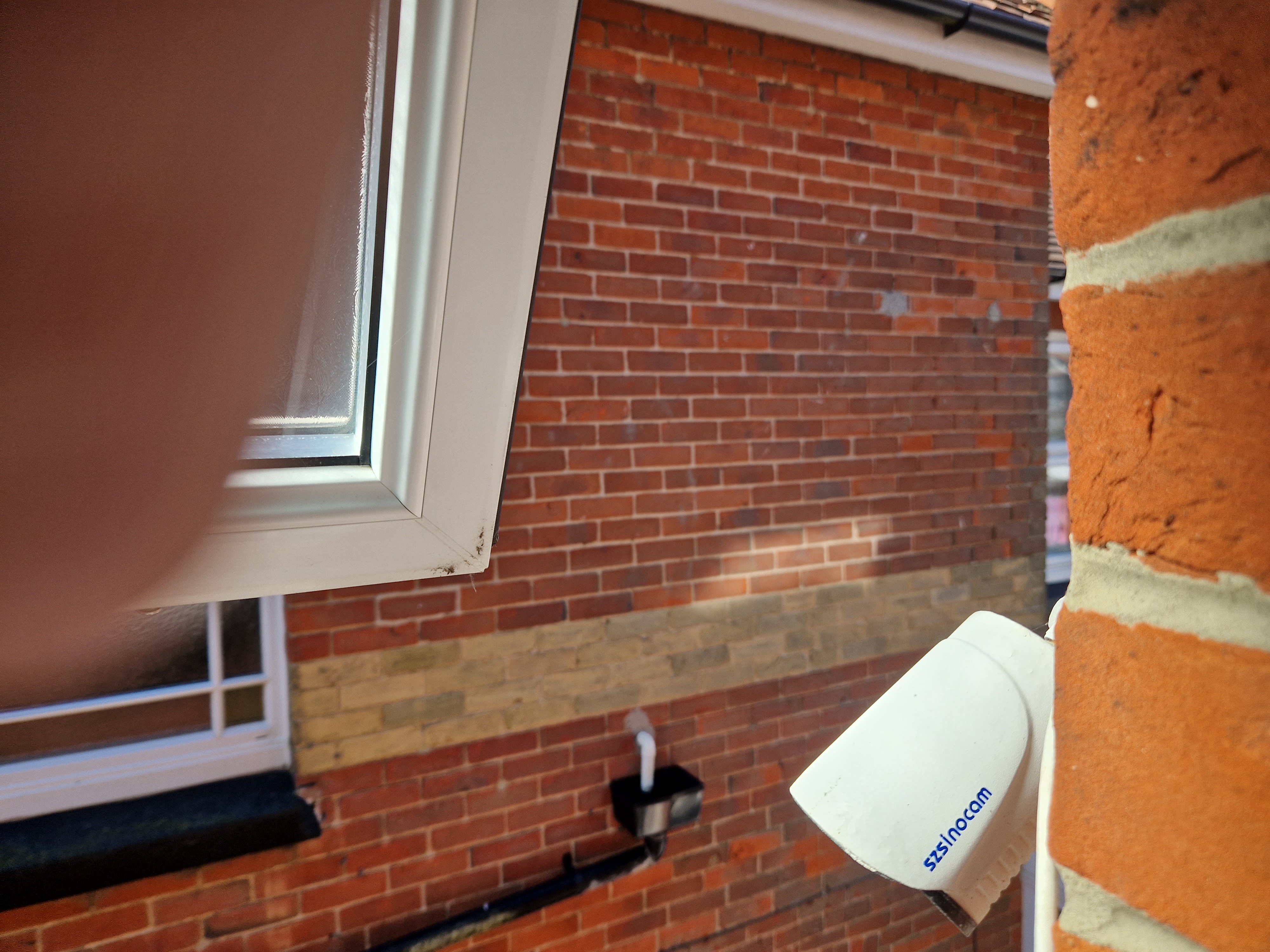

I don't know the model number, but these are the cameras.
okay,
I can't see this exact model on Szsinocam website, but some of their other bullet cameras do support 64GB MicroSD cards so it may be possible to run your cameras on their own using MicroSD cards but the only way to be sure would be to take the camera down and get hands-on to check for the card slot.
