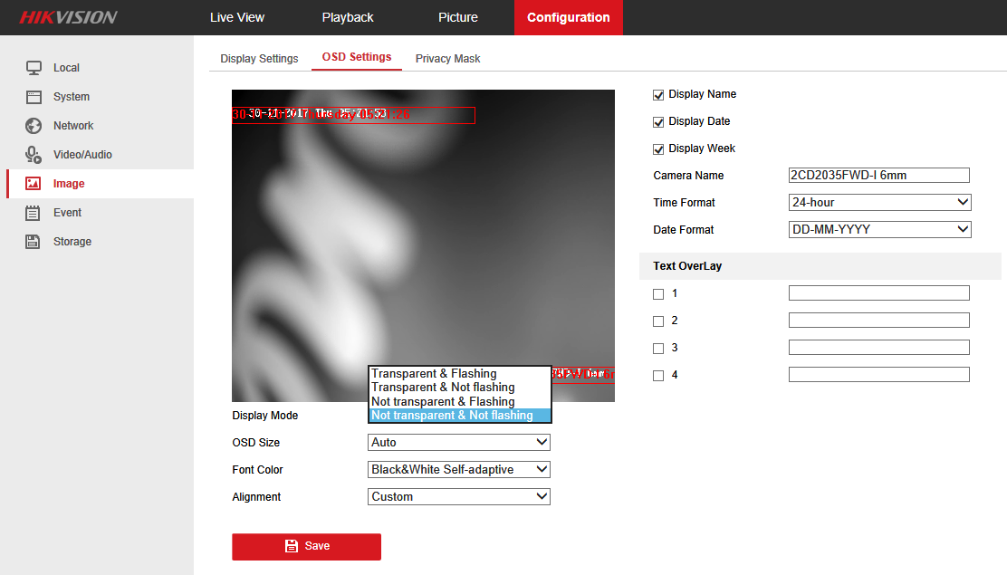

I believe I have solved it by logging in and changing the time and date background colour to transparent. Not sure what is should be but this seems an obvious choice. Seems to work though!!
Sounds like it had one of 'those' moments perhaps??????
Well done, glad you've cracked it.
Below are the default HikVision OSD settings showing on one of our demo cameras.
