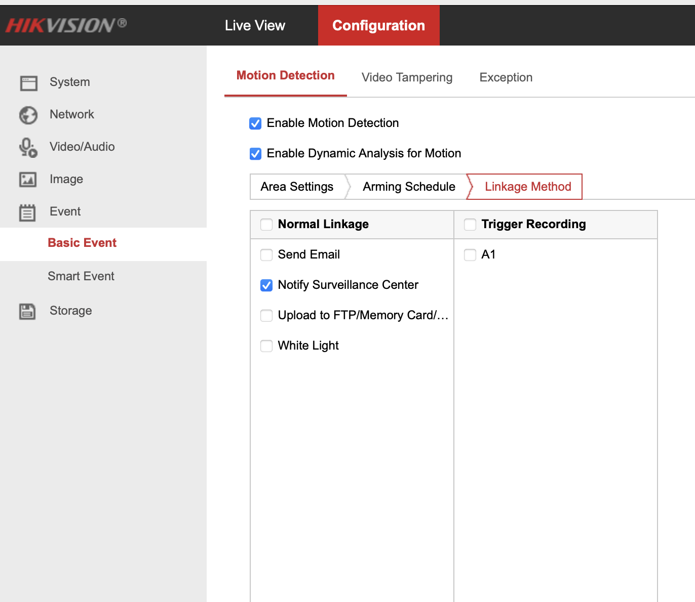

LU (no strobe)

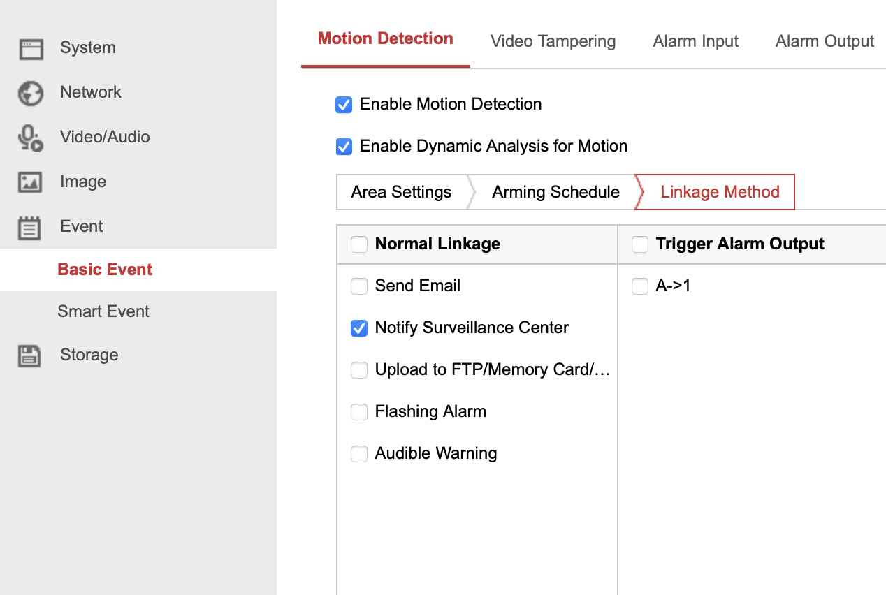

LSU/SL (with strobe)

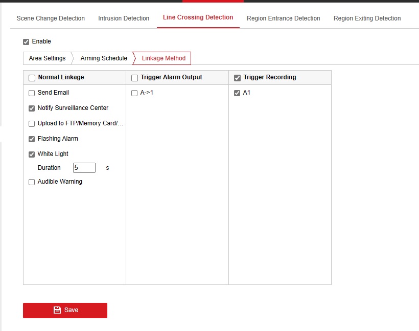

Just to give you an update I have spoken to Hikvision support and they have assisted me with downgrading the Firmware and the White Light option has now been restored.

They assisted with putting the camera into debug mode using some software to connect to it and once in debug I had to send them a hex key. They then sent a password back to me and I was able to send a command to allow firmware downgrades. It was then just the normal procedure of updating the firmware but with the older version. I asked why this white light feature has been removed and the engineer said he didn't know but he knows that HQ have no intention of putting it back in future releases. So it looks like I'm stuck on V5.7.10 Build 220720 but that's a small price to pay as the white light on event is brilliant as it's so bright
