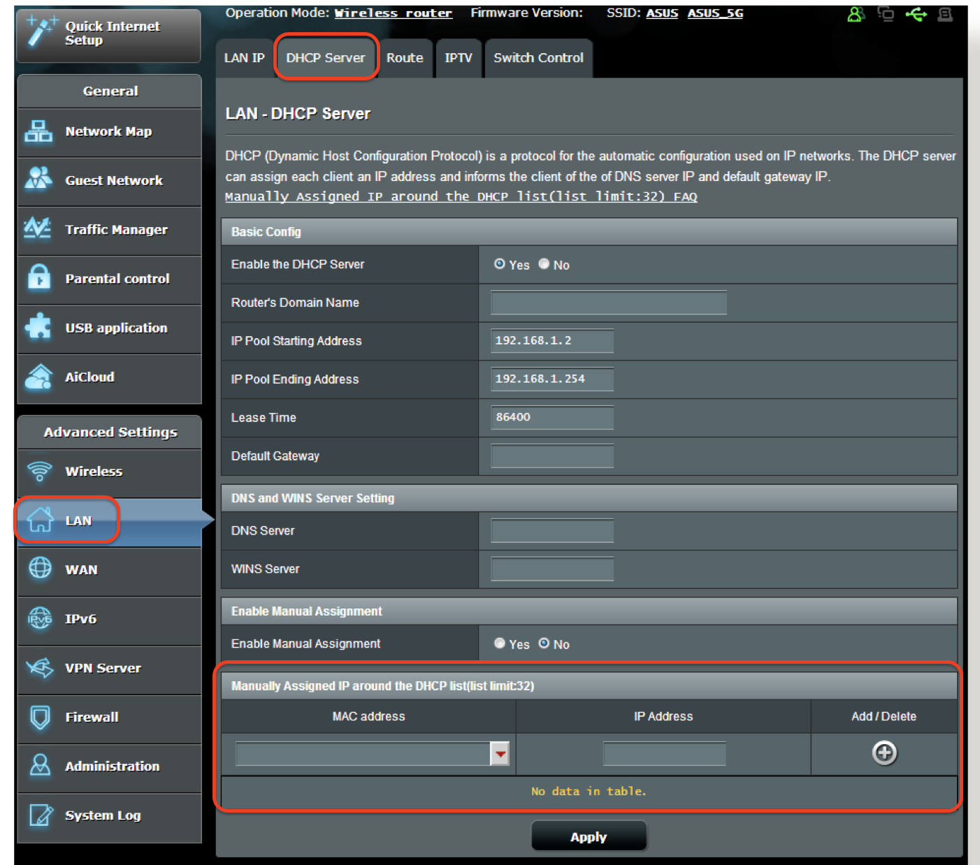

Robint, most modern routers allow you to assign "fixed" IP addresses to devices. This may be found under advanced settings.
Post a snapshot of your LAN and DHCP setup, there could be a range of IP addresses you can used as fixed IP's outside the DHCP server range.

looking at the manual (V3) it is possible to assign fixed IP's to devices.
