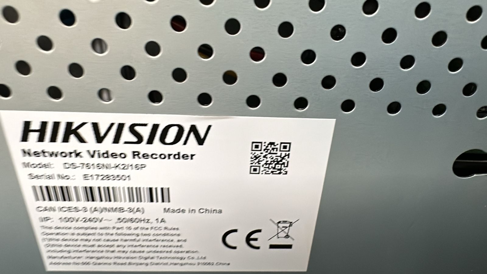

Hi dan,
my nvr model is DS-7608NI-Q2\8P and tried to connect it with camera ColorVu model DS-2CD2087G2-LK 8 MP but unfortunately does not work despite the quality of the image
what is ur advice?

When setting up the NVR did you set a strong password for the NVR/camera activation password?
When plugging the cameras into the PoE ports on the NVR they are assigned the NVRs password or the camera activation password, with certain camera models if this password is not strong enough the NVR will not activate the cameras (which might explain the detecting & password error messages you are seeing).
We would recommend resetting the NVR (and the 2 working cameras as they will need to be reactivated with the new NVR password) and then setting the NVR up again with a new strong password that includes at least 3 of the following - lowercase, uppercase, numbers, special characters - and the try adding the cameras again.
