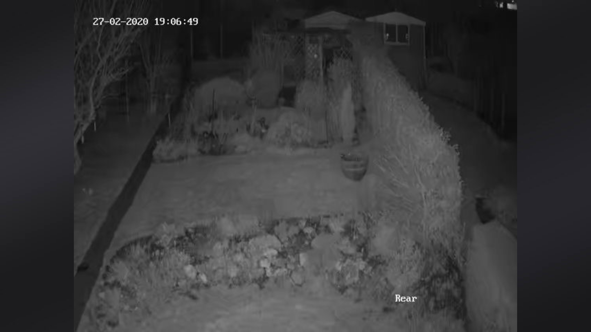

For your info on IR range. This is the image from my 6mm 4mp GO camera. The back fence that is top of picture is 30m away. The camera is mounted at 5m on the wall.
Also pic for comparison showing daytime image
