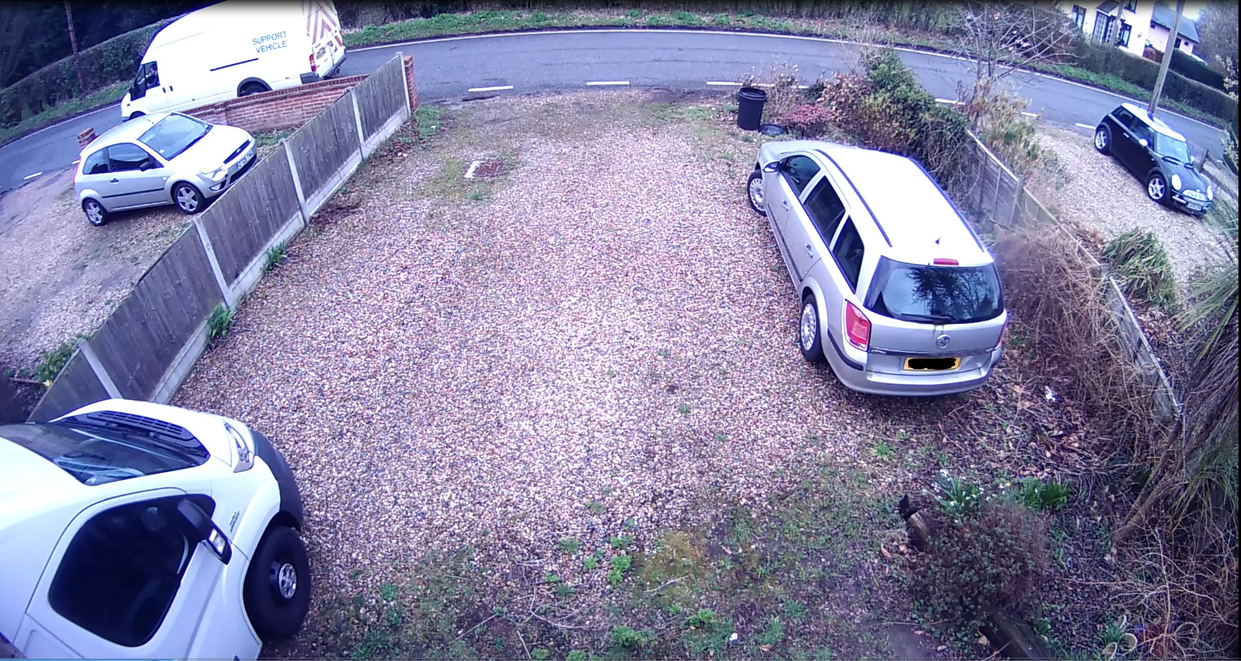

I too would like a recommendation. I had an attempted theft In this picture I could not take the numberplate but really would have been handy. The Vehicle is the transit with 'Support Vehicle written on the side about 20 meters! Thank you. John
Sorry John, no camera will get a plate read at that angle, ideally you need to be reasonably straight-on to the vehicle/plate.
Thanks for the fast reply, there may have been more opportunity as it drove off reducing the angle. I still may replace the front cam, quite a few years old now and no good at night at all!
