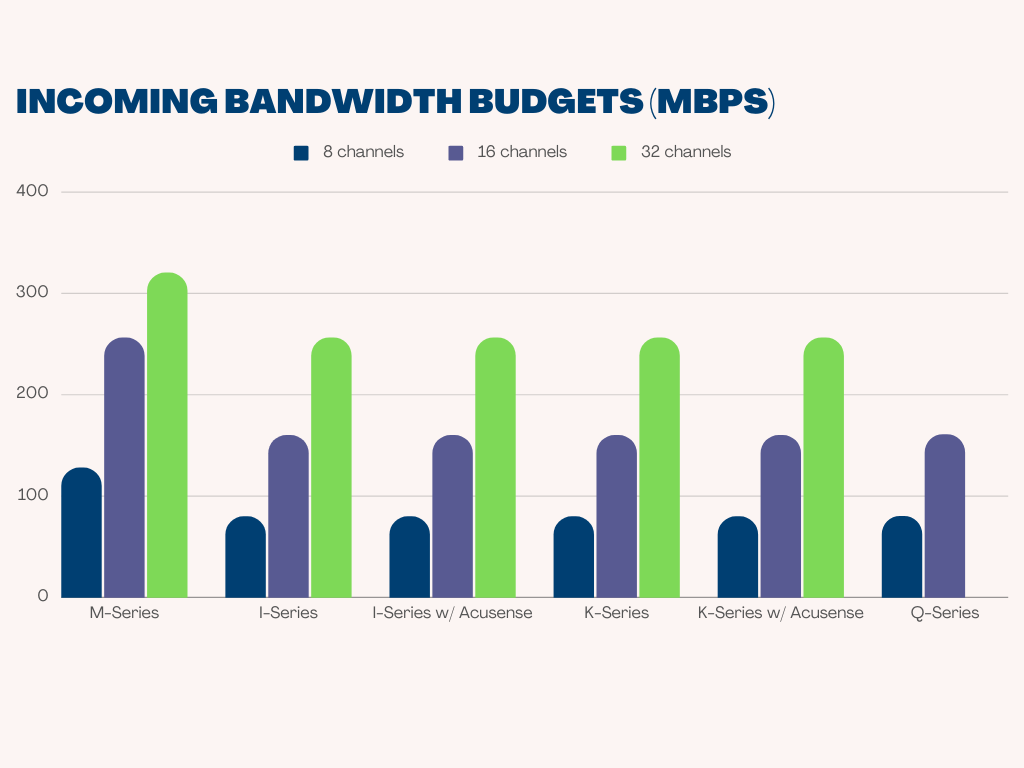

If you are using Hikvision’s newest Acusense cameras, or high-resolution cameras, then one of the most important specifications is the incoming bandwidth budget.This is because these cameras use significantly more bandwidth than earlier models and the older NVRs did not have enough incoming bandwidth to support fully loading them with the new cameras without a major reduction to video settings such as frame rate and resolution, even when you are using the H.265 or H.265+ compression codecs.
The majority of Hikvision cameras now have built-in microphones too, which requires even more bandwidth when audio is enabled.
The key improvement made with the new M-Series NVRs is that the incoming bandwidth budget has been increased, meaning you can now fill an NVR with Acusense or high-resolution cameras without experiencing camera disconnections or unstable footage.
All of the other NVR ranges only offer the bandwidth to add high-resolution Acusense cameras to about half of the channels. So, if you are planning to use new cameras in your system, the increased budget of the M-Series models is essentially vital now.

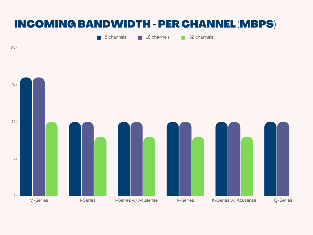

If you plan to use Acusense cameras, then we would advise allowing at least 15 Mbps per 8MP camera, 12-13 Mbps per 6MP camera, and 10-12 Mbps per 4MP camera.
The below chart shows the bandwidth available per channel, but keep in mind that there is no fixed bandwidth budget for each channel, the total incoming bandwidth budget is distributed amongst each channel depending on the connected camera and this is managed automatically by the NVR. So, if you are using an old or low-resolution camera that doesn’t require much bandwidth at all, then the unused bandwidth will become available to any other channel that needs it.
Outgoing bandwidth is another thing to think about, as it specifies what the NVR is able to broadcast to other devices - e.g., if you are viewing your cameras via the Hik-Connect app, a web browser, iVMS-4200, or 3rd-party VMS, this will all use the NVR's outgoing bandwidth.
Of course, the more devices you are using to view your cameras, the more of this budget will be used. So, as you can see in the chart below, if lots of people will need to be remotely viewing the cameras in your system, then you will need to make sure that you use an M-Series or an I-Series model.

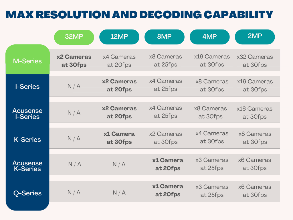

Maximum recording resolutions and decoding capability
Maximum recording resolution – this is the highest resolution that an NVR can support and store recordings from a camera in.Decoding capability – this refers to what an NVR is able to display at one time in either Live View or Playback. The more cameras you view at once, the lower the resolution that each camera can be viewed in will be. However, your cameras will always record in full resolution, so the “decoding capability” has no impact on your recorded footage.
As you can see from the table below, the new M-Series NVRs are the most futureproof as they can support up to 32MP cameras and display two cameras in this resolution simultaneously. Apart from the Q-Series, which only supports recording in 8MP, all of the other NVRs have the same maximum recording resolution of 12MP. However, the decoding capability is better in the I-Series ranges than in the K-Series.

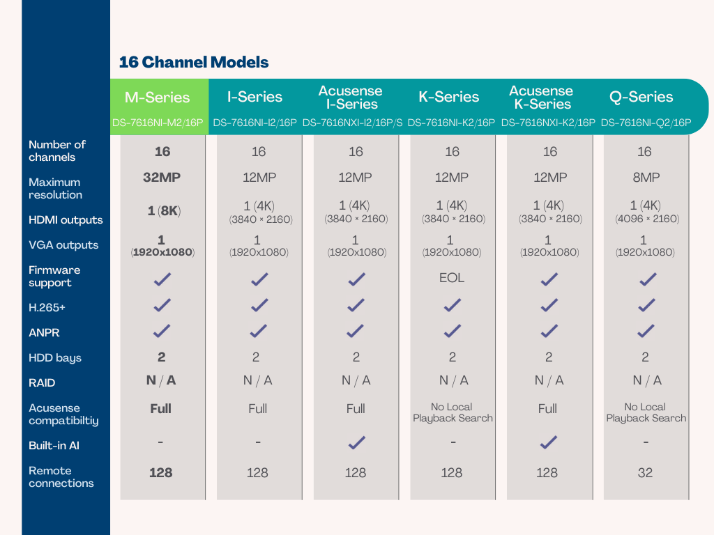

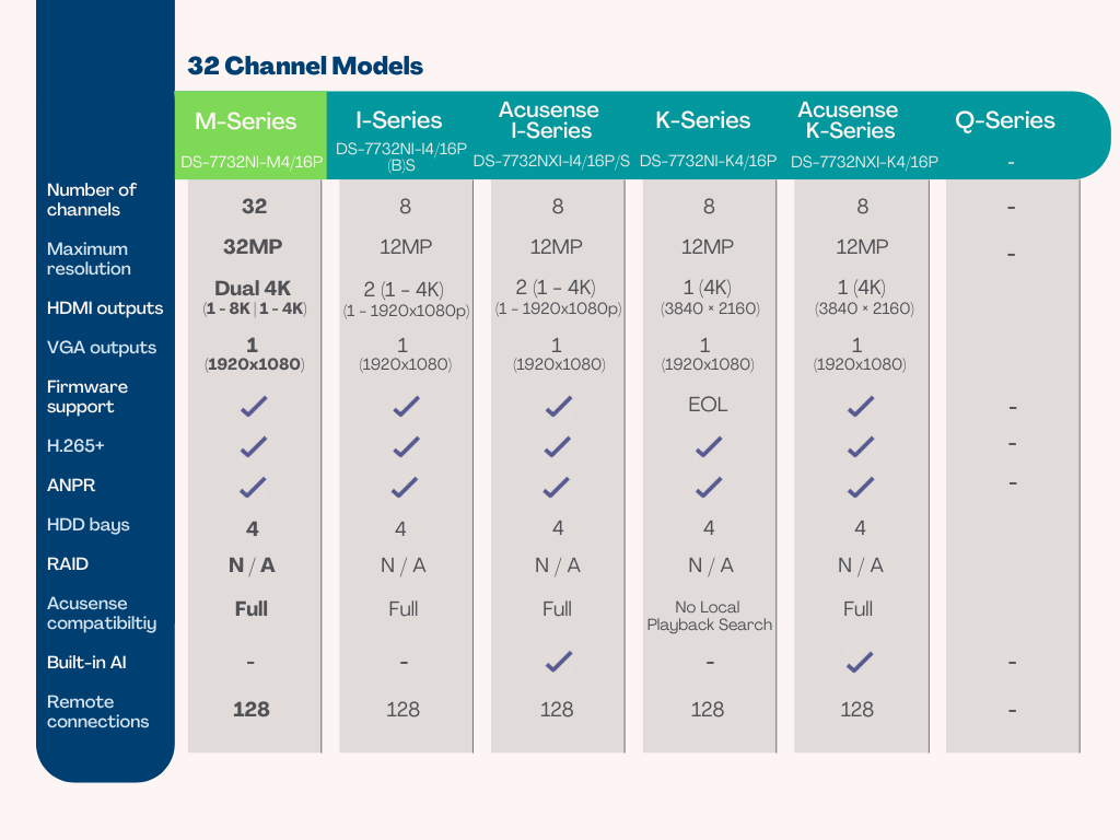

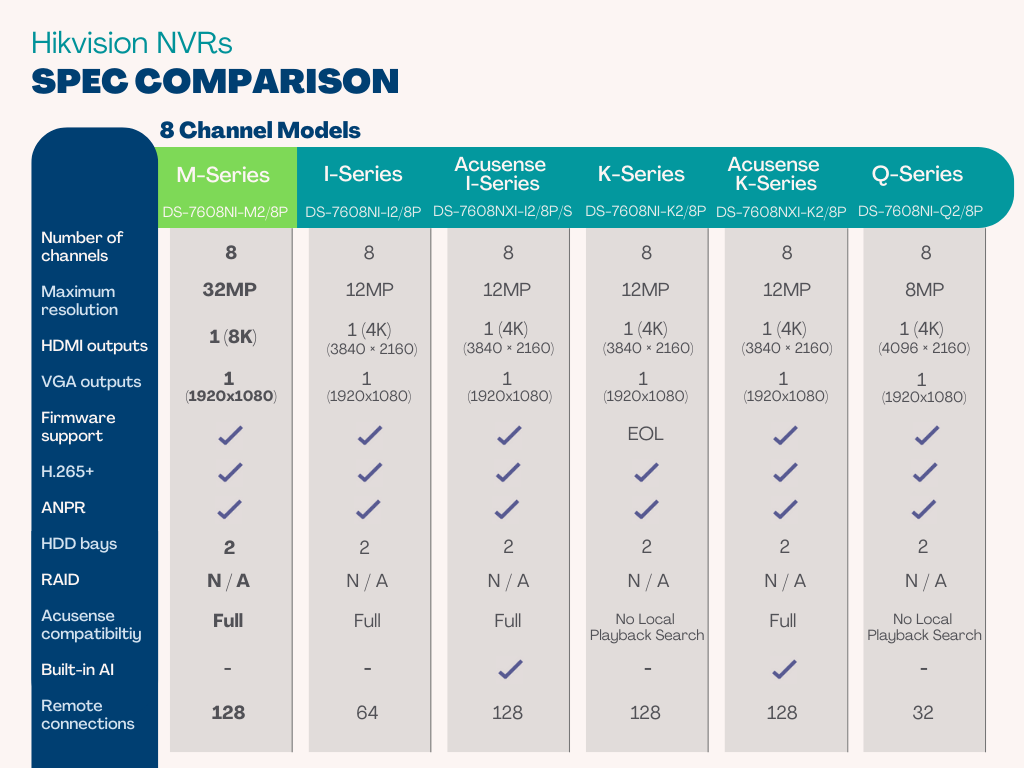

What other specifications should I consider?
The table below compares all of the other things that you may want to consider such as the resolution the NVR can display over HDMI, the number of hard drives supported, the number of devices that can connect to and view the NVR, if the firmware is still being released for it, and more:
