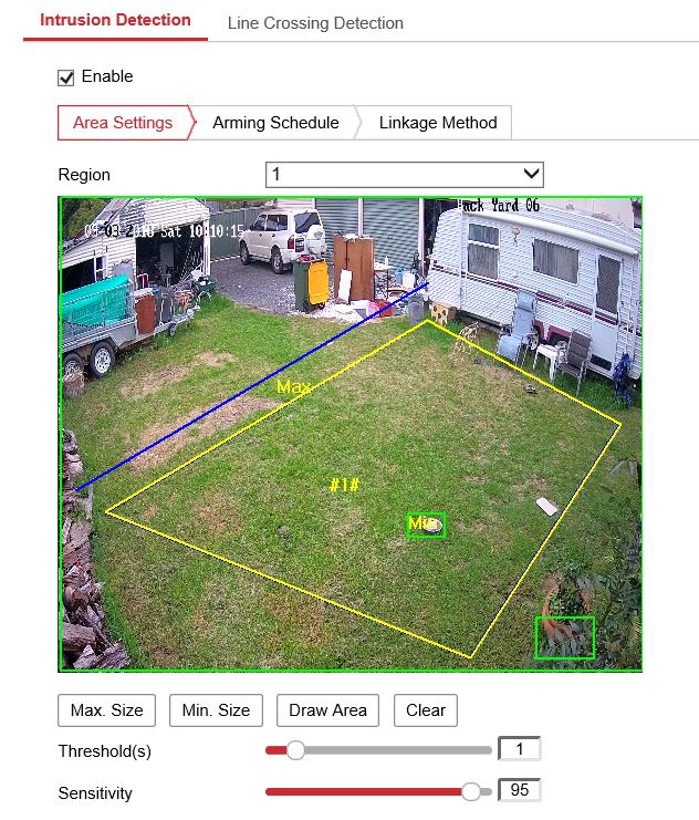

The Camera's interface...
Has the Max, Min settings...

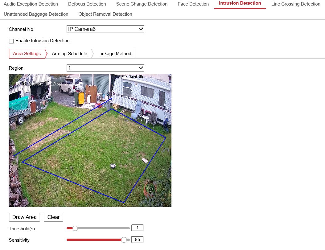

The NVR's interface which is more basic.
In this image it is showing the region set in that camera, after I cleared it's setting in the NVR.
Is this where "Dual VCA" comes into play?
Few things I wonder,
If it's only set at the camera end, does that lessen the CPU burden on the NVR?
Tried setting it in both places separately, but it's always the last region that is saved.
Docs & Tutorials don't seem to go too deeply into these two available options & their differences.
