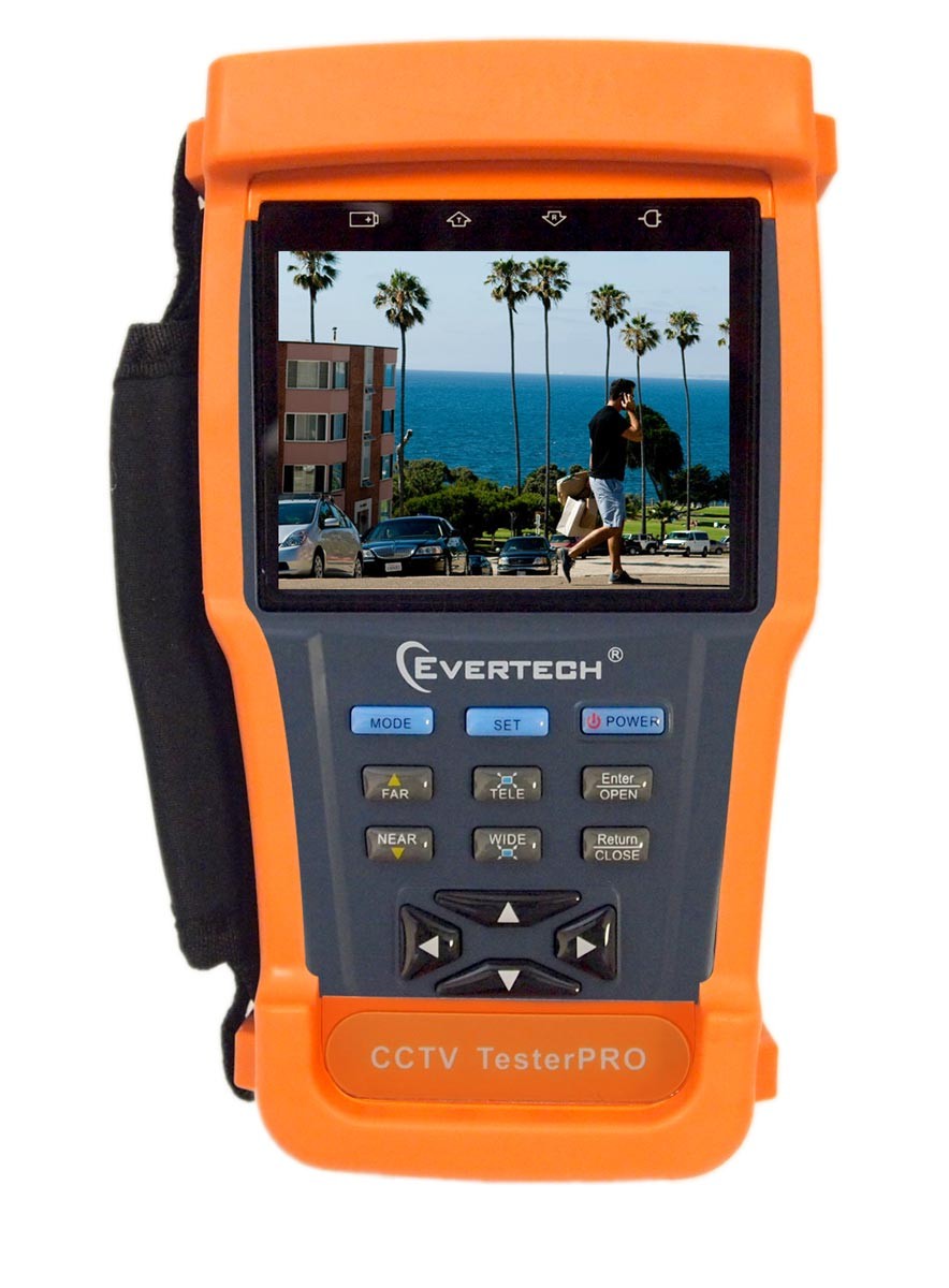

Everything you said is 100% correct but try hooking a AHD camera directly to a bnc or rca input of a normal tv and it won't work, I have a analogue Cctv tester and put a analogue camera on it and it'll work fine, put AHD camera to it and nothing shows up
