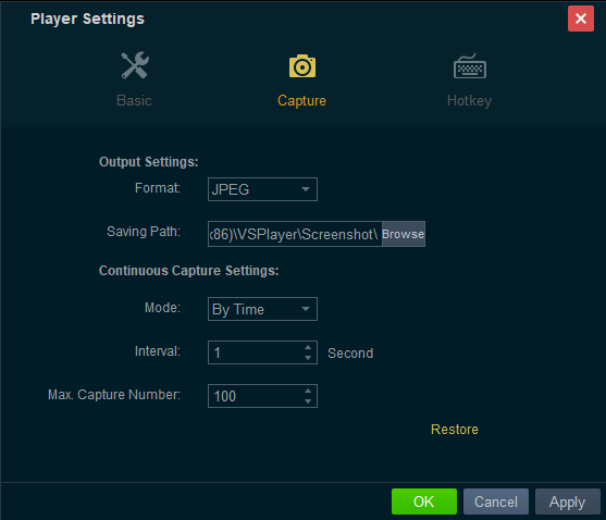

Main Menu (in the top-left hand corner) > Settings > Capture > Saving Path/Browse

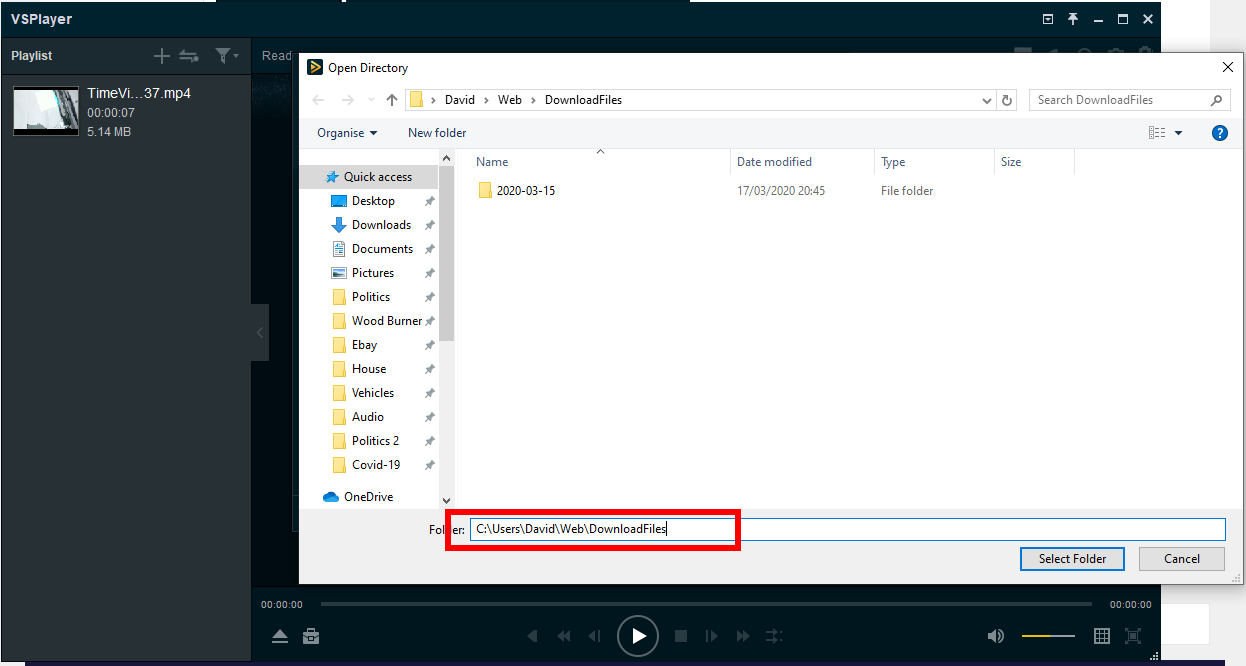

I did eventually find this setting however after setting the path to where I wanted it:

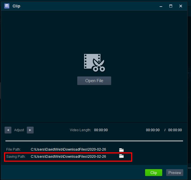

, it doesn't use this path when I want to clip:
I even tried running as administrator but the saving path is just stuck as this random location!!

The 2020-02-26 is a folder I have not created. When I installed VSPlayer, it took it upon itself to use this a default location and if I delete it and then start VSPlayer or use the clip tool, this folder gets created.
The latest version is v7.4.1 and this is the version I am using.
